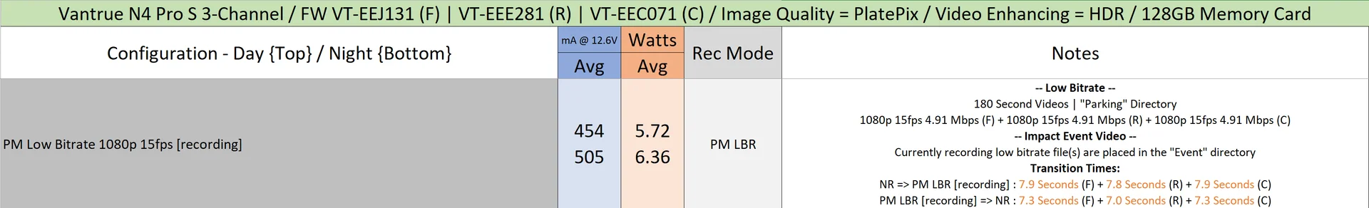

I recently completed my power consumption testing for the N4 Pro S. You can only select one parking mode type at a time. I did find that when low bitrate parking mode was enabled, the dash camera firmware would move the currently recording low bitrate video file to the "Event" directory when an impact event was detected.

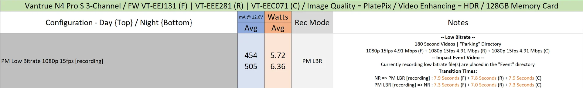

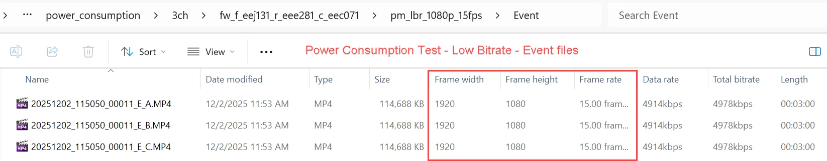

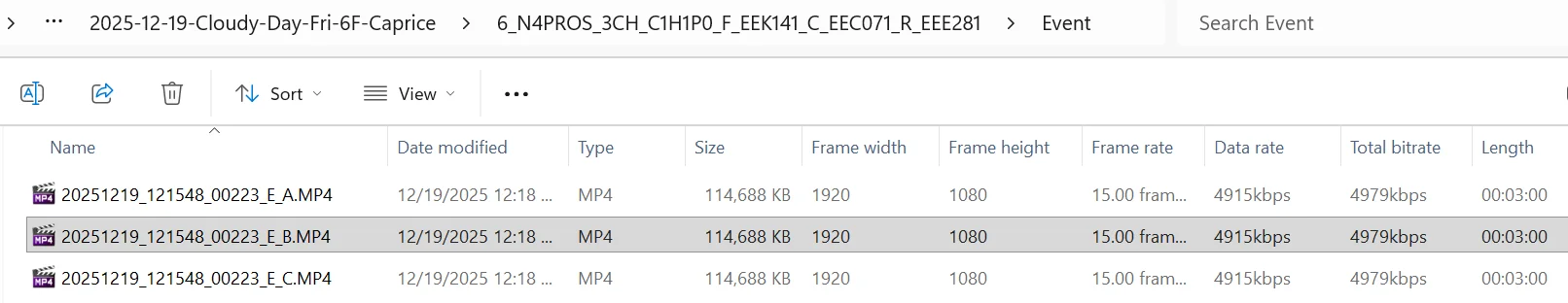

I reviewed my power consumption test video files created during the low bitrate parking mode test. I confirmed the low bitrate parking videos that were recording when I strongly "tapped" the stand the N4 Pro S front camera was mounted on were moved the "Event" directory [A,B,C files].

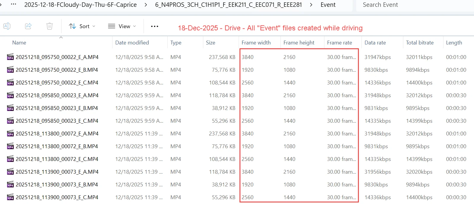

Yesterday, I drove my car with the N4 Pro S dash camera. The "Event" files from that date are only from while I was driving, not parked in low bitrate parking mode. The five other dash cameras in the car detected parking mode impact events when I closed my driver side front door, but not the N4 Pro S. There's no sensitivity setting for impacts when you configure the low bitrate parking mode, so I'm not sure how to address the N4 Pro S not detecting impacts in real world impact situations. I just reviewed all of the "Record" settings. There's no specific setting for impact detection in parking mode except when you select "Collision Detection" parking mode. I'll ask my Vantrue contact for more info on this topic.

Based on our testing, it would seem those "maximum" settings are not sensitive enough for typical impacts in those three parking modes. It does appear that a very strong impact [see my power consumption parking mode test screenshot above] while in low bitrate parking mode will result in those videos being placed in the "Event" directory. It will detect impacts in that parking mode, but it seems to take a lot more force than one would expect.

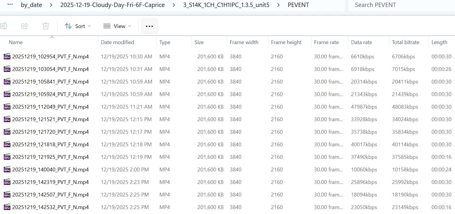

Comparing to the VUEROID S1-4K 1-channel dash camera in that same car, there were far more events detected by that dash camera. The S1-4K's parking mode is "Impact & Time-Lapse".

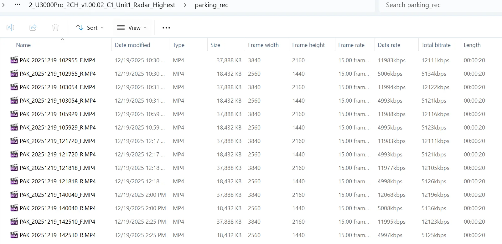

Comparing to the Thinkware U3000 Pro 2-channel configured for "Radar" parking mode:
The radar detected motion event recording files are placed in the "motion_timelapse_rec" directory. Only the impact events are created as "PAK" files in the "parking_rec" directory.

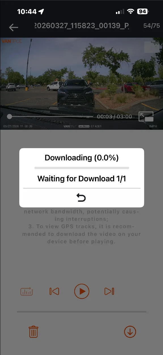

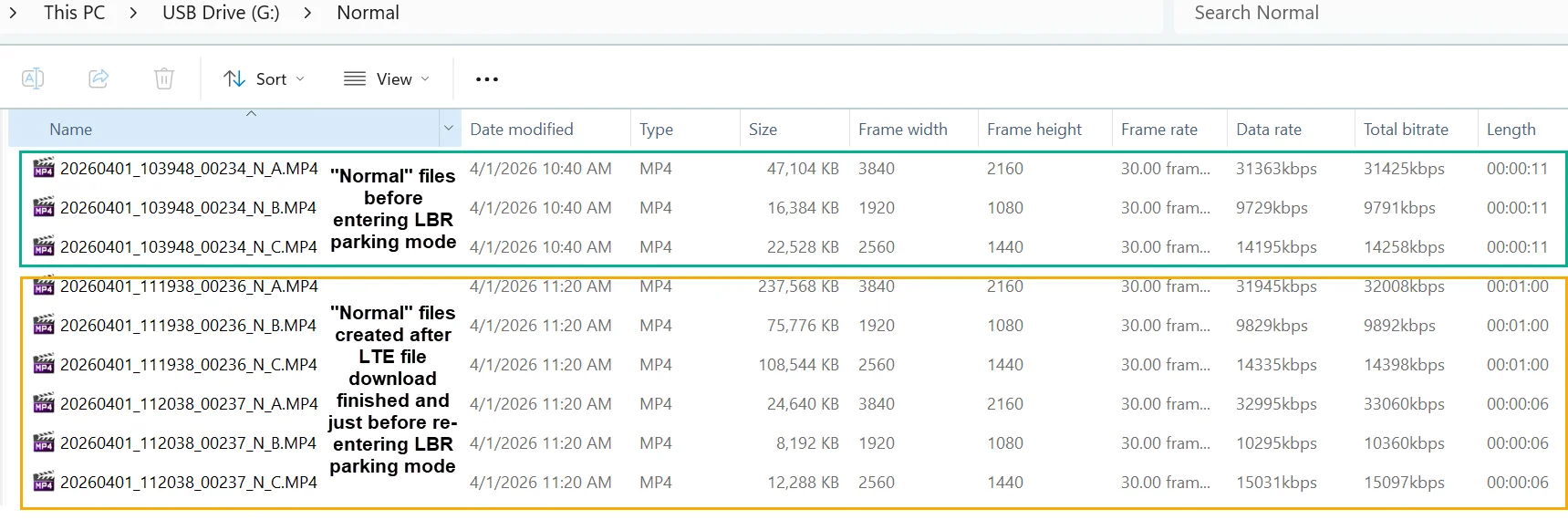

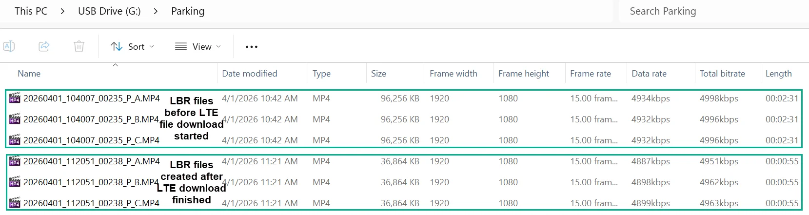

I installed a Vantrue LTE module into my car and paired it with the N4 Pro S dash camera in that car. I had the N4 Pro S already configured for Low Bitrate 1080p 15 fps parking mode. Front camera firmware is EFA301.

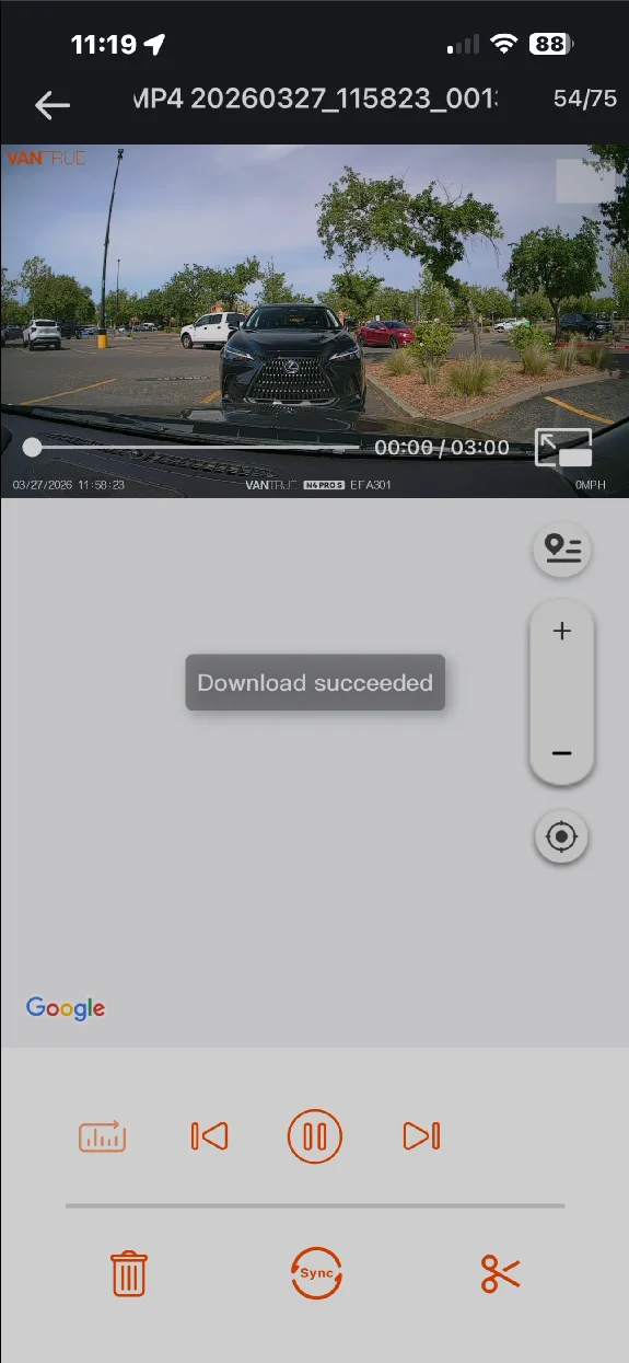

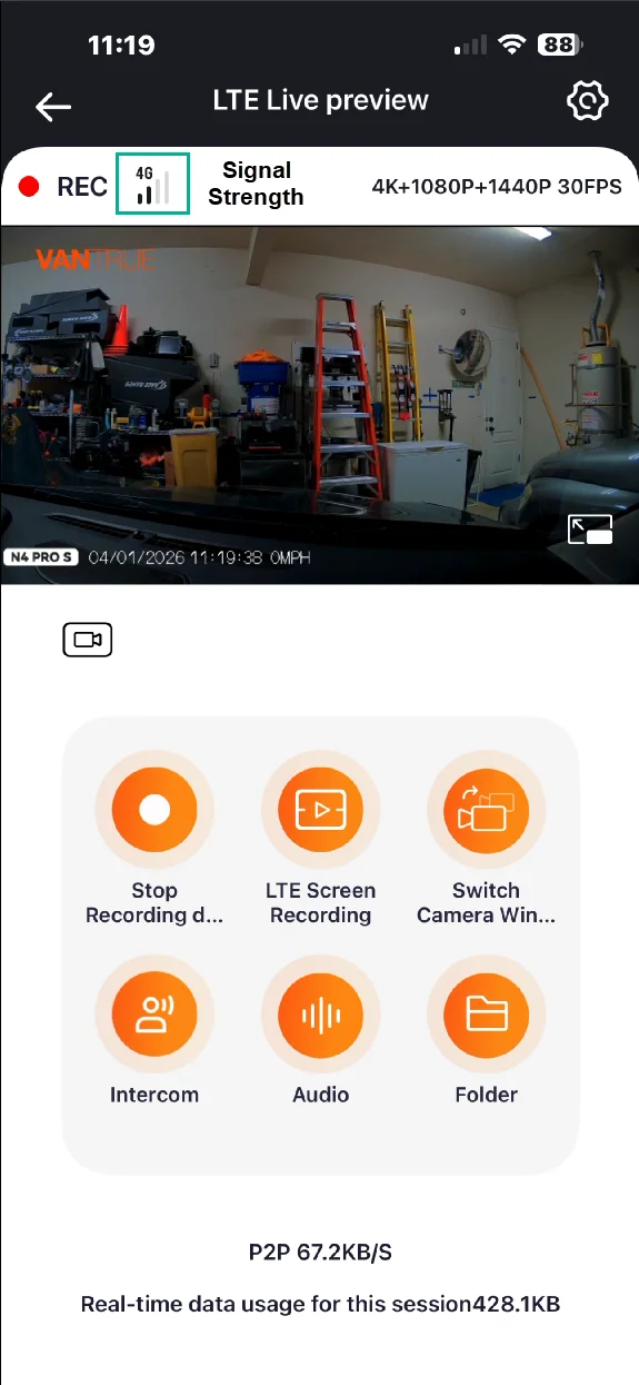

I was able to successfully download a low bitrate parking mode file [112 MB] over the LTE connection, but it took a very long time [35 minutes]. The transfer speed was an abysmal 0.053 MB/second. The Vantrue LTE module showed a signal strength of 2 [Green LEDs on LTE module or bars in the Vantrue app]. I'll have to try and find a location where the signal strength is 4 bars to see how much the signal strength impacted the transfer rate [upstream bandwidth from the LTE module to the LTE network]. My phone was connected to the internet via a high speed Wi-Fi connection. My phone had plenty of downstream network bandwidth to download the file quickly.
Downloading the video file results in the N4 Pro S exiting low bitrate parking mode [pausing all recording] to handle the download of the video file. During the 35 minutes the video file was being transferred to my phone, the N4 Pro S was not recording anything. When the download finished, the N4 Pro S resumed normal recording mode for a short time and then it re-entered low bitrate parking mode again.
Download of video file started at 10:44 and finished at 11:19:
Parking mode low bitrate files showing the time gap between recording files while downloading the file over the LTE connection
