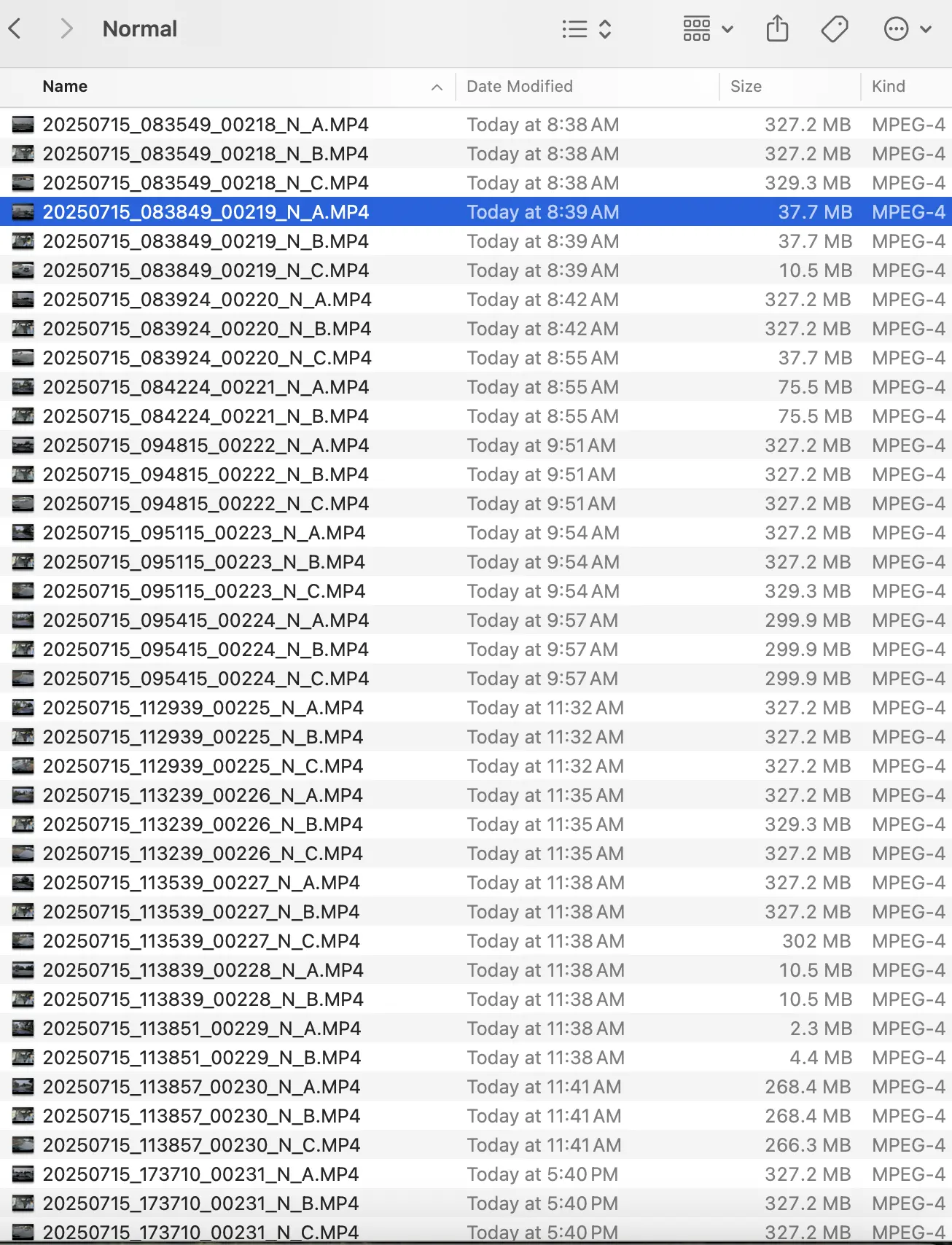

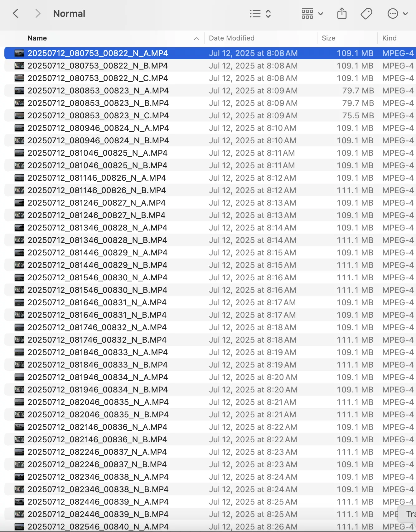

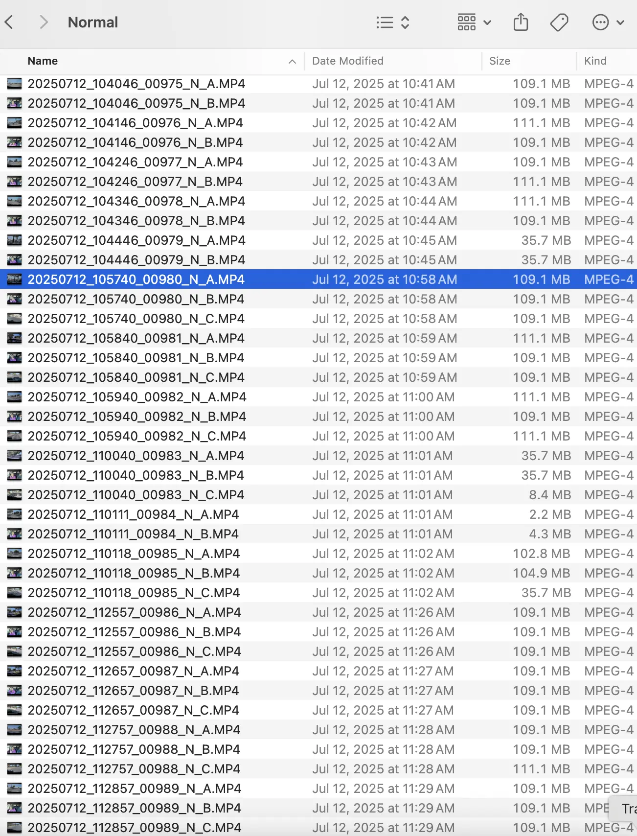

I thought I noticed the dashcam switching which cameras are recording all by itself, too, but I wasn’t sure, so I haven’t posted anything about this yet. I wanted to be more methodical abut my testing first. I didn’t connect the change in which cameras are recording to the file dropout…. This would seem to indicate something might be causing the dashcam to reset itself somehow.Strangest thing is... this morning I set to record front + rear only... almost to work at ~8:19am, it stopped recording and switched back to 3 channel (front + interior + rear).
1 minute loops.
This is a tuff one. You probably only noticed it because you were dutifully scanning your SD card files. On Viofo dashcams, there is an alert "Recording, 'X' Channel started" when the camera glitches during an interrupted loop. There is still a gap in the recording, but at least you know there is a problem. I just had this happen on my A229 Pro last week, there was a random 2 second long recording and then I got the message alert before the next full 3 minute loop started.@jsmith

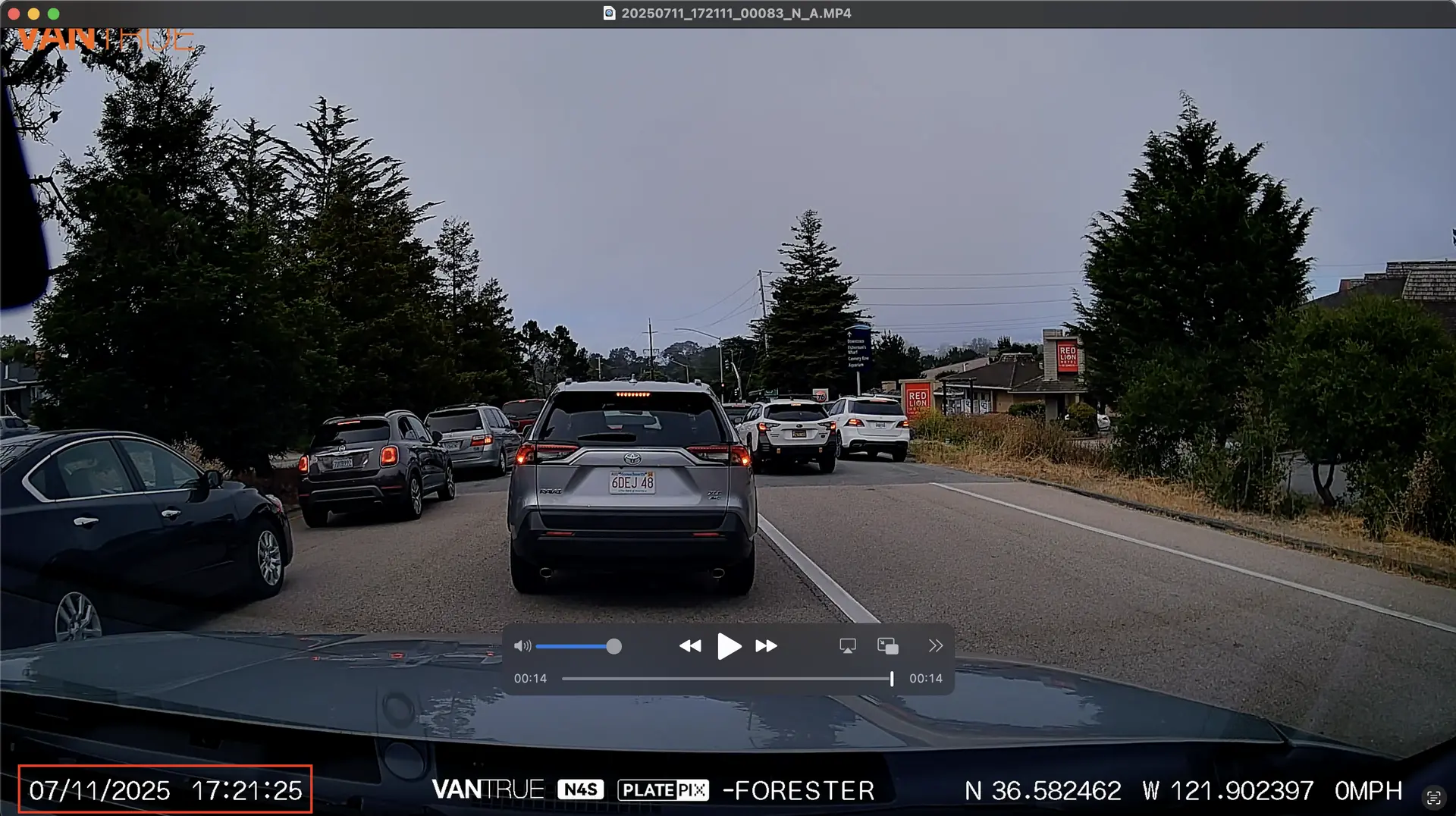

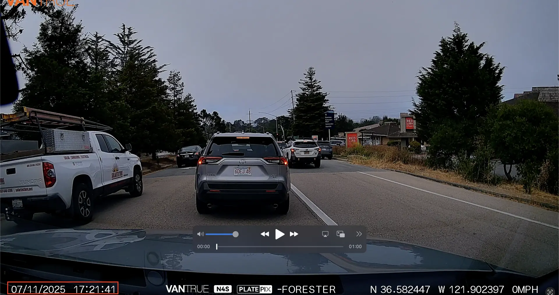

Here's a screenshot from 5:21pm -> 5:22pm from the front camera.
5:21pm clip ended early at only 14 seconds - timestamp 17:21:25
Next clip 5:22pm file - timestamp 17:21:41 - missed 16 seconds of recording

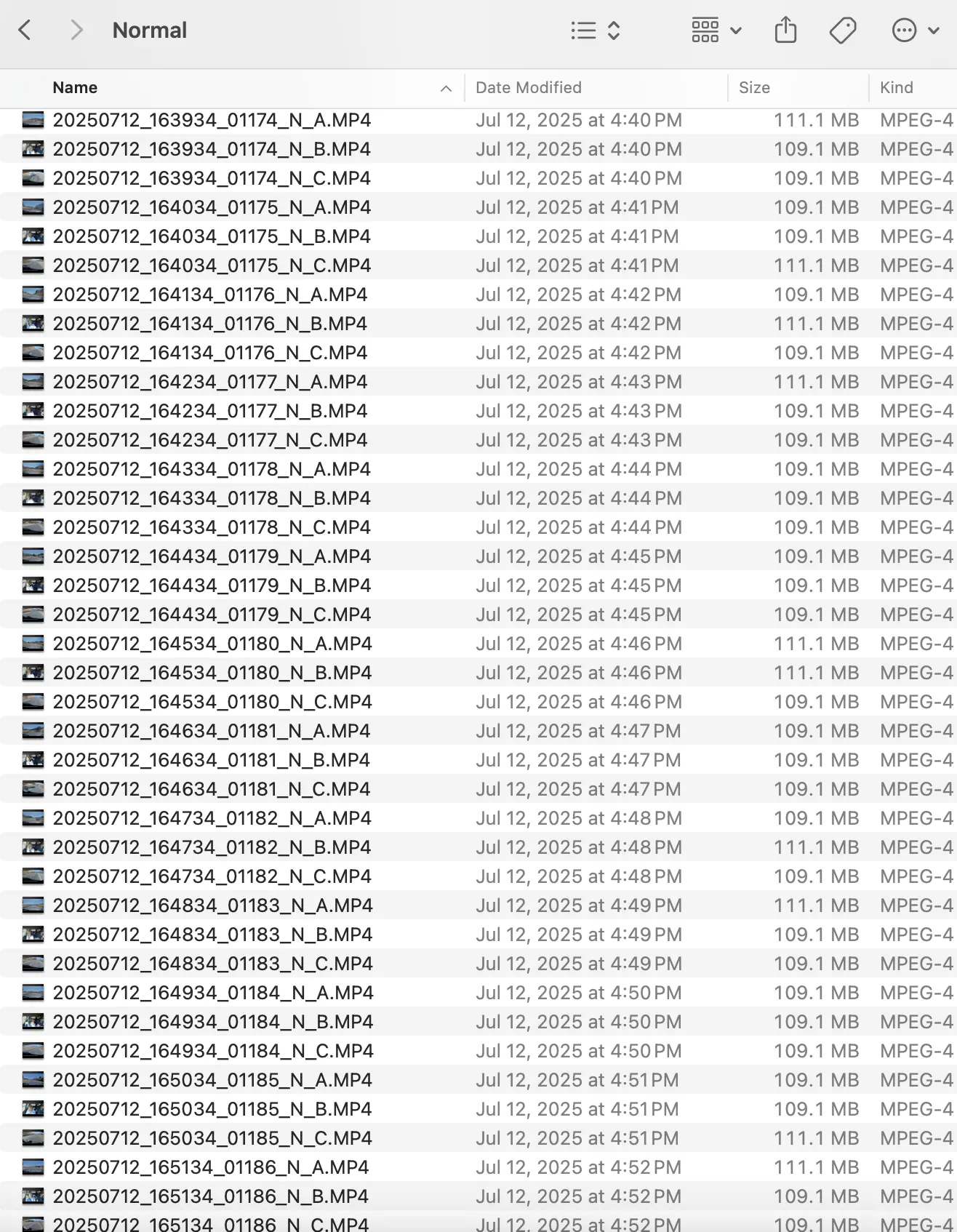

Are you recording on all three channels?So I've run the Vantrue N4S for 3 days now on a 128GB Vantrue SD card with 3 Minute Loop Recording. I am not finding irregular file sizes or gaps after 3 days. I'll continue the test longer and see what happens.
I wonder if this is a heat related issue or a memory card problem?
I've had my N4S set to 3min loops from the start. Still seeing drop outs. New rear camera is on the way, so I'm hoping that resolves the issue.
