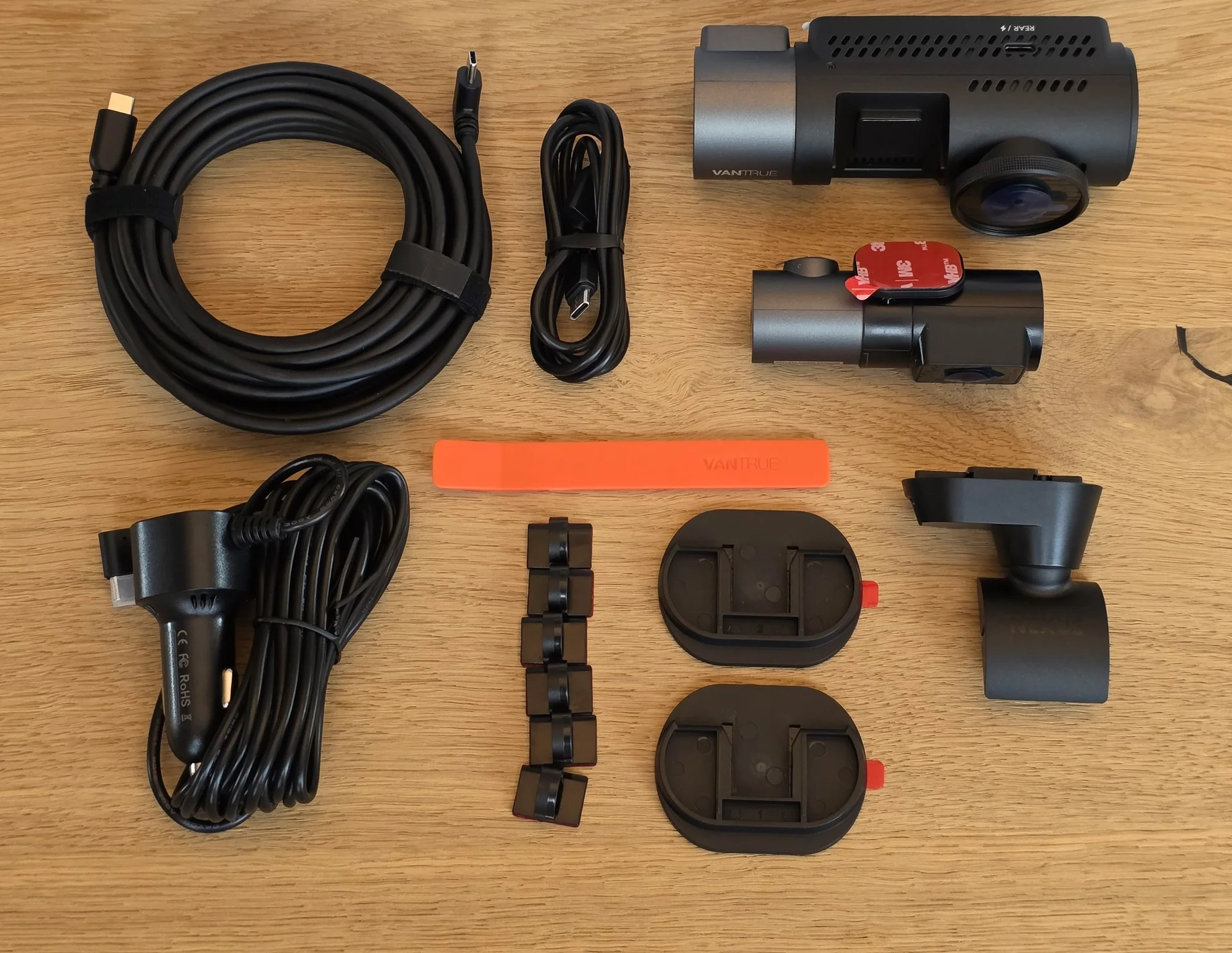

The N5S arrived neatly packaged. Inside the box, I found the main front/cabin camera and the rear/rear cabin camera, with a 20 ft cable, an 11.5 ft power cable, adhesive GPS mounts, a user guide, and cable clips. Build quality feels solid, the housing is robust plastic (no squeaks or rattles). The sliding bracket clicks firmly onto the mount, and the dashcam doesn’t feel loose. The cables are thick and well-insulated. Overall, the kit looks like a thoughtfully built 4-channel camera system. The front unit is on the bigger side. But depending on the mounting location, it will neatly hide behind the mirror. The optional suction cup mount does offer some additional angles.

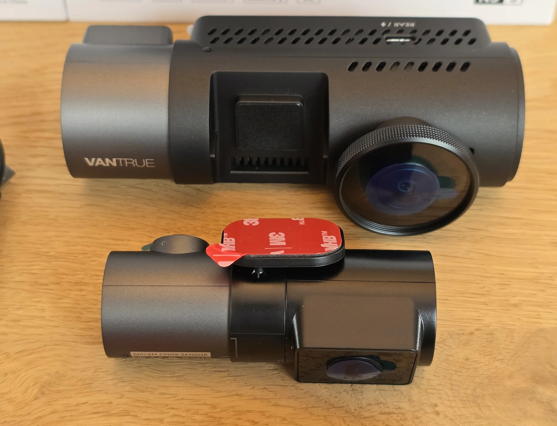

There is one issue that I want to address. It has to do with the current design of the rear camera.
It does not allow enough up/down movement to mount it on the headliner or any other horizontal surface that isn't angled like a rear window.
The rear camera can't be aimed further down. Only up. Meanwhile, the rear cabin camera can't be aimed any further up if mounted on a horizontal surface.
Just for clarification, the camera will work just fine if it's mounted to the rear window.
This issue will likely only occur to a handful of people. But even then, it's worth reporting.

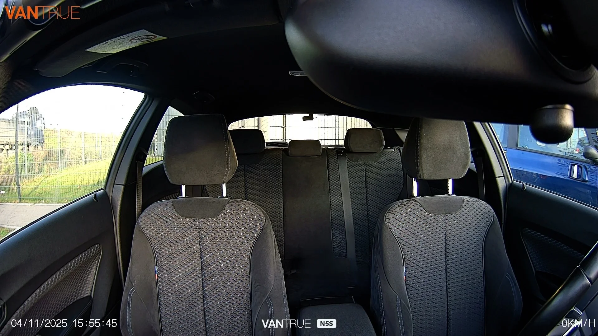

The front camera delivers excellent clarity and detail in 2K resolution with natural colors and good dynamic range. Plate capture is good at city and highway speeds. The cabin camera provides very good detail with a wide FOV that captures the entire interior. The front cabin camera is very good and sharp. It might be one of the sharpest interior cameras I've seen yet. The rear cabin camera faces forward and also has great detail. Video transitions between bright and dark areas are smooth, without noticeable overexposure.

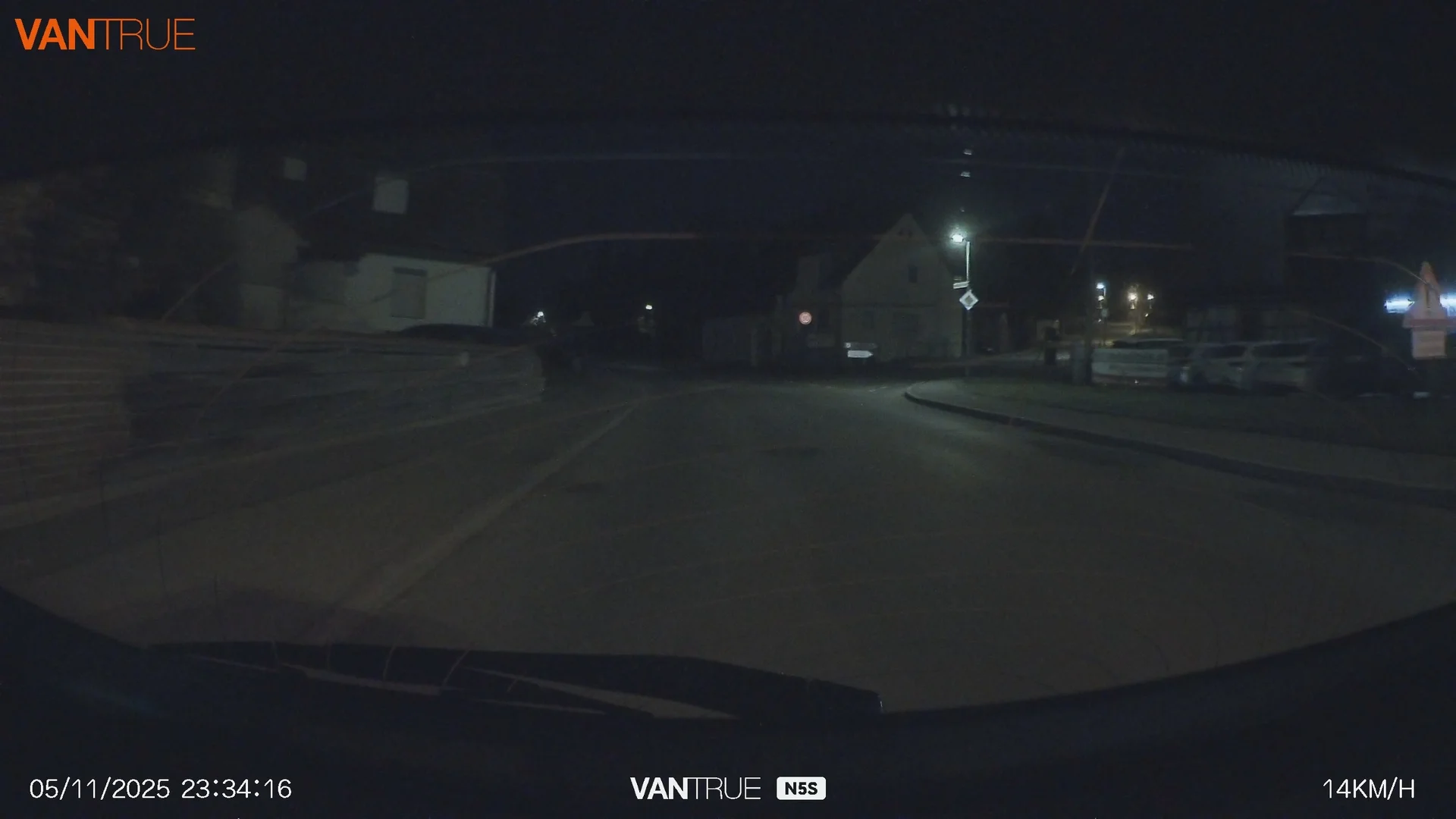

Night performance from the front camera is decent to see what's happening in low light conditions, showing minimal noise thanks to the IMX675 sensor. Since it only has WDR and no HDR, plate capture is nearly impossible. The cabin camera's IR LEDs work very well, providing a clear view of the cabin in pitch black, with facial details visible. The rear camera has HDR and is able to decently capture the action.
