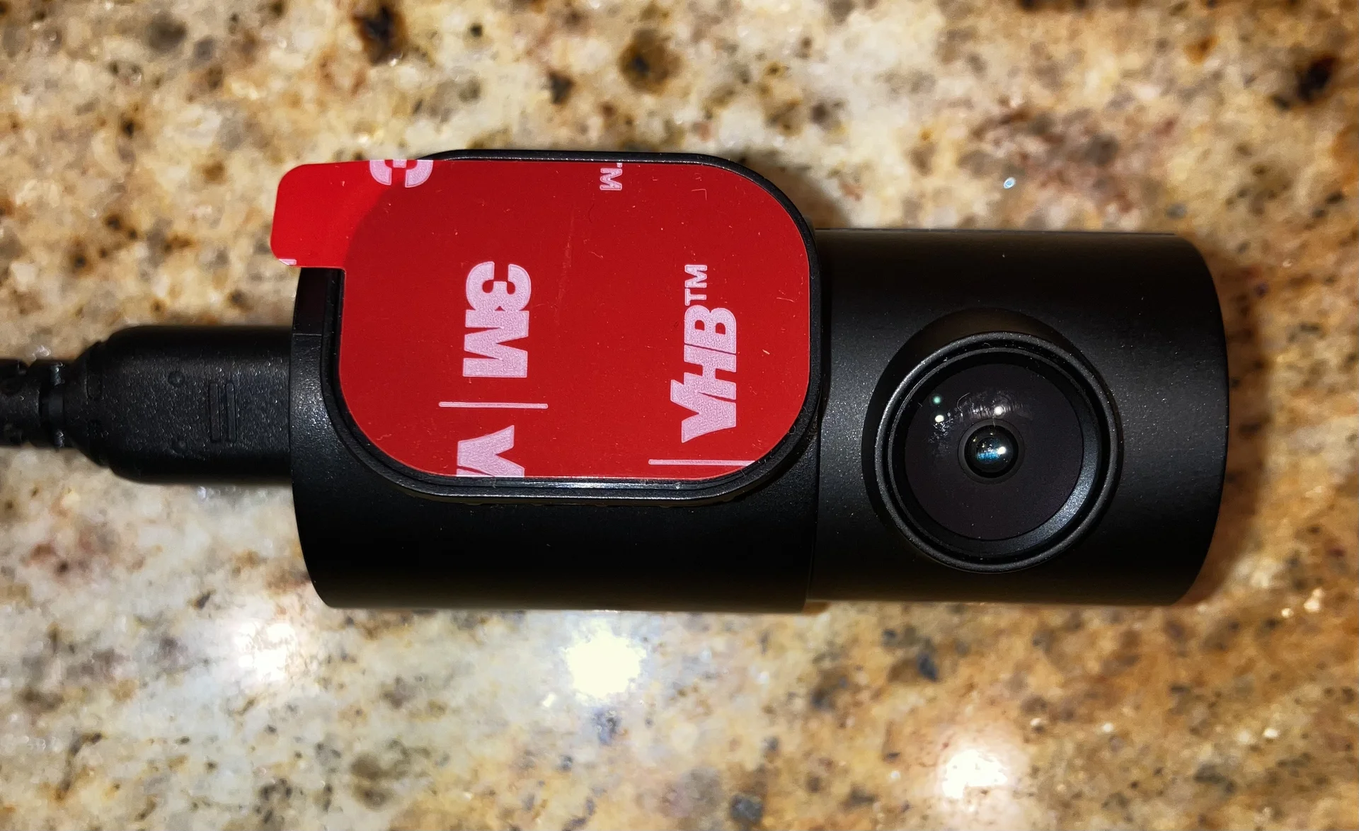

How come you cant slice the adhesive pad to the size of the metal frame if too large, and simply mount the camera on the metal frame itself? I tshould work just fine?
I have at times had cameras glued in places, where just a fraction of the sticky pad was in engagement.
Most memorable the Innovv C3 camera i at a time had mounted to the back side of the R side B pillar in the red car, it even got dinged a few times so it was out of alignment but it never came off even if it was glued to the rounded plastic trim on the B pillar.
That freaked me a bit CUZ otherwise mounting off interior plastic trim is often doomed to fail and another type of sticky pad needed that work better with plastic.
@Hack_man
The rear camera lens and adhesive pad line up, even when the lens is adjusted downwards. I would have to do as you and @kamkar suggested and mount using only a fraction of the pad, and even then I'm not sure the angle would work. I could install a simple large extension plate onto the camera's adhesive pad and mount the upper half of the plate to the window's metal frame. This would drop the lens down low enough beneath the metal frame. I suppose that's worth a try but I do use that window sometimes where the camera would get in the way.

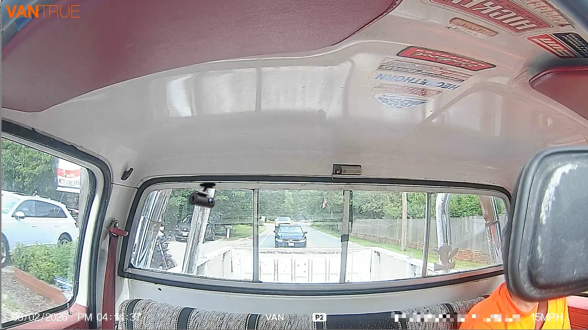

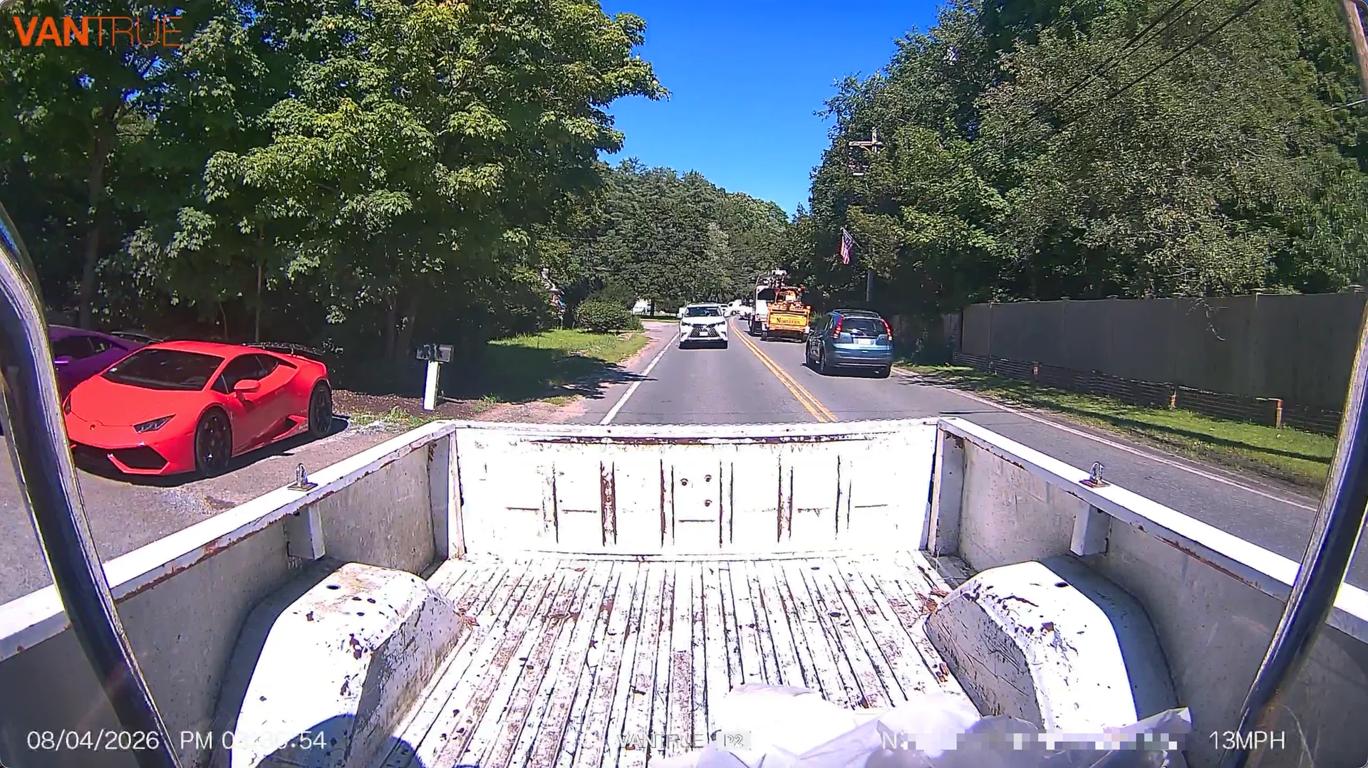

I decided to mount the rear camera directly on the slider window and it worked out pretty well. There is sufficient service loop when the slider window is opened and this way the camera is always protected in case the window is open from rain or snow.
Rear camera view.

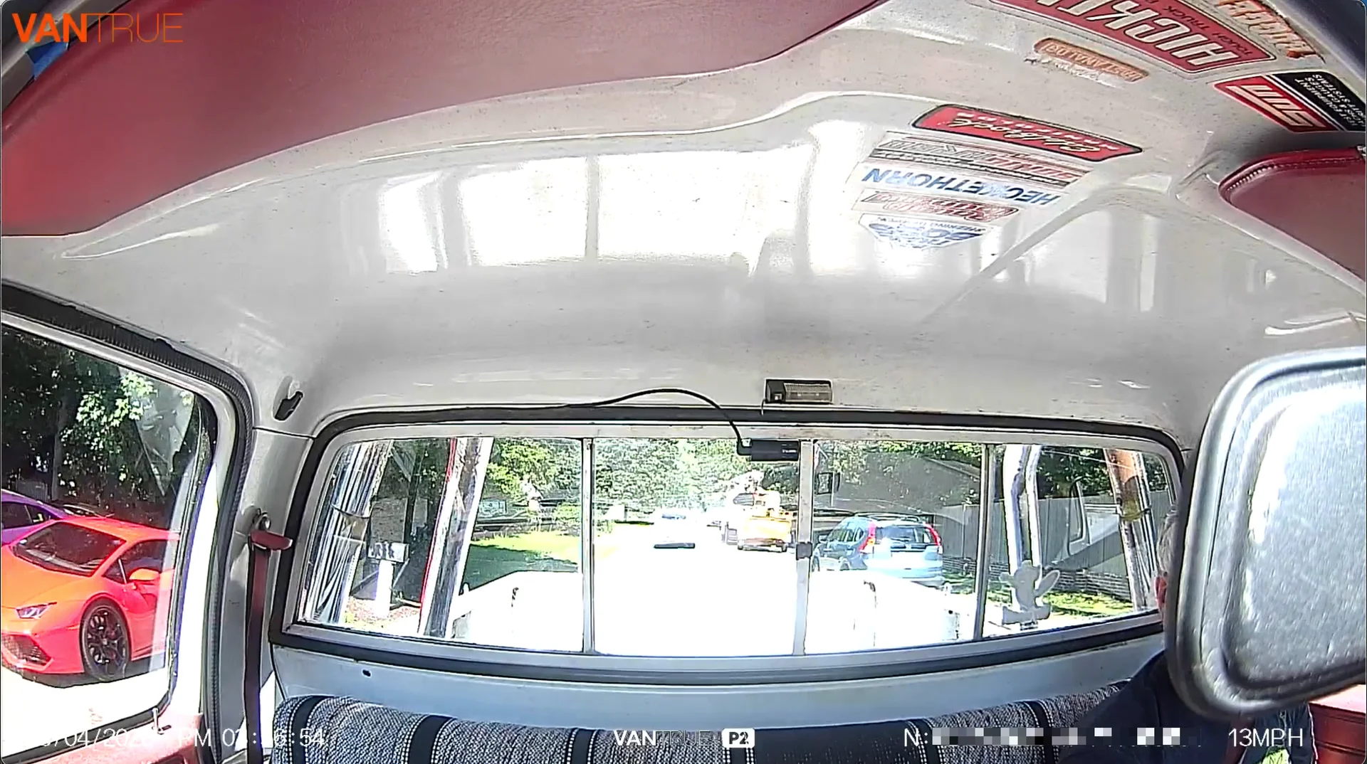

I am a firm believer in the need for a rear camera. I recently captured video of an accident behind me which was used to support a police investigation. The more data the better!
Cabin camera at the same exact instant. The outside view is over exposed but inside the cabin looks good. Notice where the rear camera was mounted.
I'm glad I have the rear camera since it does a much better job outside the truck under these lighting conditions. The cabin camera does provide some nice passenger side footage.

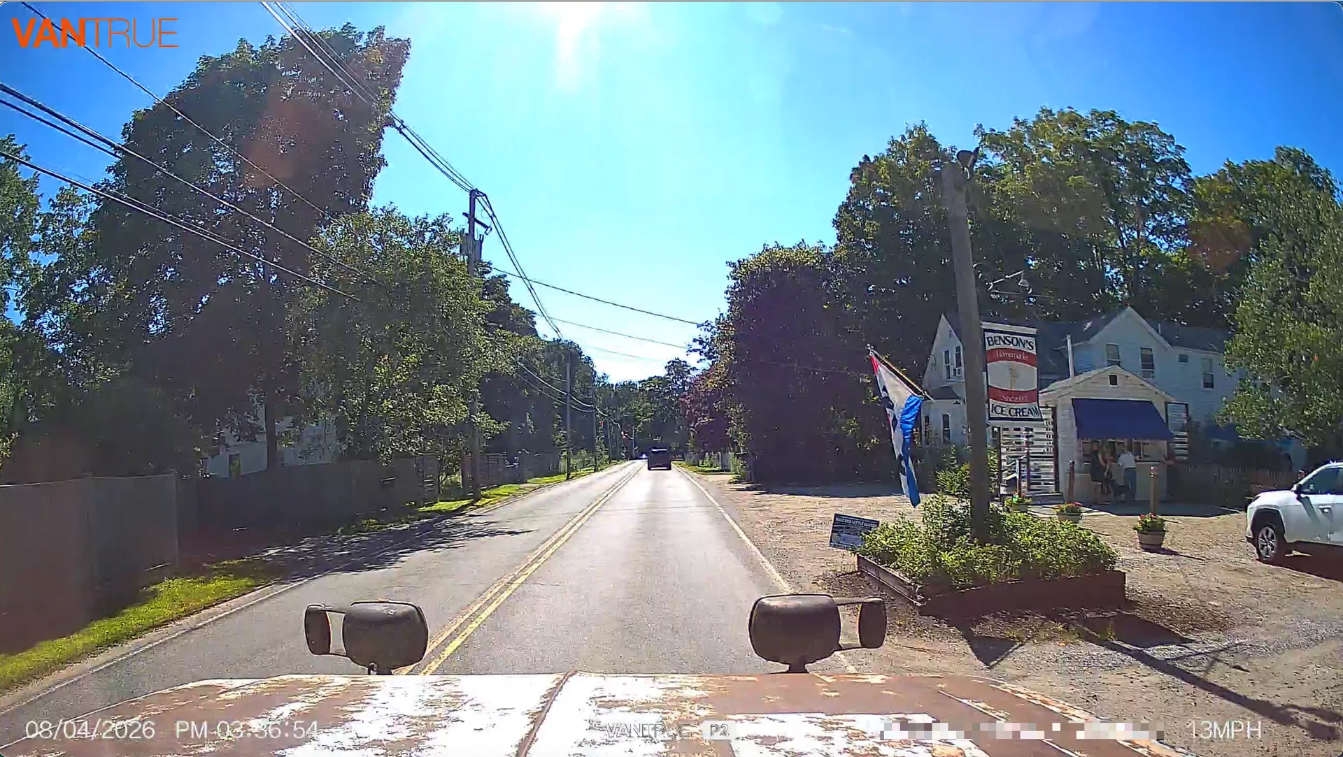

Front Camera

Very easy solution which I do to my Vantrue Rear Cameras:
Purchase a VIOFO CPL-300. Take 2 small pieces of 3M VHB and apply it to the rear Vantrue Cameras. I do this to their cameras and it works perfectly. It helps a lot given I have tinted windows.

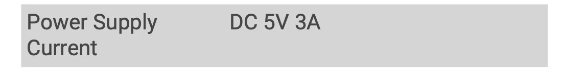

I was curious to measure the current draw for the P2 in a hot vehicle since heat can be a worse case environment.
I measured the current using a USB-C Tester with the P2 setup with all four channels (front, rear, cabin, thermal). The SD card is 128 MB, normal driving mode with highest resolution settings.
According to the P2 User manual, it's Power Supply (CLA, Cig. lighter adapter) specification is 5V 3A but I was supplied with a 5V 2.5A VP05 (II) Hardwire Kit rather than the newer VP05 (II) rated for 2800 mA.
The Hardwire kit is used when the user wants to implement parking mode, whereas the CLA does not support parking mode.
P2 User Manual for the CLA adapter:
I found a reference on Vantrue's website that indicated the operating current for the P2 is up to 2850 mA which is greater than the VP05 (II) is specified to provide:
Looks like a typo in the website where it says 2850mA/h
The inside vehicle temperature was 101.5 °F (38.6 °C)
I measured a peak current of 2.25 A
The current fluctuated but the average was closer to 2.0 A
Based on these measurements it appears the VP05 (II) should work but the operating requirements of the P2 (for current) do not line up with the output specification of the VP05 (II).
