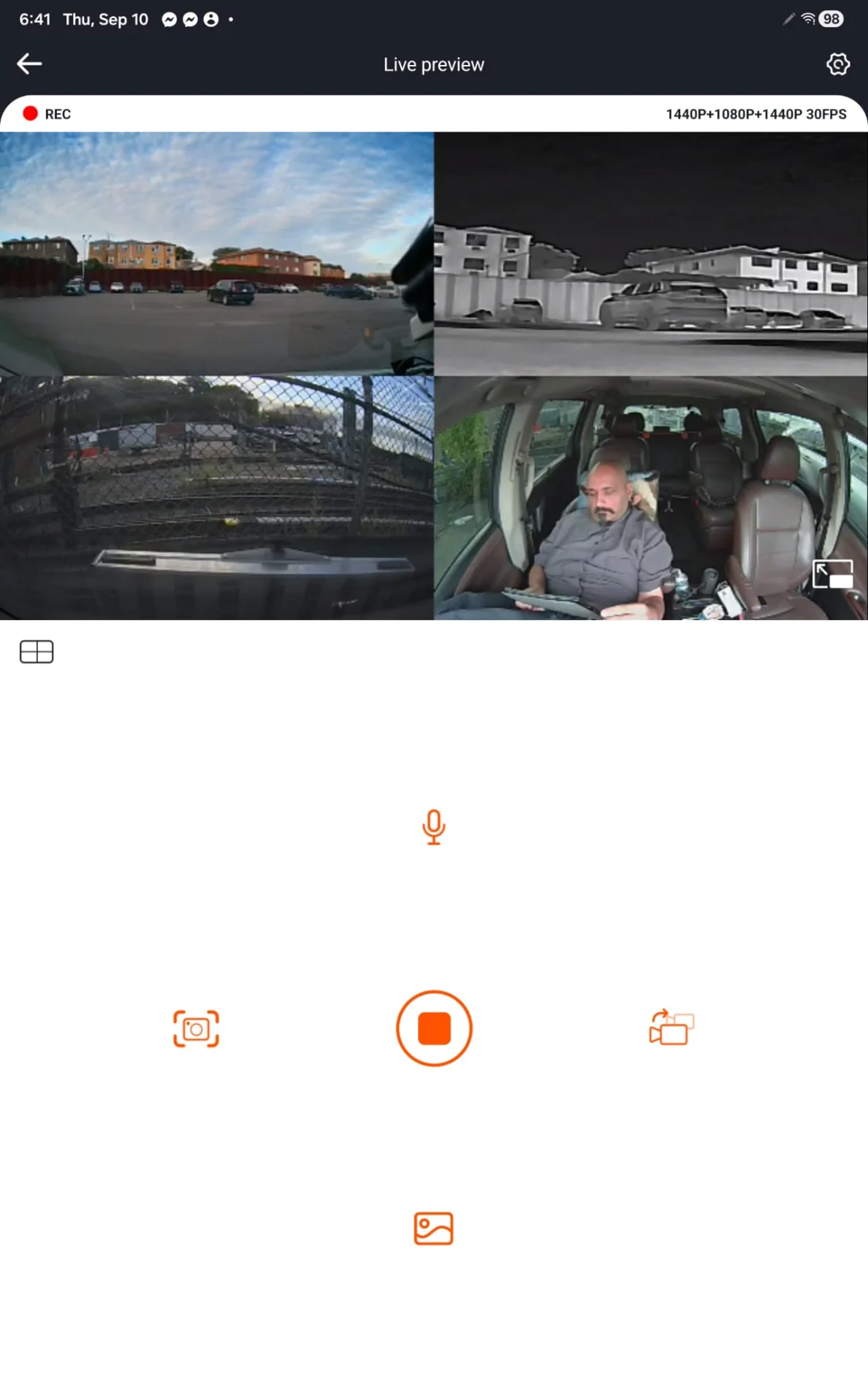

Question:
I only recently got around to installing the thermal camera (had to relocate a few of my other dashcams)
I see them thermal tracking boxes on the screen in real time along with the object distance, but when I transfer the actual files to my tablet or laptop, it just plays the raw files (no green/red tracking boxes)
Even if I open the files on the Vantrue Viewer program (Windows), it still only shows the raw thermal file.
How do I get it to show the tracking boxes on the recorded files so I can edit the footage to show them?

Not supported. I inquired about that one originally and was told the hardware is incapable of handling that feature.

That was my complaint, too. However, wendy told me the hardware was incapable of generating the boxes on the video itself.
Here's a clip from last night
It's a shame we can't show the meta data for the thermal cam as it would actually go a long way for advertising the live tracking
