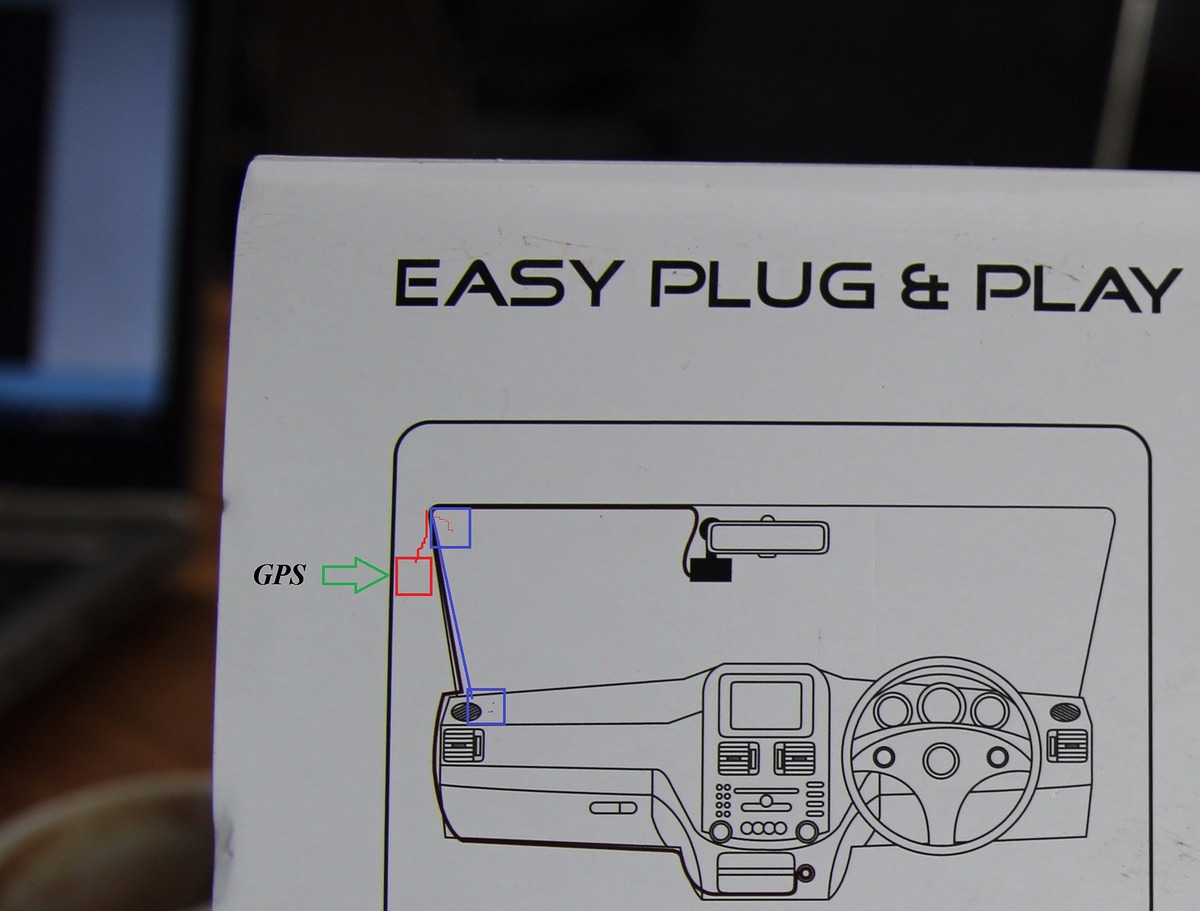

Having the GPS in the power cable seems like it could present an installation headache in many situations. I know it would in my vehicle because it would make it hard to run the cable.
I would speculate that the GPS module in the cable might even cause reception issues depending upon where and what angle it ends up in during installation.
Signal doesn't seem to suffer too much, installation is a hassle though
I'm wondering what might happen if all or part of the GPS module ends up behind metal along a roof line or A pillar or something to that effect. Seems like a potential issue to me, or at the least, not optimal.
in my country, car worker alway install GPS behind the A pillar. Stick GPS module into metal of A pillar. GPS signal seems pretty good although it's surpose hardly to catch GPS signal because of Faraday cage effect.
And my ideal is not ready GPS module in GPS cable but is sonething like this:
@jokiin Is this too hard for customer to install ?
- only one input into camera. (mircoUSB or miniUSB)
- in the intersection, has 3.5 audio input.
----------> simply: Move to conection of GPS input from the camera into somewhere more reasonable. And from camera itself, there is only one wire ---> more discreet
Cons: have to product wire individual. Made cost of product increase

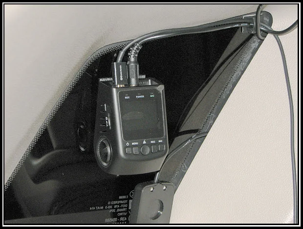

It's possible but I was pleasantly surprised when I installed a couple of A118C's as side cams. They're located in the quarter panel windows behind the rear doors, vertical and under the metal roof - GPS unit on the right side is located in the upper right corner. Signal acquisition is slower than for the GC's mounted front and rear (sometimes as long as 4 minutes) but given my primary reason for having the GPS is clock synchronization that's not a major issue. (Ignore the cable mess - out of sight, out of mind.)
Pleased to hear that it worked for your. I would still venture a guess that it could be problematic depending on the quirks of each car and the required installation involved. In your case you seem to have ended up with reasonably good glass contact and a slightly upturned angle of the GPS module. I suspect that success may also be dependent on the particular GPS module depending upon which camera you've got.
I'm pretty happy with the separately wired GPS module on my SG9665GC which is mounted directly on my dash board tucked off in the right hand corner and hidden under my dash mat. It's as if it isn't even there.

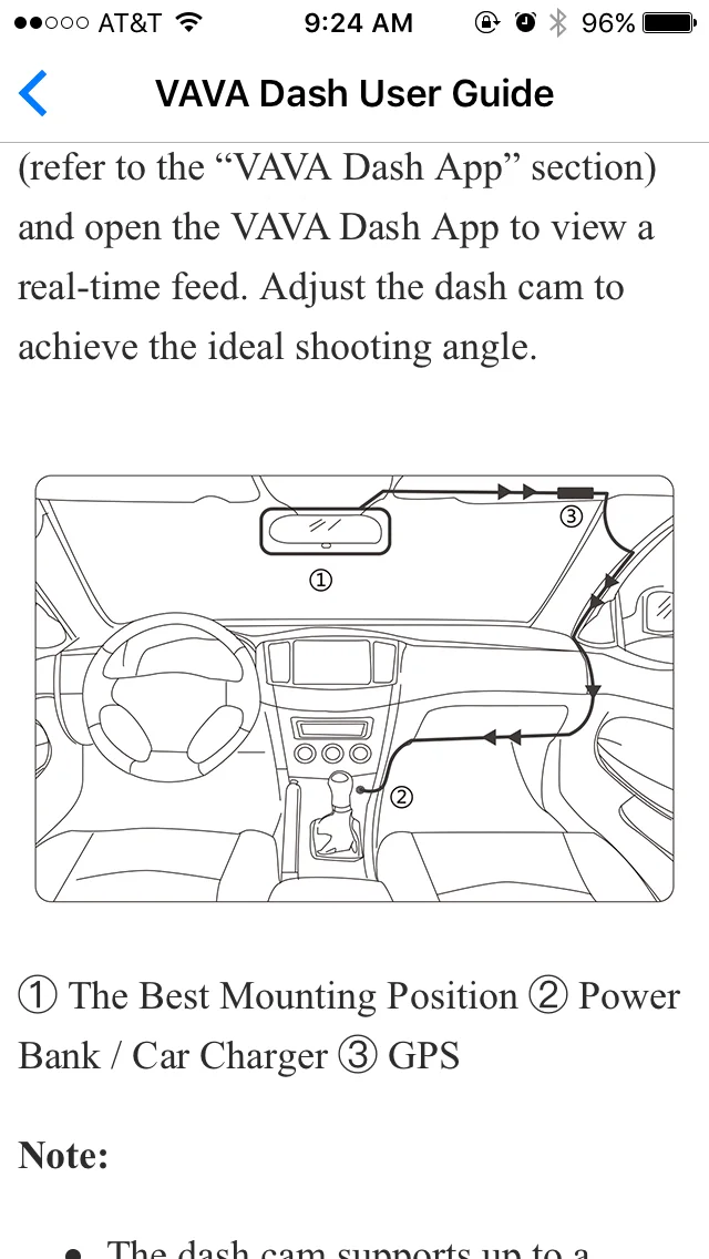

I think VAVA wants you to mount the GPS unit on the top part of the windshield, near the A-pillar when hardwiring/installing it.
