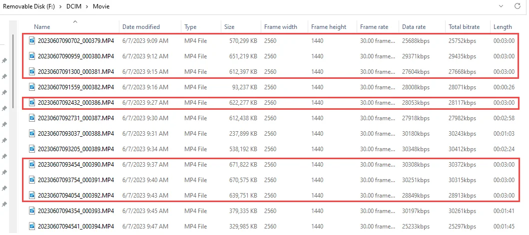

My A119 Mini 2 arrived with firmware V1.0_0516.
At a resolution of 2560x1080 30fps, all minute video files are the same size.
My A119 Mini 2 test/review unit arrived with v1.0_20230423 firmware. Then I upgraded it to v1.0_0509 which was a test firmware at the time. The v1.0_0509 firmware is now publicly available and the latest available via the VIOFO website. The video files created using the v1.0_0509 firmware still have varying bitrates. I'll send an email to VIOFO asking about v1.0_0516 firmware.
I haven't tried 2560x1440 on the Mini 2, but the Mini has the same problem at 2560x1440, the video files are different sizes.
Although at a resolution of 2560x1080 all video files are the same size. Try on your Mini and Mini 2 to change the resolution to 2560x1080.
You will most likely end up with video files of the same size.
The bitrate is dynamic with V1.0_0509 firmware, so the bitrates are varying. The V1.0_0516 firmware is still being tested. We will release it soon after confirmation.
I drove a little with other settings:
Firmware: V1.0_0516. Bitrate: high. Resolution: 2560x1440 30fps.
As you can see in the screenshot, the video files are of different sizes.
I also attached 2 text files in which the bitrate of the largest and smallest video files is visible.
