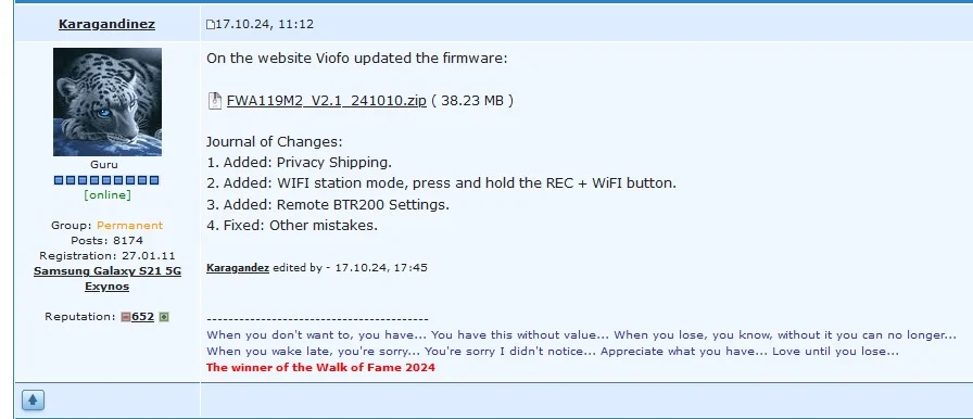

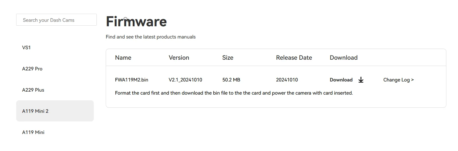

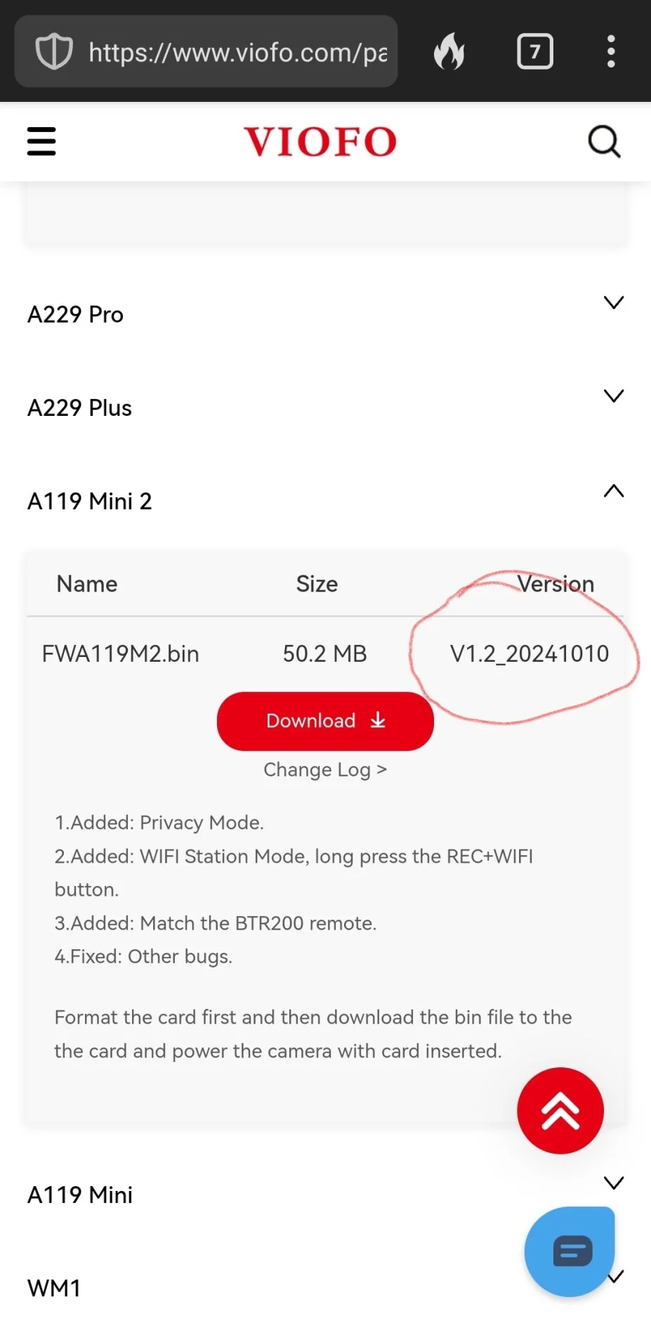

V2.1_20241010

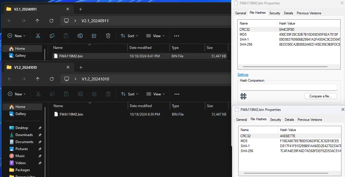

Same exact file sizes as the beta posted above "V2.1_20240911" from https://we.tl/t-n9GEQZUKKo
Is the firmware just a rename despite different MD5 etc?
@Karagandinez the one you posted on 4pda is different file size?
