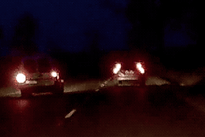

BTW, MOD-6Rg young deer catch from yesterday (far distance, tiny frame crop from 1440p, these are actual pixels, so I didn't expect it to have much detail here):
