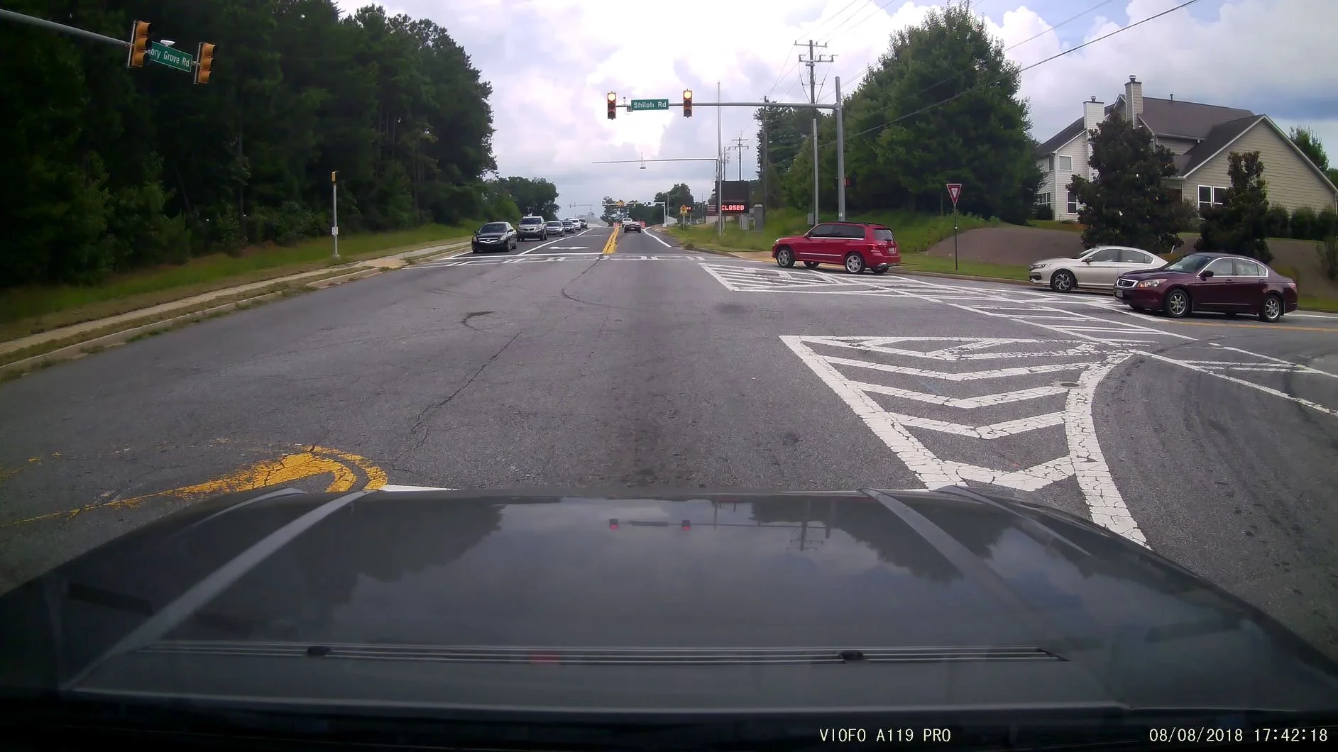

Image at top with date/time is from the mod "FWA119P_v1.31_24Mbps_Sharp20_blueDICE.bin" image on bottom is official viofo firmware V1.30.
Keep in mind difference in lighting, weather and lane/angle of cam ect. Also had to drop pics down to 2mp for site and official firmware pic was cropped a bit for tag info.
Everything looks solid from my short testing with the mod firmware can link videos in dropbox later if needed. 1440p30 ran great might even be tempting to lower the sharpness a bit more. 1080p60 ran without a hitch as well.
I'll test a few functions when I get a chance, thanks for the work again @BCHobbyist!
View attachment 40640View attachment 40641
interesting comparison, thanks for the effort, the Sharpness difference is noticeable, the MOD code difference was 50% less, will release 40% and 60%.
