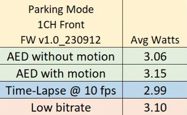

Parking mode time estimates:
Looks like quite significant power consumption increase when being in Parking Mode compared to Mini 2, no? Almost 50% increase or something's wrong with the measurement?
This is a 4K dashcam, so twice the pixels, and a big sensor, so twice the image area.
We should expect a power consumption increase over the 2K dashcam, and 50% is much better than twice!
Here's an alternative parking mode comparison: A119M Pro vs A229 Pro 1CH. The power consumption is almost identical.
I ran the power consumption tests three different times for the A119M Pro. First time with firmware that the unit arrived with [v0.18 I believe]. I couldn't complete the power tests with that firmware due to a bug in that early firmware version. The second time with a v0.29 firmware and I completed my power tests. Yesterday, I ran the tests for a third time with v1.0_20250926 firmware. The numbers decreased a bit between the v0.29 firmware and the v1.0_20250926 firmware. I believe my power consumption numbers are accurate.
I’m disappointed that the resolution of the buffered parking mode is limited to 2560x1440 and it isn’t 4K. The A229 Pro also had this limitation with the early versions of the firmware. But I’m not holding my breath for 4K parking recording with a future firmware update since they may be concerned about heat with this small form factor.

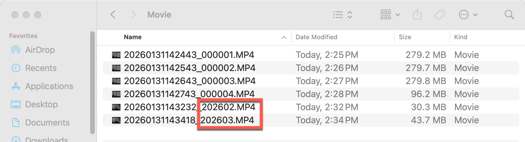

I upgraded my A119M Pro to firmware v1.1_20260109. This firmware version gets rid of the problem of not being able to mount a memory card on a Mac when the A119M Pro formatted the memory card.
I ran a test of formatting the memory card in the A119M Pro, created a few minutes worth of video files and I then moved that card to my Mac Mini. The memory card mounted successfully [without error]. I was able to access the files on the memory card.
The 128GB card was formatted with the exFat file system.
There were two strange file sequence numbers assigned to the last two video files created after exiting the menu system and it resumed recording. I'll ask VIOFO about that situation.
