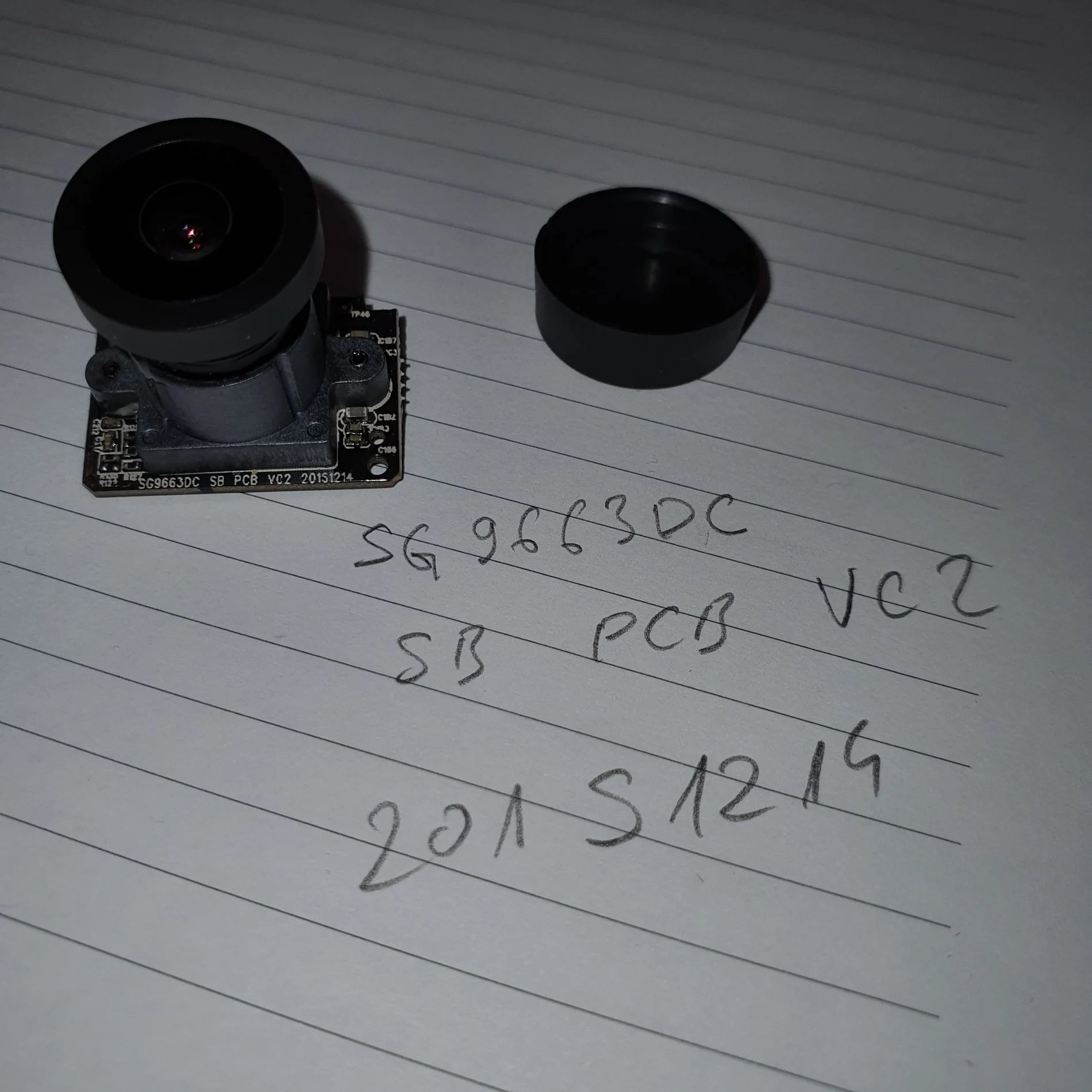

the picture of the original (I'll open to take the picture of the replacement one, but up to me it is the same, just a little bit better focused, but loosing focus with warming up):
You have a plastic holder in the photo

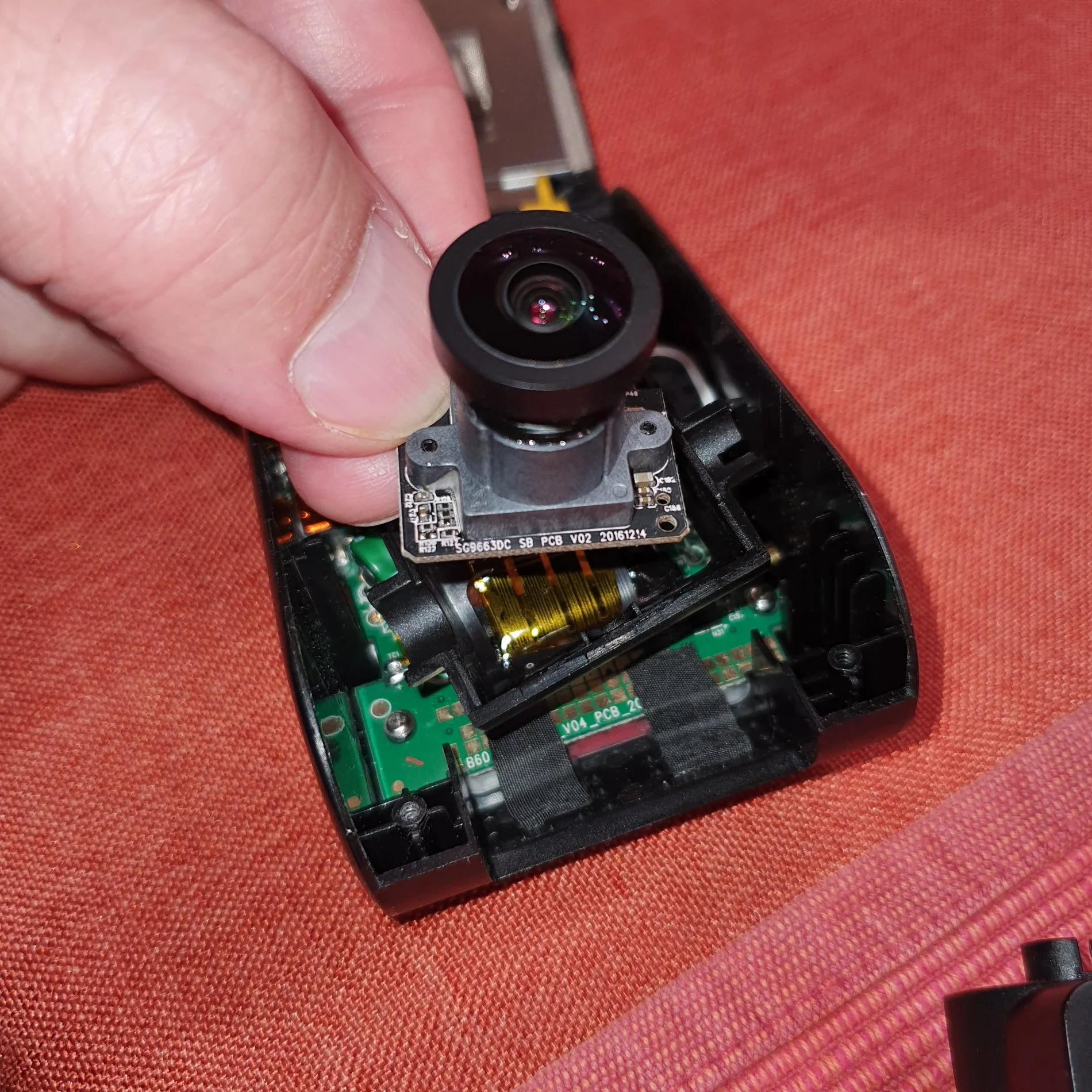

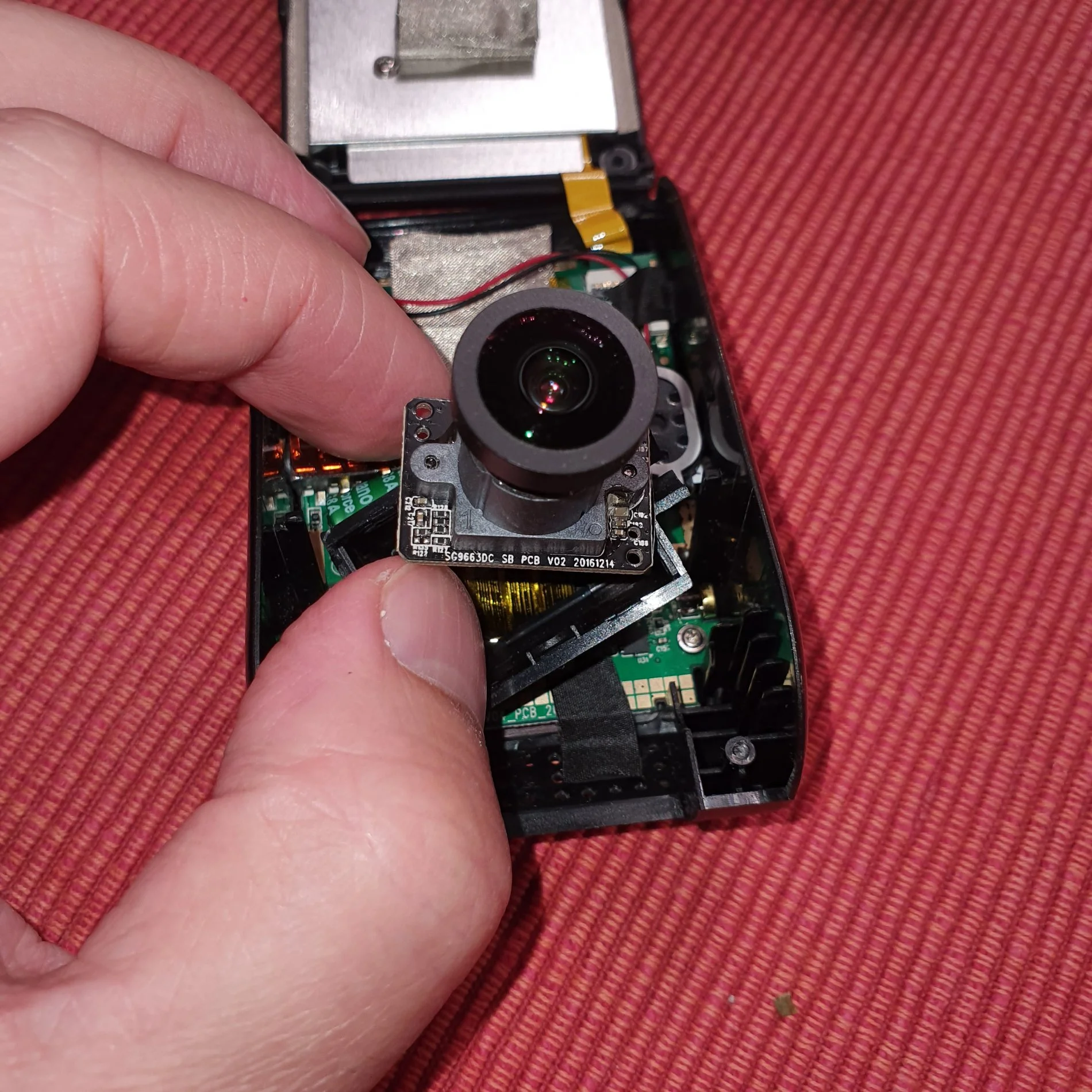

I've just opened both A119S and both have the plastic holder.
So the "fixed" KIT holder sent by @VIOFO-Support has been the bad plastic one, as the original one?!

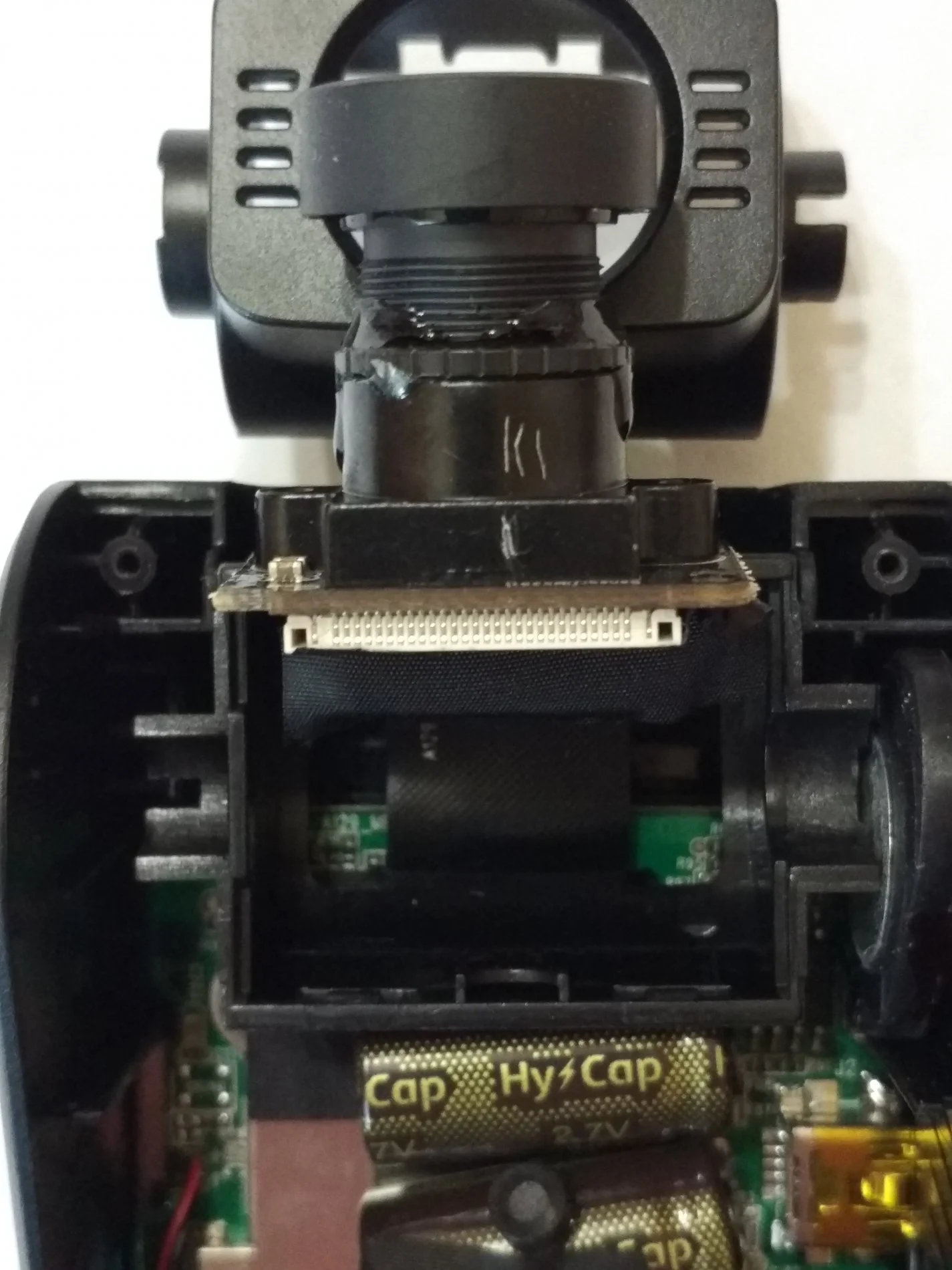

1ST A119A (replacement holder in November 2017, original October 2017)
2ND A119S (october 2017)
