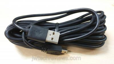

Long mini USB cable

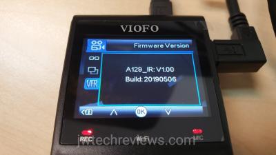

Initial firmware out of the box

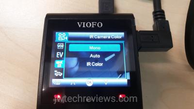

IR cam modes
There are 3 modes for the IR cam: Mono, Auto & IR Color. You can see below in the videos section of each mode for the in-cabin cam and as a rear cam.

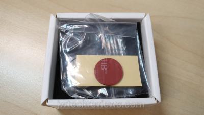

Viofo wireless Bluetooth remote control for A129
Attached Image Attached Image
Open box
Contents
• Wireless Bluetooth remote
• Spare CR2032 battery
• Spare mounting tape
• User manual
Wireless Bluetooth remote control
User manual
Here’s what the remote control does. It’s a great add-on that you can place somewhere nearby instead of reaching up to the A129 to press on the emergency record button.

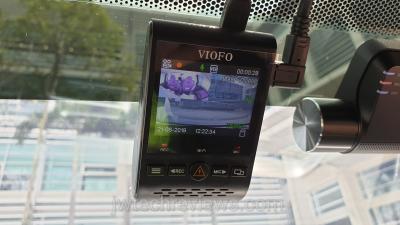

Test setup
Initially, I set up both cams at the front windscreen but later changed it to front and rear windscreen as I wanted to record the rear using the IR cam. I’m using the 128GB Transcend High Endurance microSD for the recordings.

Using the IR cam as a rear cam, the Auto mode will have the infrared LED lights reflecting on the windscreen with a purple hue in the center. Better to use the IR Color mode if want to use the IR cam as a rear cam.
Found a bug while changing the IR mode from Mono/IR Color mode to Auto mode, it will remain in Mono/IR Color mode until the A129 has restarted then will be in Auto mode.

I got mine today, left the original A129 cables in place and just swapped the cameras over, thanks to this vid I know why the rear camera has a pink tint, its set to auto, I need to swap it to colour.

Having the IR rear camera in the back window kinda defeat its purpose, its meant for use as cabin camera, and as you see you have a bit of reflection in the rear window.
Actually, it is designed for mounting back there as an alternative option to the front, however it is then supposed to face forward to record the cabin.
If you are going to face it out of the window then you need to turn the IR LEDs off to avoid the reflection.
