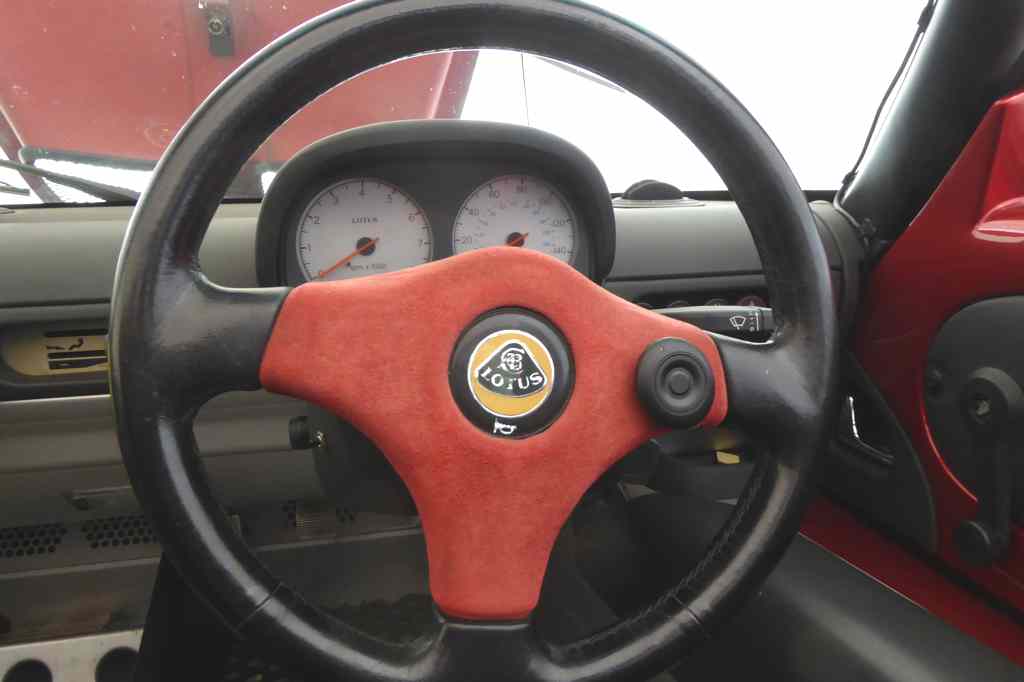

I never use to give this feature much thought till the mini 0906 had that IR fob and I found it coming useful if you wanted to capture something in front or behind you, not nessaseraly needing to capture a full movie clip but just something someone was doing something wrong or just want to capture something you’ve seen interesting
I had mine fixed on the steering wheel near my thumb so was quick and easy if I wanted to capture something
