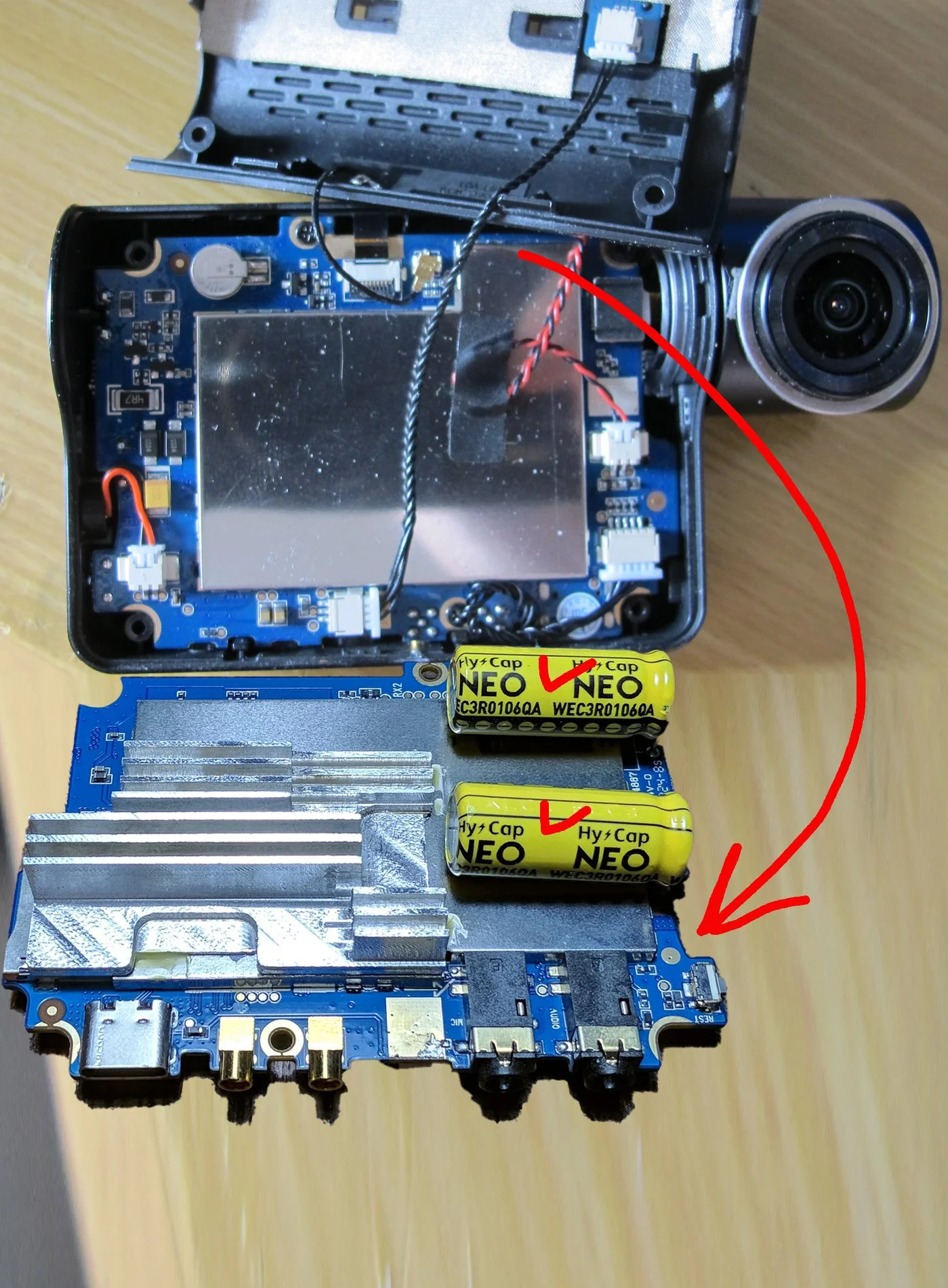

I want to warn you that some chips are under voltage from supercapacitors!!
Therefore, when removing screen covers, be very careful and use a plastic tool!!
Good advice, maybe sensible to discharge the super capacitors; if you do then make sure you discharge both properly before powering the camera again.

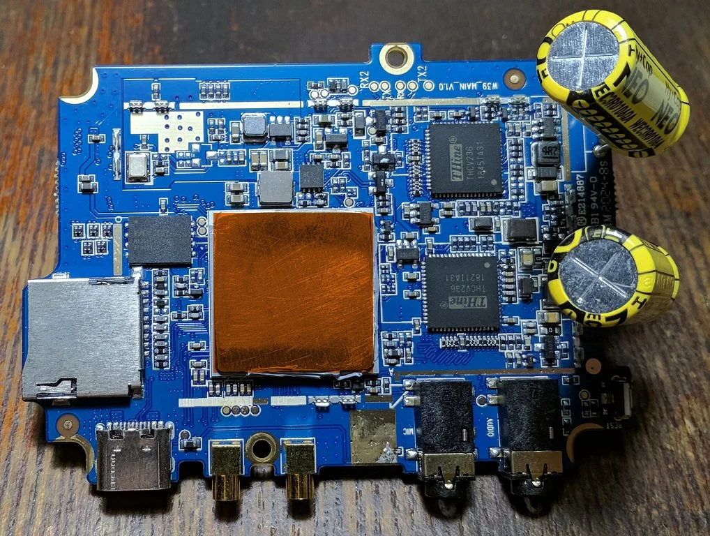

I exclude accidents, I had experience, I also dealt with a radiator, I took off the cover and shorted it in the board, a spark jumped and 139 died, I had to repair it!!
There is a gap between the processor and the radiator, I put in a copper gasket 0.8 mm thick.

I usually cut off one lead at a time and then solder them, it’s easier for me!!
There is still power in them if you just cut a lead, they can still cause damage.
If you short the pins for a few seconds then there is no power left, so they are safe.
Ideally short them through a resistor, and do both until there is no power left.
I don’t cut the wires, but the terminals of the supercapacitors, they no longer power the board!!
But that was a long time ago, maybe viofo has already changed everything in the design!!??

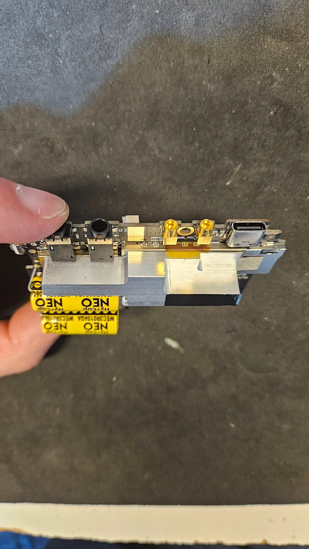

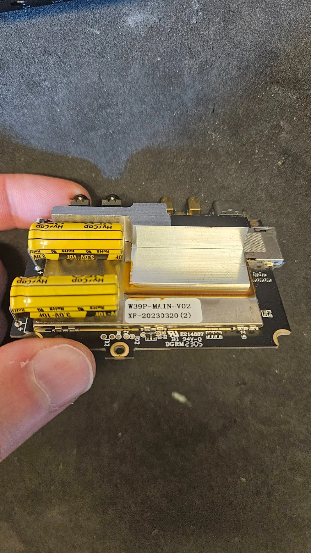

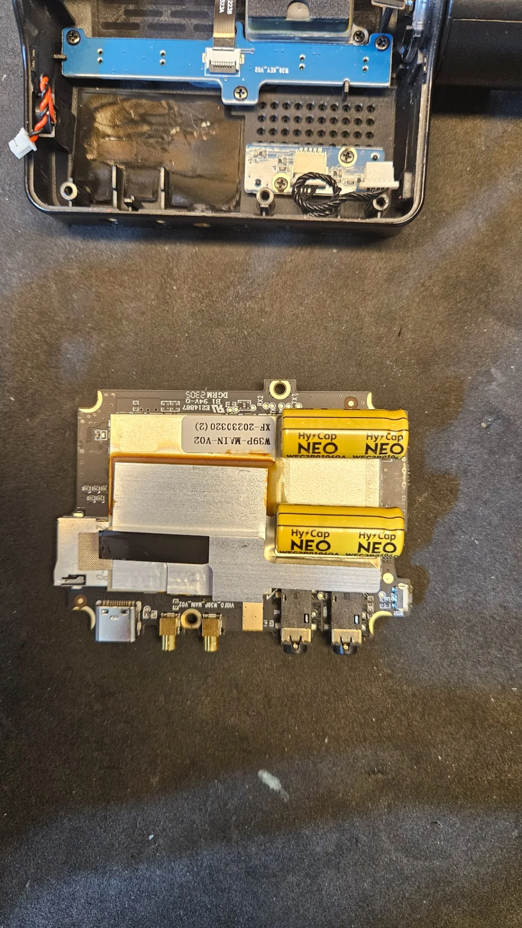

Got it apart but I don't want to start prying stuff.
Missing some solder from one of the super capacitor legs?
Doubt that it is a problem, just looks odd!
I'll touch that up. I don't think I need to discharge them as long as I don't cross + and -
Well I'm done. I touched up the legs of the capacitors. I removed the dust filter from the side that faces the cabin and I tried to break out some of the slots at go up against the windshield for better air flow.
Powered back up fine.
The only way I would attempt to tear it completely down is if I had another working unit.
