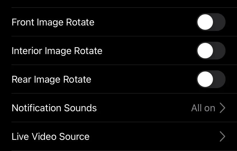

In addition to voice messages, I see that V1.0 1113 also has options for rear camera mirror and rotate. I've not had time to check these functions yet.
I don’t have those options on my iPhone app, still just the rotate options which actually mirrors the picture rather than rotating it.
TonyM
Jul 30, 2013
4,686
4,461
Mobius, SG, Viofo
I'm using the Android app. But as mentioned yesterday, it's still not working properly, at least not for me
Mtrev
Aug 15, 2020
242
167
Shropshire
Yeah I guessed from the top bar that it was Android. Is your app up to date? I wonder what other people are using. Mine has had the options since I received the camera rather than just in this fw.
TonyM
Jul 30, 2013
4,686
4,461
Mobius, SG, Viofo
There have been rotate toggles for all three channels. The latest update added the mirror toggle on the rear camera.
Mtrev
Aug 15, 2020
242
167
Shropshire
Oh ok, I thought you meant the update had added them all. So do none of them work or just the new mirror toggle?
TonyM
Jul 30, 2013
4,686
4,461
Mobius, SG, Viofo
Just the new mirror toggle, AFAIK. I've not tried rotating the front or interior cameras.
