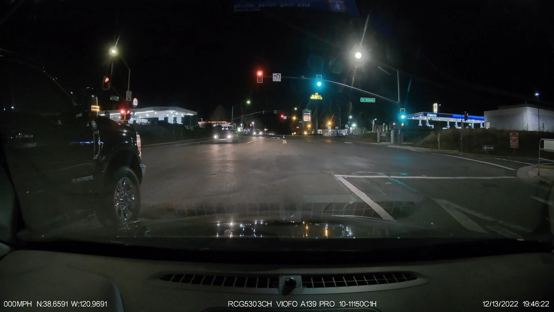

I've been scouring the footage A139 Pro nighttime footage and I can't come up with one example of being able to see a license plate when the amount of ambient light is low (darker rural road or driving down the freeway). When my car was located in the small town I live in, the street / business lights made it somewhat possible to read plates. The light flares (around headlights / streetlights) were larger than I expected with HDR enabled.
Here's one example from nighttime loop8 where the HDR feature being enabled did not completely obscure the plate (left in pic). With HDR disabled, it was a bit more readable, but still not really usable. The plate illumination lights just above the license plate seem to cause the HDR video version of the license plate to look very blurred.
Here's a frame grab from both A139 Pro dash cameras when my car was at the stop light before the on ramp. There is no frame in the HDR video that has a clear plate image. Please remember this website resizes pics above 1920x1080 to 1920x1080.
HDR Enabled Video Frame
HDR Disabled Video Frame
I'm going to start selecting more examples from the video footage I collected for inclusion into my review video. I was just hoping for HDR examples that allowed the U.S. plate size/shape to be visible.
