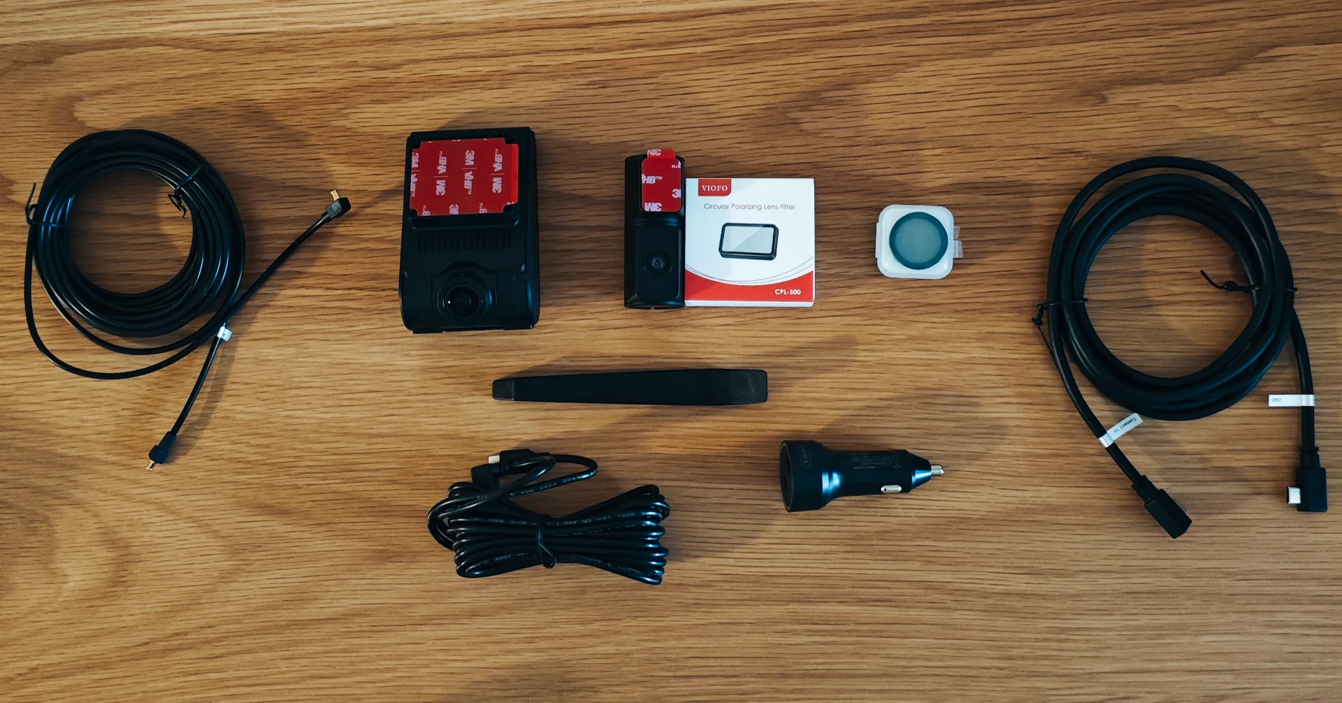

Have had a leave of absence for a little while, and have not been able to get around to reviewing dashcams here on DCT. However, I'm back now with the Viofo A329, the direct follow-up to 2024's well-received @viofo @VIOFO-Support A229 Pro. This model builds upon the powerhouse that is the A229 Pro, with the addition of WiFi 6, extensive SSD support (various form factors such as USB sticks, portable SSD's and SSD's in enclosures), USB 3.0 transfer speeds to devices such as smartphones, and the addition of 4K60fps native recording. All this was made possible by the move to a more efficient processor from Novatek, enabling the increased frame rates, although it drops back down to 4K30 when recording in HDR. And did I forget we have microHDMI on board to mirror and playback your Viofo footage on the big screen. Phew, a lot of new features!

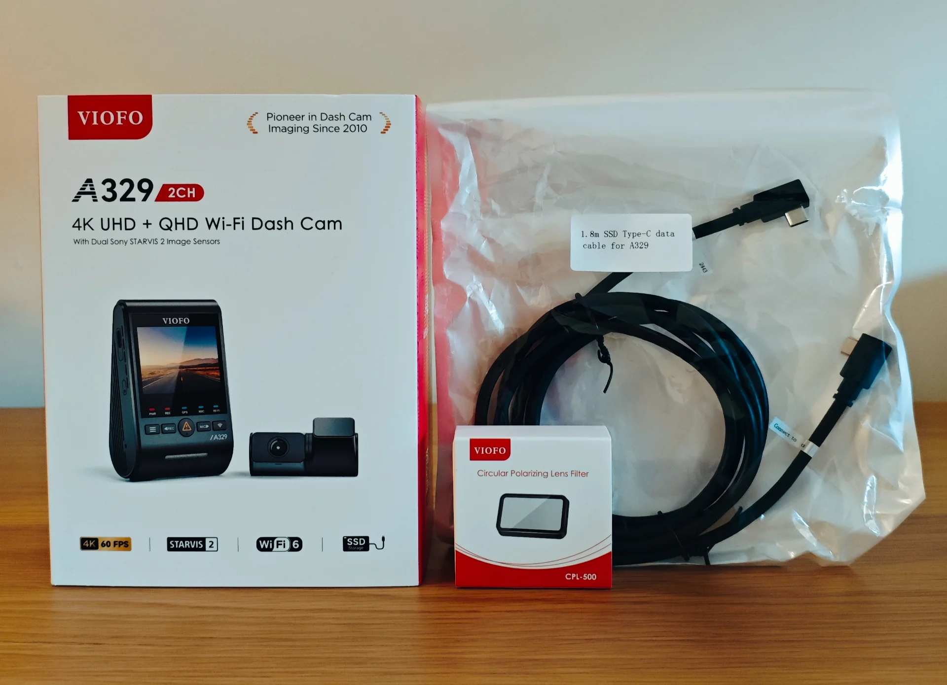

Although there was a move to black packaging with the Viofo VS1, we are back to the now-familiar white with red highlights packaging with the A329. Contained within the box is a plethora of materials; we have the front and rear units, front and rear unit cabling, car charger, CPL filter for the front camera, spare 3M VHB adhesive/electrostatic stickers and black pry tool. One reverted change this year is the move back to coaxial cabling for the rear camera module (which one can see as either a positive or negative, depending on your point of view). It is nice to see that the car charger has made the change to complete USB-C ports (instead of USB-A), and the spare charges other electronic devices you may have at up to 45W. I must note that although the CPL-500 is included in the below photos, this CPL filter for the rear camera is not included in the normal retail pack for the A329, and is available as a separate purchase. The other change present with the A329 is that there is no three-channel support like there was on the A229 Pro (as of yet - this may or may not change in the coming months).
When it comes to the physical build of the A329, we are once again greeted by a solid plastic housing. This time in response to heat concerns the A229 Pro had, we have extra ventilation holes on the left and right sides of the dashcam. It carries over the design of the A229 Pro - why mess with the wedge form factor that works well, when you can iterate and make improvements. The rear camera module inherits the design of the RTC300 telephoto camera that was released as an add-on for the A229 Pro; this also has a solid and quality feel in-hand. Moving onto the installation, installation is once again a relatively straightforward affair, with no major pain points. Coaxial cabling made installation easier in tucking the rear camera cable under the headliner and pillar trims in my vehicle, which was welcome.

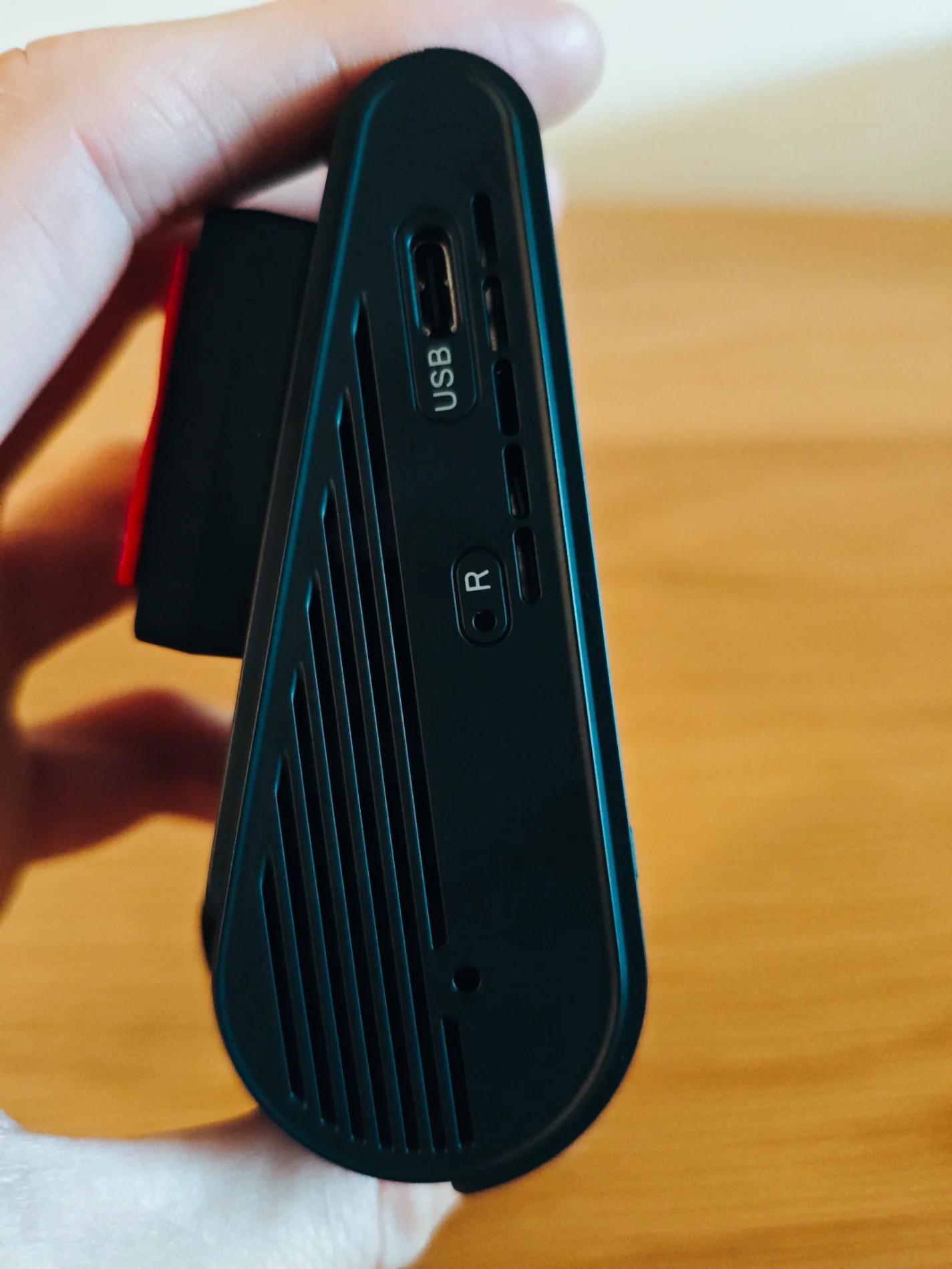

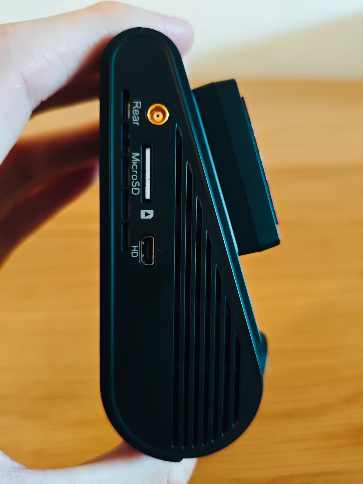

Some close-up photos of the Viofo A329 dashcam:

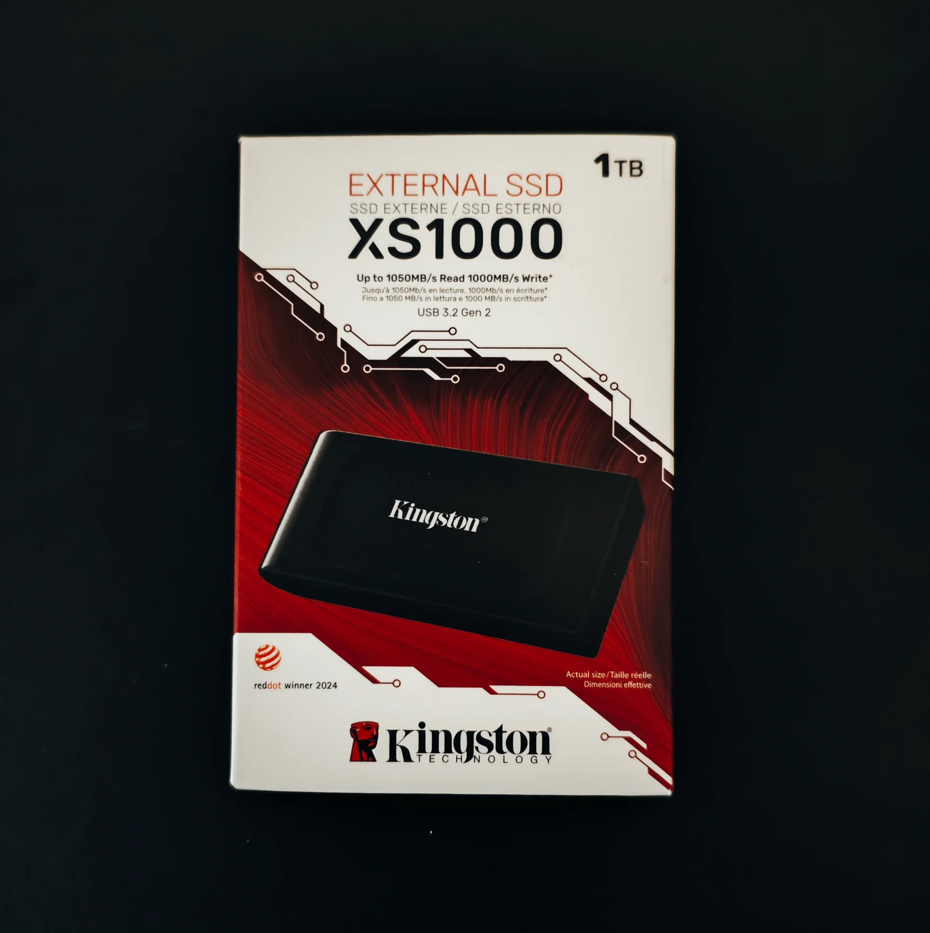

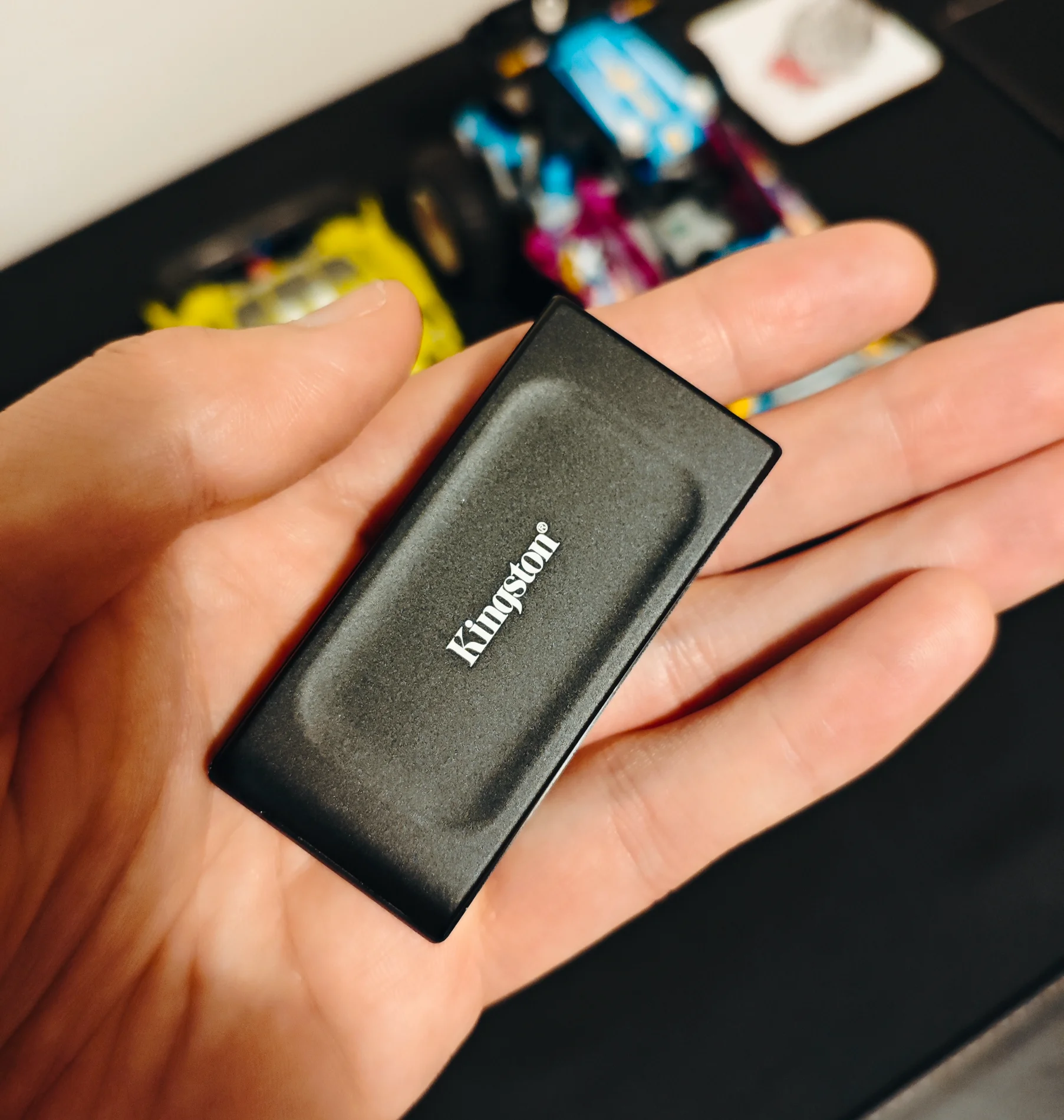

I am also super-excited to try out the SSD support the A329 possesses. I have chosen the Kingston XS1000 to be the guinea pig for my testing, over the reliable and proven Samsung T7/T7 Shield (and much maligned and unreliable SanDisk Extreme Pro). The Viofo 1.8m cable is available for purchase separately to facilitate installation in a location such as the glovebox. There is also a 2.5m cable from Viofo that wasn't available at launch but now is.

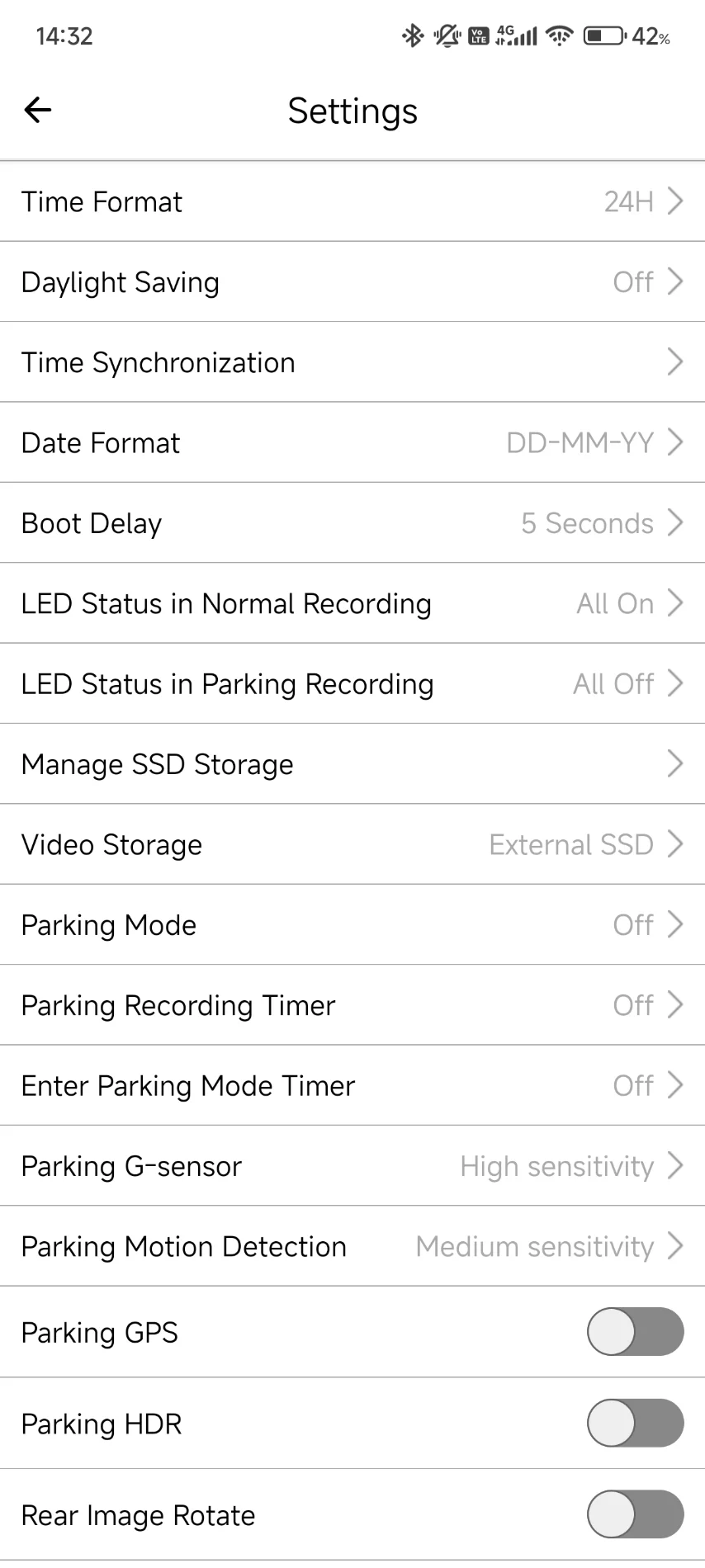

Thought I would post some screen grabs of the Viofo app on Android, showing the layout of the app and the extended settings for the dashcam itself. This mirrors the options that are available in-camera on the dashcam itself.

Showing the installation location of the Kingston XS1000 SSD in my vehicle (2020 Kia Cerato/Forte sedan). This was using the @viofo 1.8m SSD cable. I used 3M Command Picture Hanging strips (in black colourway) to secure the SSD to the inside of the glovebox.
I have to say that after wiring the SSD cable under the headliner and down the A-pillar and down into the glovebox, it was a tight fit.
I would recommend most users use the official Viofo 2.5m cable that's available, as this gives more room for installation in case it's required.
As a follow-up to my SSD testing, encountered the "Slow External Storage" error today whilst driving around. Luckily it abated upon next vehicle start.
Hopefully these issues will be resolved in the final public v1.1 firmware release.
I wonder why this happened...
How can firmware fix this?
Did you check the speed of the Kingston XS1000 SSD with a 1.8m cable from Viofo on your computer before installing it?
I would give it a go with a short USB-C cable and see what happens. I would also ask VIOFO at what speed are they writing to the SSD. I have also found a variance in USB-C cable when it came to resistance, as well length. Longer cables induce higher resistance and potential to be affected by interference from surrounding equipment. Some cables are not made as well and have a higher resistance.

Yes I already knew those specs when I was cross shopping other external SSDs before i bought the Kingston (Crucial, silicon power), and tested it when I received it. Was getting around 900mb/sec writes.
I think another user on here was asking about the official Viofo 1.8m cable and why it wasn't getting decent write speeds, but they also determined it wasn't a USB 3.1 speed cable. It doesn't have to write at those speeds to the SSD anyway, so USB 2.0 would be plenty enough. Issue here is with the dashcam itself and it's stability with writing to the SSD.
Lol Kingston is a big company in the PC world for decades with pretty decent performance and reliability. For those who don't really know much about PCs, they won't understand this.
Regardless, the dashcam is a device that should work with SSDs. It's not like I've chosen a crappy no-name/fake SSD out of the blue. That compatibility list is on point with Samsung, but the SanDisk isn't as that was a model that had issues with failing that are still in the process of lawsuits. Which no one here on the forums knew of until I told them, because well, they don't keep up to date with the PC world.
That is the exact reason I chose a Kingston SSD because others have already tried the A329 with Samsung SSDs, so I thought i would give the Kingston a try for something different.
Agree with Agie. The problem is with VIOFO and not with the manufacturers of a SSD. This is simple stuff and writing to any SSD should be a guarantee, other than black-market fakes, of course. There can be limitation imposed by cable length and quality, but basically, any SSD should work with this dash cam. Especially as this is a premier dash cam from a premier company.
