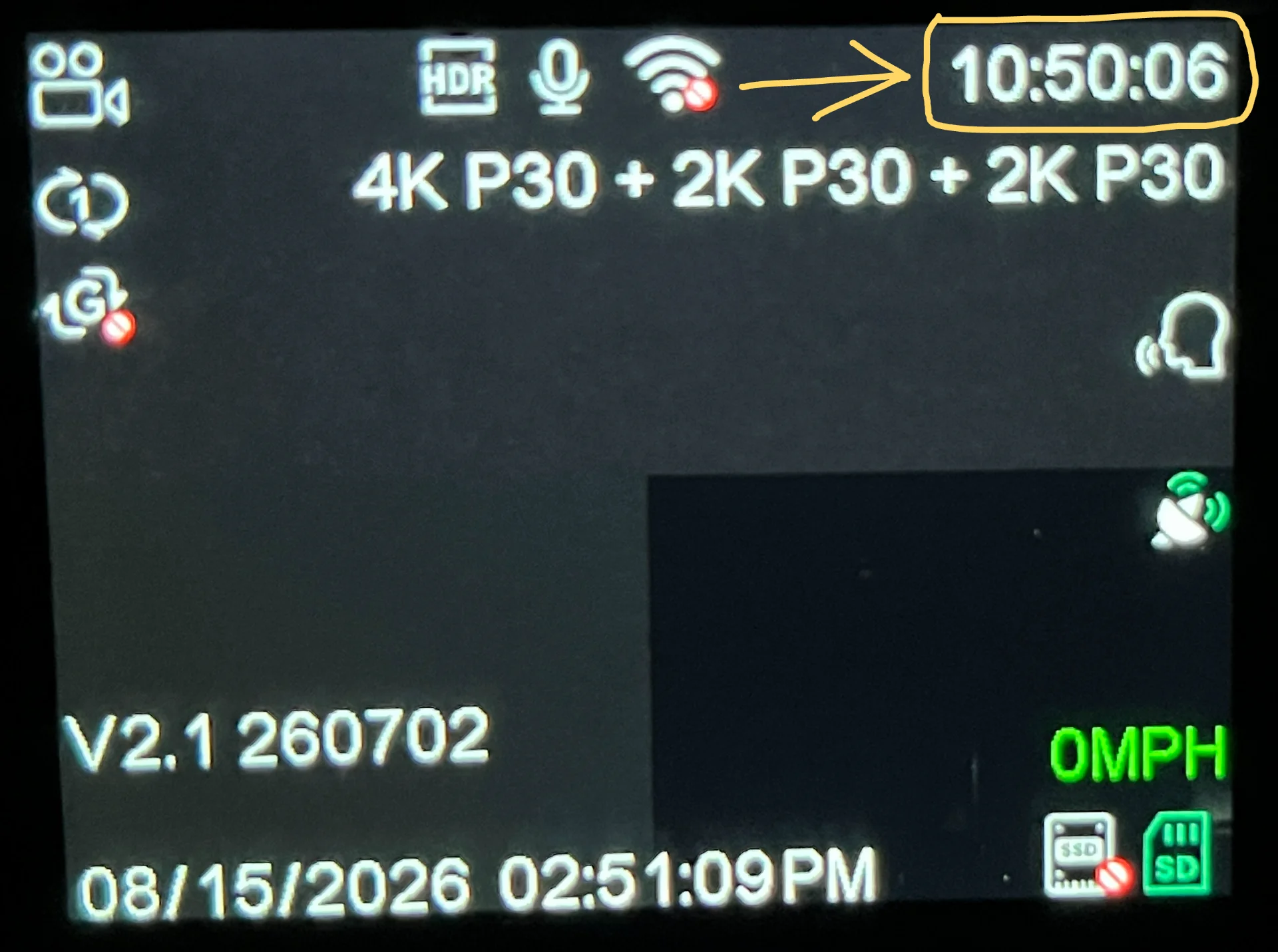

@cartyre
I noticed your cam is set to 60 Hz instead of 50 Hz. You may notice better image quality if you change that to 50Hz.
I suggest resetting the A329S to factory settings, then reflashing with the latest firmware. A329S Support
As previously suggested, do a Full format on the SD card.
Once you have done those two items, you'll be back to factory settings. Now record and see if the issue still occurs. I would set the dashcam time with your cellphone as well.
