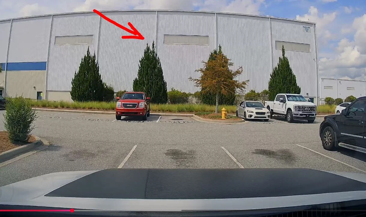

I don’t have a second camera, but this is more noticeable in the LBR video if you look at the wall (pointed with arrow in the attached screenshot).
You can see a sort of “flickering/oscillation/fluctuating/shifting right and left” - I’m not sure how best to describe it.

Against that white wall, I can see what you are talking about. At first, I thought this effect only applied to white backgrounds/clouds in the distance, but then I noticed the bush on the near left did the same.

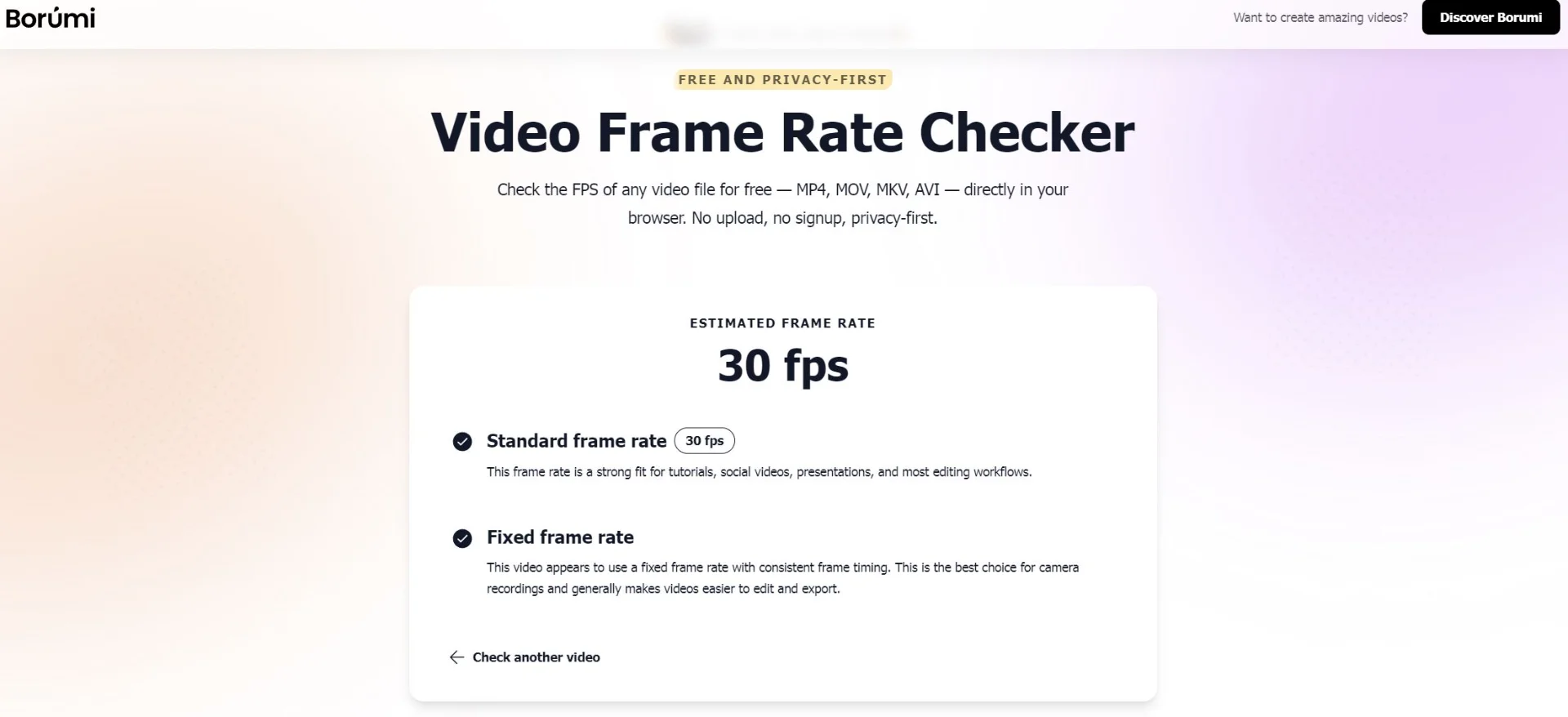

Thanks @lufa6977
It is more noticeable against the white wall, but the entire image is affected.
I checked the FPS in Windows7 file properties, and verified with couple of “Video Frame Rate Checker” websites.
Results are in attached images.
It is 30 FPS, but it looks like a “sort of time-lapse”.

Justs wanted to let you know that you are not alone.
When I zoom in on the video on my phone I can see it's not only the corrugated wall, but can see this on the floor etc.
Thanks for posting,
So, it is not just me...
I tried changing the frequency from 60 Hz to 50 Hz and back—to no avail: the "flickering" didn't go away.
