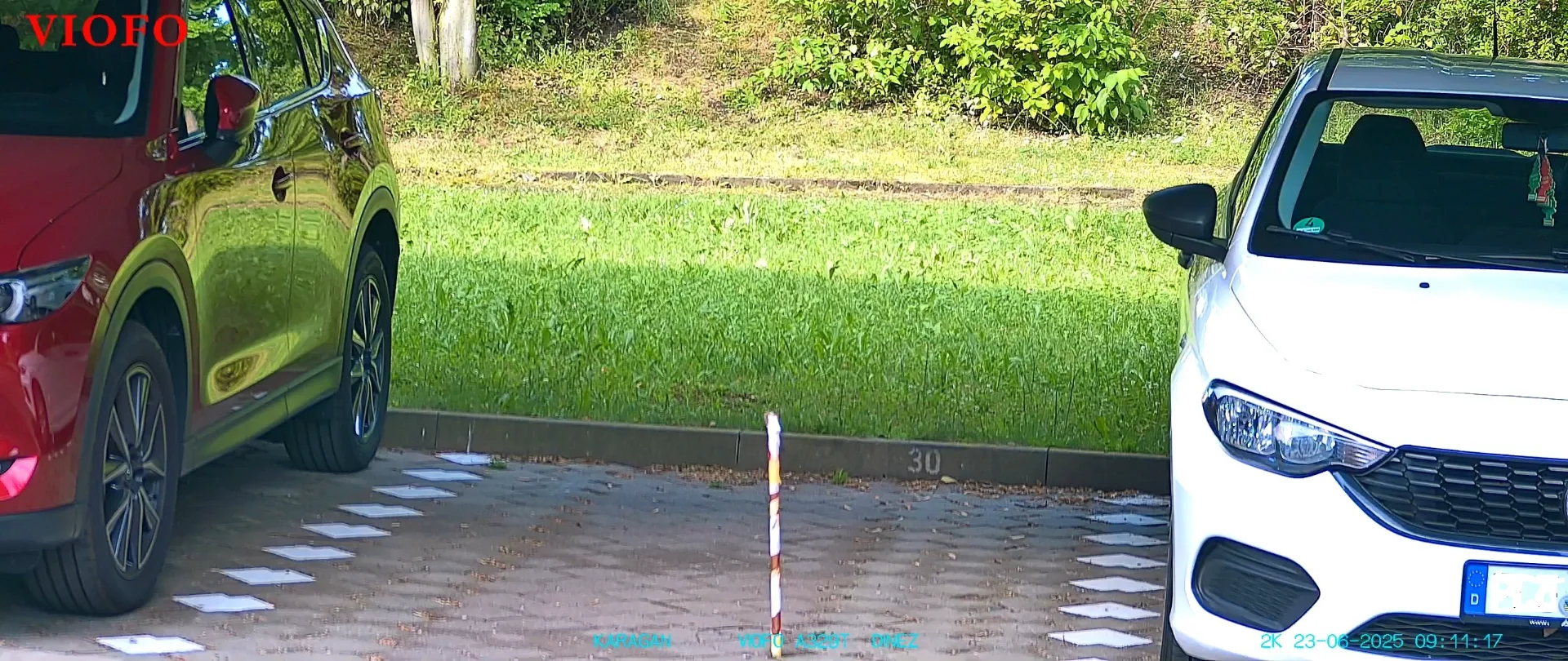

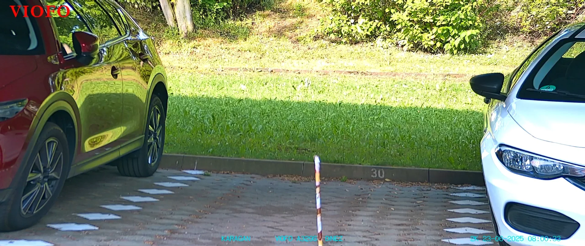

I checked the telephoto with the firmware with the letter "S" installed on the A329S.
The telephoto works, BUT distorts objects.
The difference in the telephoto with the firmware "S" and "T" can be seen in the screenshots below.
"S"
"T"
"S"
"T"
That's because the S firmware uses the extra camera port for the fisheye interior camera, so it will have software adjusting for that purpose, giving any the telephoto a slight fisheye look.
So changing the the T firmware will adjust the view to the correct set up for the telephoto camera.
