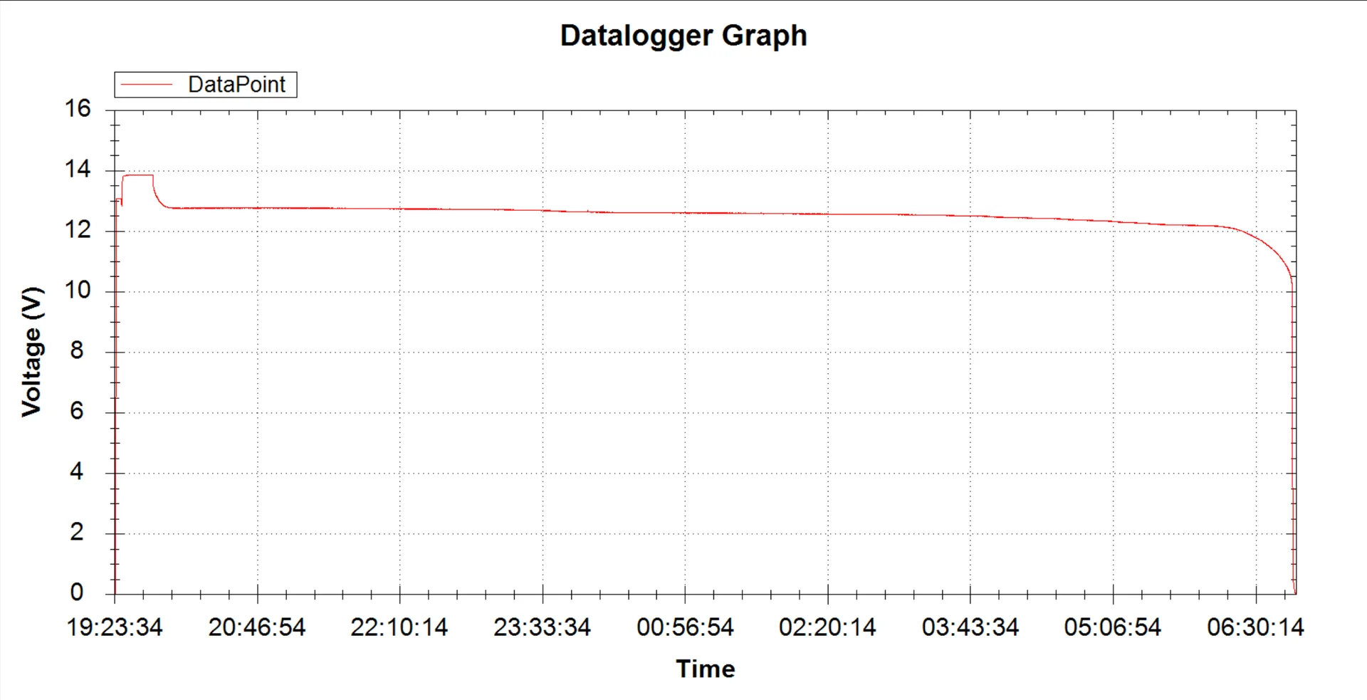

Discharge Test: BP-100 fully charged, A139 Pro 3CH in Low Bitrate Parking Mode
20250713 19:25: BP-100 top off charge perform before start of discharge test
20250713 19:46: Start - Turn off ACC input to BP-100, A139 Pro 3CH starts low bitrate parking mode
20250714 06:51: Finish - BP-100 turns off due to low battery pack voltage
Total time: 11 hours 26 minutes

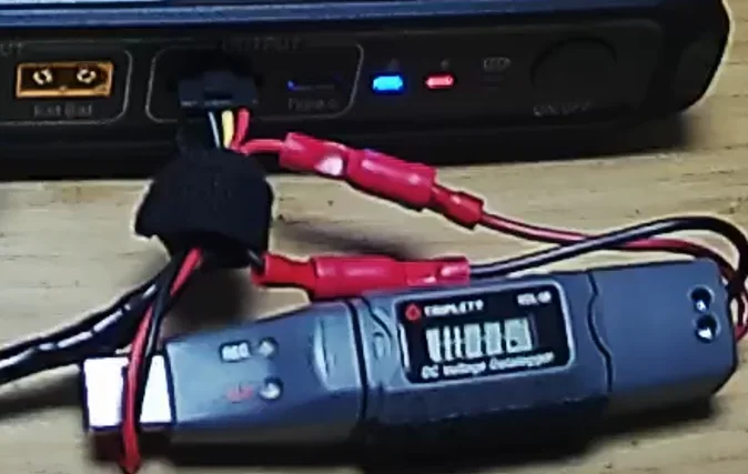

The voltage data logger that I had monitoring the 12V output voltage from the BP-100 to the A139 Pro 3CH:
The BP-100 output voltage just as it turned off was 10.11V - having a light that fully illuminates the data logger's LCD screen, also causes a reflection/glare making it so the monitoring camera cannot record its contents. 🙂

I don't have that data logger, so I was "stealing" a voltage signal from the unused input/output from the EP100.
I got 10.41V at end of discharge cycle.

Based on the discharge time, and your measurement of A139 low bitrate power consumption, you got 104 Wh out of it, not 100 Wh as the BP100 name suggests. Assuming the power consumption measurement is still valid.
