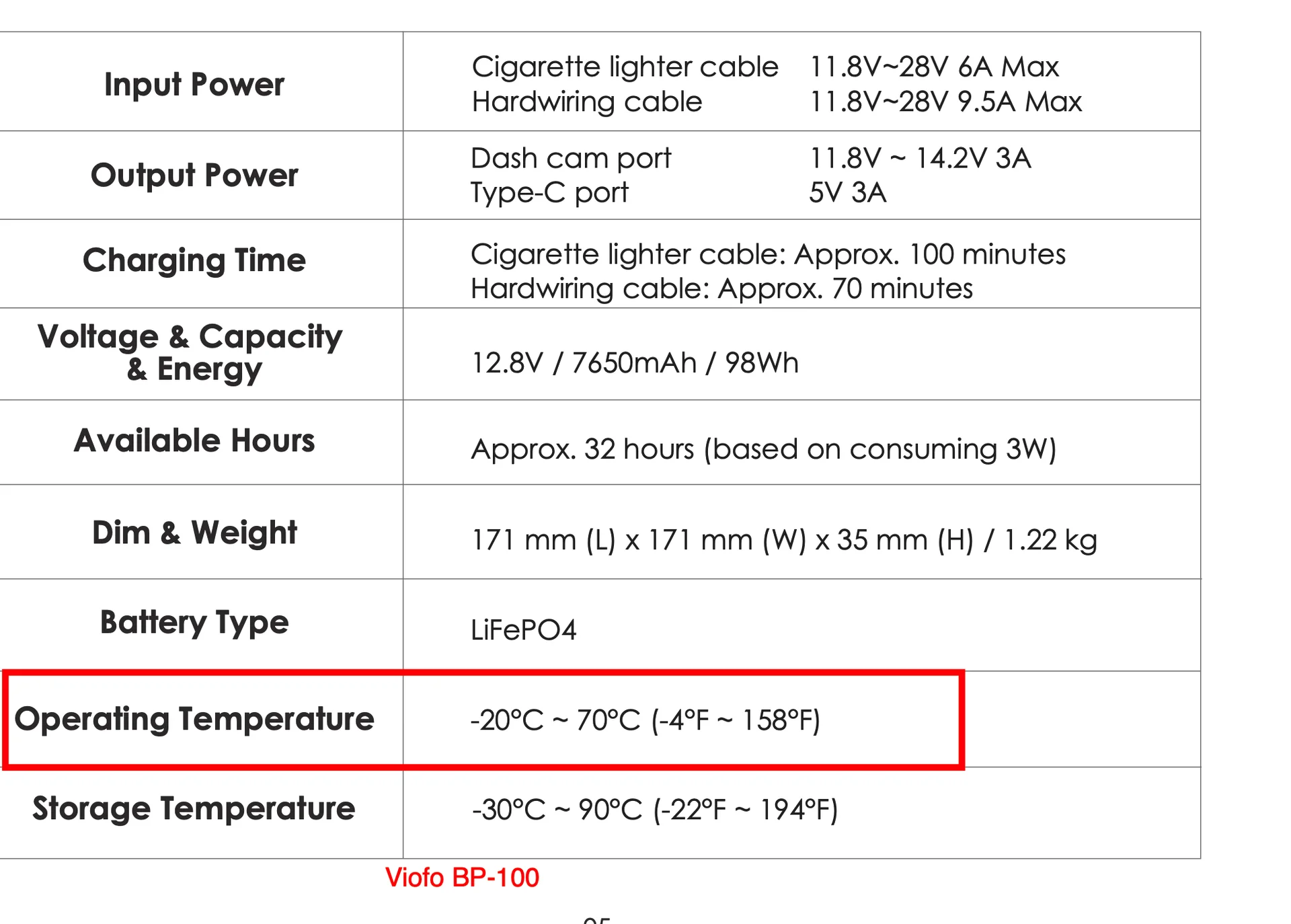

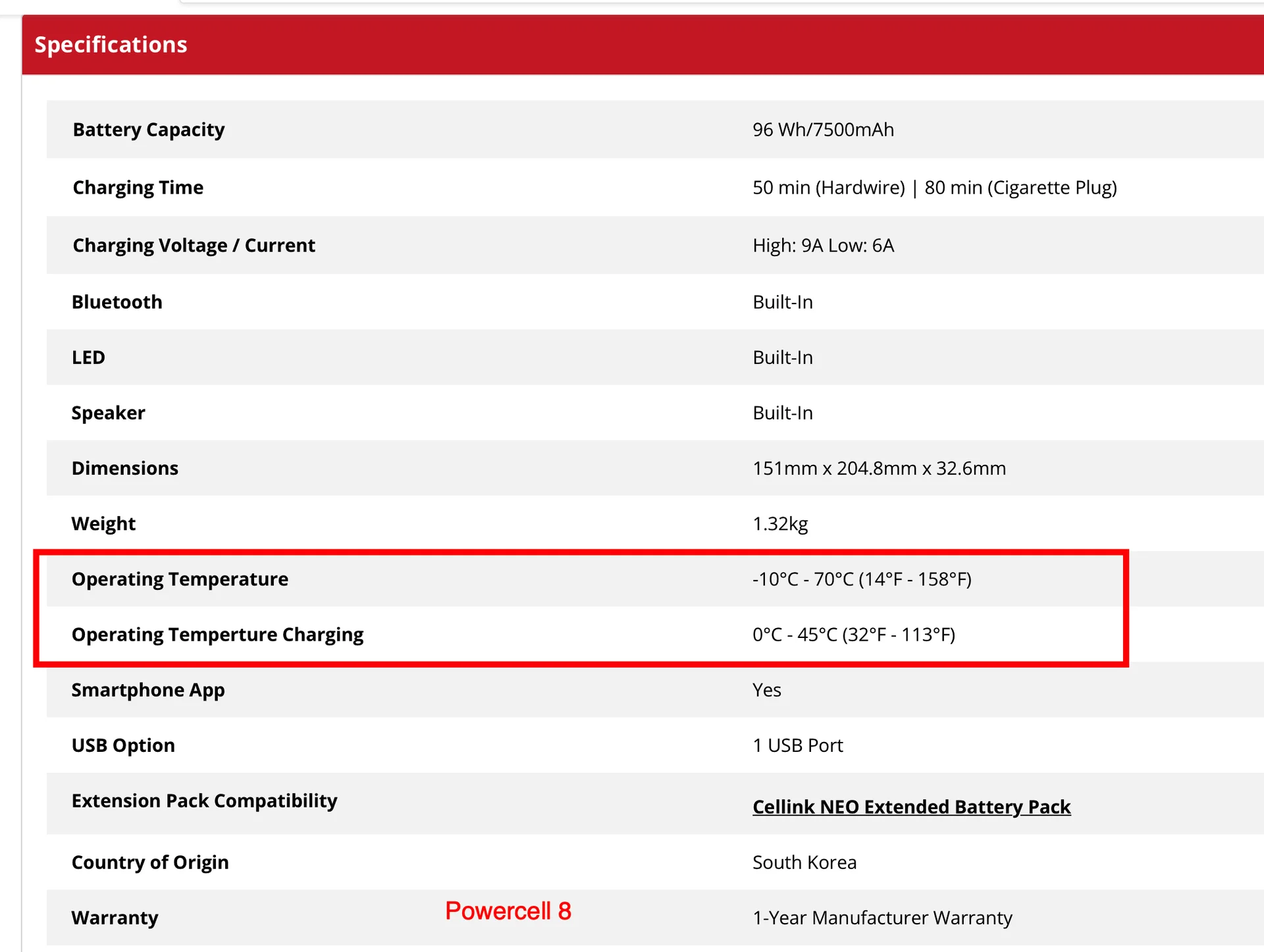

Interesting the BP-100 has a wider operating temperature range than PC8 and they don't spec a charging temperature.
BP100 -20C to 70C
PC8 -10C TO 70C
BP100

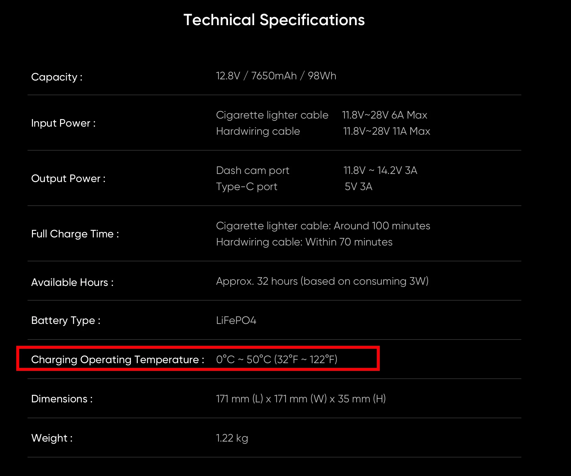

EDIT:
I found the Charging Temperature spec on the Viofo website
Powercell 8
