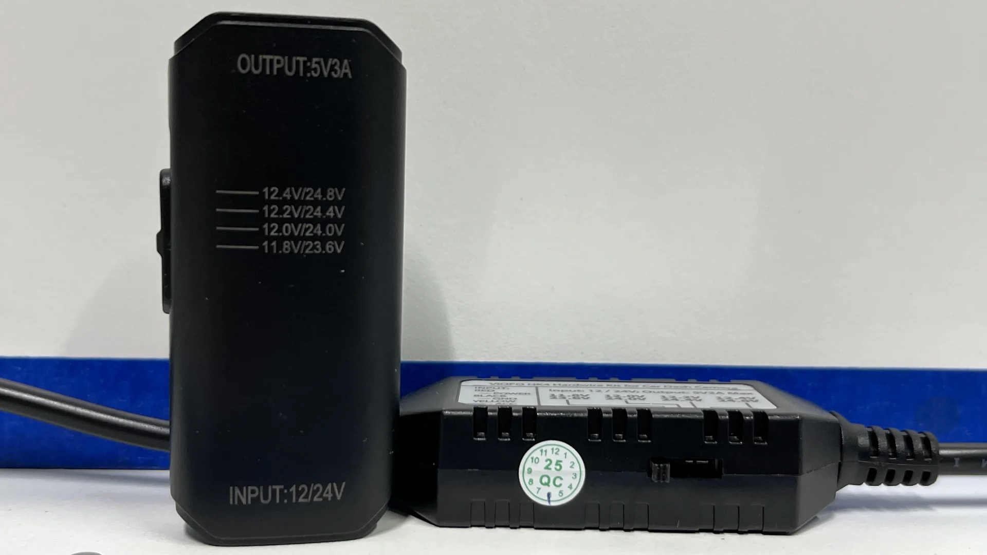

BP100 Hardwire Kit Power Module

The BP100 Hardwire Kit Power Module does not have Bluetooth.
What I like about it, is it does not have any circuitry other than converting 12V down to 5V, (like low voltage cut-off).
So it’s very simple, and should have the least amount of “internal” power consumption.
The BP100 BMS allows battery pack voltage to drop down to 10.11V before shutting off.
The low voltage cut-off on the HK4 & HK6 is 11.8V.
This means the BP100 Hardwire Kit Power Module can "squeeze" every last available electron, and send it to the camera.
Based on my testing depending on number of camera channels this can extend parking mode operation from 30 minutes to 2 hours in Low Bitrate parking mode.
But now that we have LPID those numbers should be increased 10 fold.

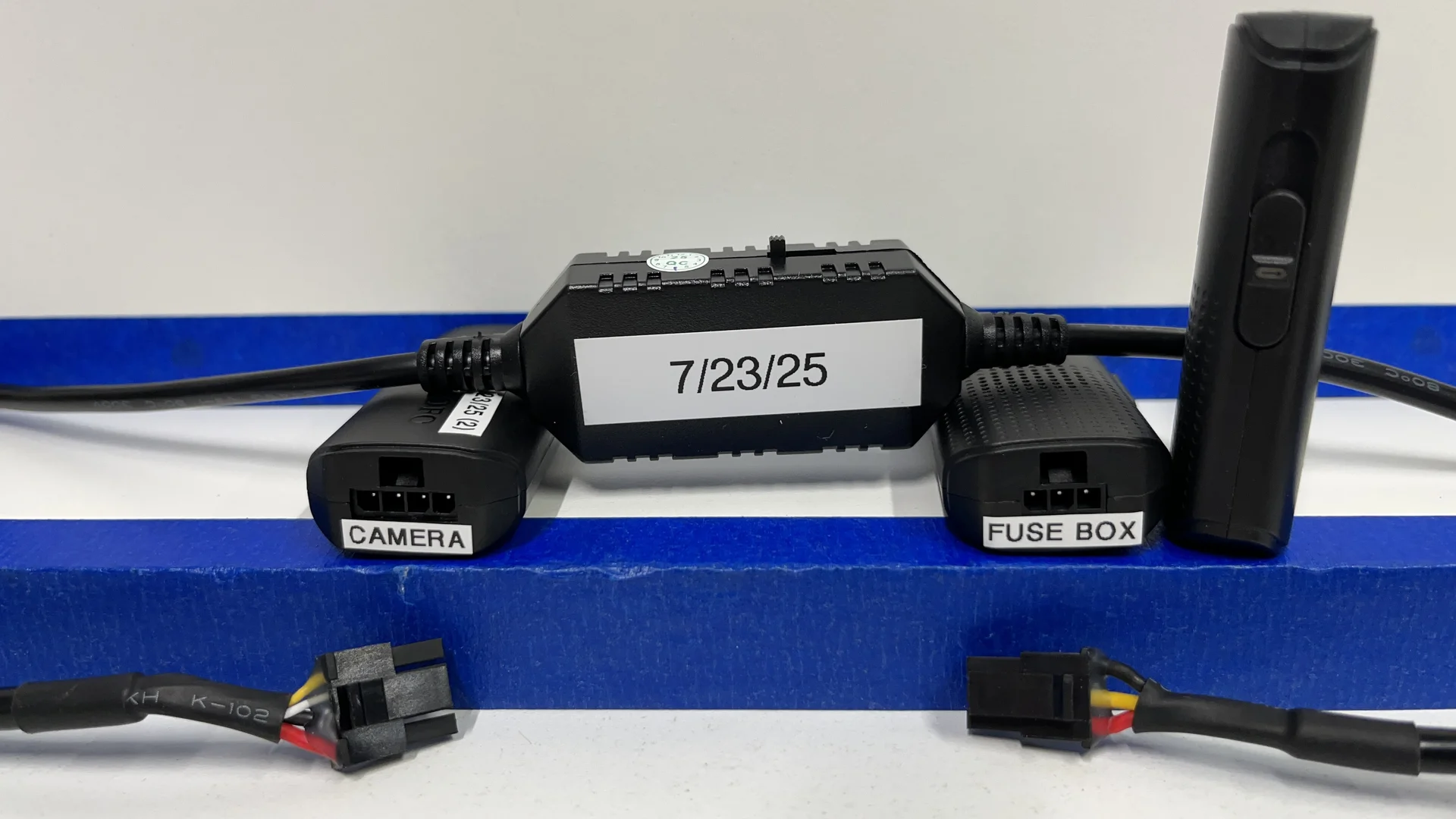

When the first HK6 was delivered 6/9/25 I was pleased to report the RED Status LED from the HK4 was absent.
Well now it’s back on the 7/23/25 “models”.
I always disliked the RED Status LED on the basis of power consumption.
But it looks like it only uses between 0-1mA, so I guess I can live with it. lol
Here’s what the RED Status LED looks like in action;

Whenever using a dash cam battery pack you “never” want to use a hardwire kit with low voltage cut-off.
This is so you can get every last bit of available capacity from the pack into the camera.
This is why the BP100 comes with an included 12V to 5V power cable, (see attached photo).
If only the HK6 had a 5th setting to disable low voltage cut-off completely.
Then you could take advantage of A329S’s Hybrid Parking Mode, and all other HK6 benefits.
Maybe if enough customers requested this feature it might happen. lol
Wink, wink, nudge, nudge; SUBMIT A TICKET

The included charging cable of BP100 doesn't have a low voltage cut-off feature, it means you can use the battery until it is empty.
The LPID sounds too to good to be true.
Would you like to see a video demo?
It will take me a few hours to set up.
I guess I don’t understand the BP100 12v to 5v cable part.
The BP100 Hardwire Cable does the same thing as the HK4 & HK6, except it does not have any circuity for low voltage cut-offs, (see attached photos).
This means it will allow dash cam battery packs to full discharge all the way down to approximately 10.1V, instead of the HK4, or HK6 cutting off power from the battery pack to the camera at 11.8V.
Based on my testing the capacity from 11.8V down to 10.1V means you get additional parking mode operation from 30 Minutes to 2 Hours in Low Bitrate depending on number of channels.
However, now that we have LPID those figures will be increased 10 fold.
Also the BP100 Hardware cable in LPID only uses 31mA x 12.6V = 0.39 Watts.
The HK6 in LPID uses 35mA x 12.6V = 0.44 Watts.
PC8 Capacity 96Wh ÷ 0.44 Watts = 218 Hours / 9 days
PC8 Capacity 96Wh ÷ 0.39 Watts = 246 Hours / 10 days
