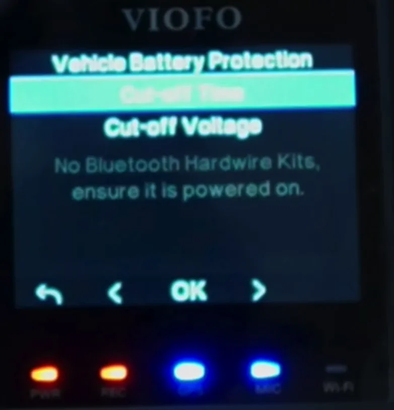

1. Why are there 4 wires on the output (camera side) of the HK6 vs the HK4 that only has 3 wires?
2. Why do you call the menu settings in the A329 camera that work with the HK6 Hybrid Parking mode "cutoff voltage" when it's primary purpose is to set the Hybrid Parking transition Voltage?
If it's being used only in Normal Parking mode, the camera menu cutoff voltage would be redundant with the HK6 cutoff function.
2. Why do you call the menu settings in the A329 camera that work with the HK6 Hybrid Parking mode "cutoff voltage" when it's not actually "cutting off" the camera"? This is confusing and conflicts with the same term used to describe the physical cutoff voltage switch that actually does shutoff camera voltage. Unless I'm missing something it would be more clear to call it "Hybrid Parking Voltage".
When used with "hybrid parking mode", the "cut-off" voltage setting is the transition point from the "normal parking mode" [AED, Time-Lapse, or Low Bitrate] to the low power impact detection. When using one of the normal parking modes [not hybrid] , the "cut-off" voltage setting actually will turn off the dash camera when the input voltage to the HK6 goes below that voltage level.
That makes more sense but since it's dual use, it would be better to call it "Hybrid Parking or Cutoff voltage" or better yet just call it "Hybrid Parking Voltage" since that's how it would normally be used.
I would think anybody that buys an HK6 vs HK4 wants it for Hybrid Parking mode.
Why bother having a setting for cutoff voltage in the menu when the HK6 also supports this function? Its redundant.
For example, you could set the HK6 to 11.8V as a lower bound cut-off. For day-to-day driving in winter you might want to set the dashcam voltage cut-off to 12.0V. The HK6 may be located in a hard-to reach location, so adjusting the cut-off using the app is easier for some users.
