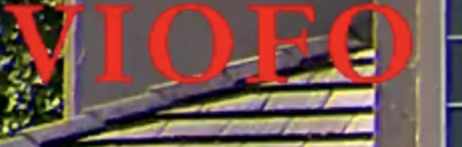

As I perviously answered, there is some in the opening scene of the video @mentadent was referring to, and it can also be seen in Panzer's footage, not a big problem, but it is clearly there, even if you can't see it:
You obviously really had to dig to find what you are alleging to be chromatic aberration. You didn't present any links like I asked for but apparently, you are referring to the first video in @Agie's posts of RTC300 samples. How about a time mark or stamp for the video so we can examine your magnification in context and can see where this extreme crop magnification is taken from in the video. Also, I note that although you allege aberrations in "Panzer Platform's videos", you avoid posting any links or documentation there as well.
I'd need to see something more definitive before I am convinced that there is significant chromatic aberration to be concerned about. I'm not saying it can't or didn't occur but the proof you've offered is unconvincing and questionable under the circumstances.

That is where my screen grab is from.

I have said in every post that it does not significantly affect plate readability, so there is no need to be concerned, but it does have more chromatic aberration than Viofo's other recent lenses, which tend to be very good. The VS1 lens is exceptionally good.

It's on everything, that light pole has one yellow side and one purple side. The wheels have purple. Could be fixed with AI
