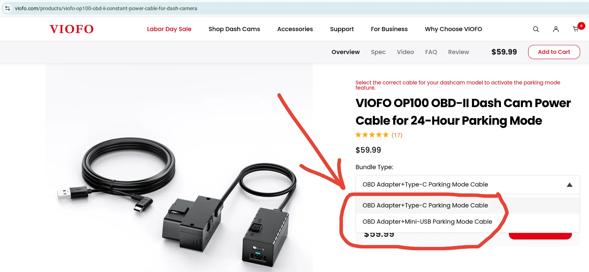

If you order OP100 directly from VIOFO you select which cable you need, (Type-C or Mini USB).
If you order from Viofo UK it looks like they sell OP100 in three different variations.
1.) OP100 no cable £40
2.) OP100 Type-C £50
3.) OP100 Mini-USB £50
I have an OP100 on hand if you need me to do any testing / probing on it.
But I don't have an A119V3 on hand.
