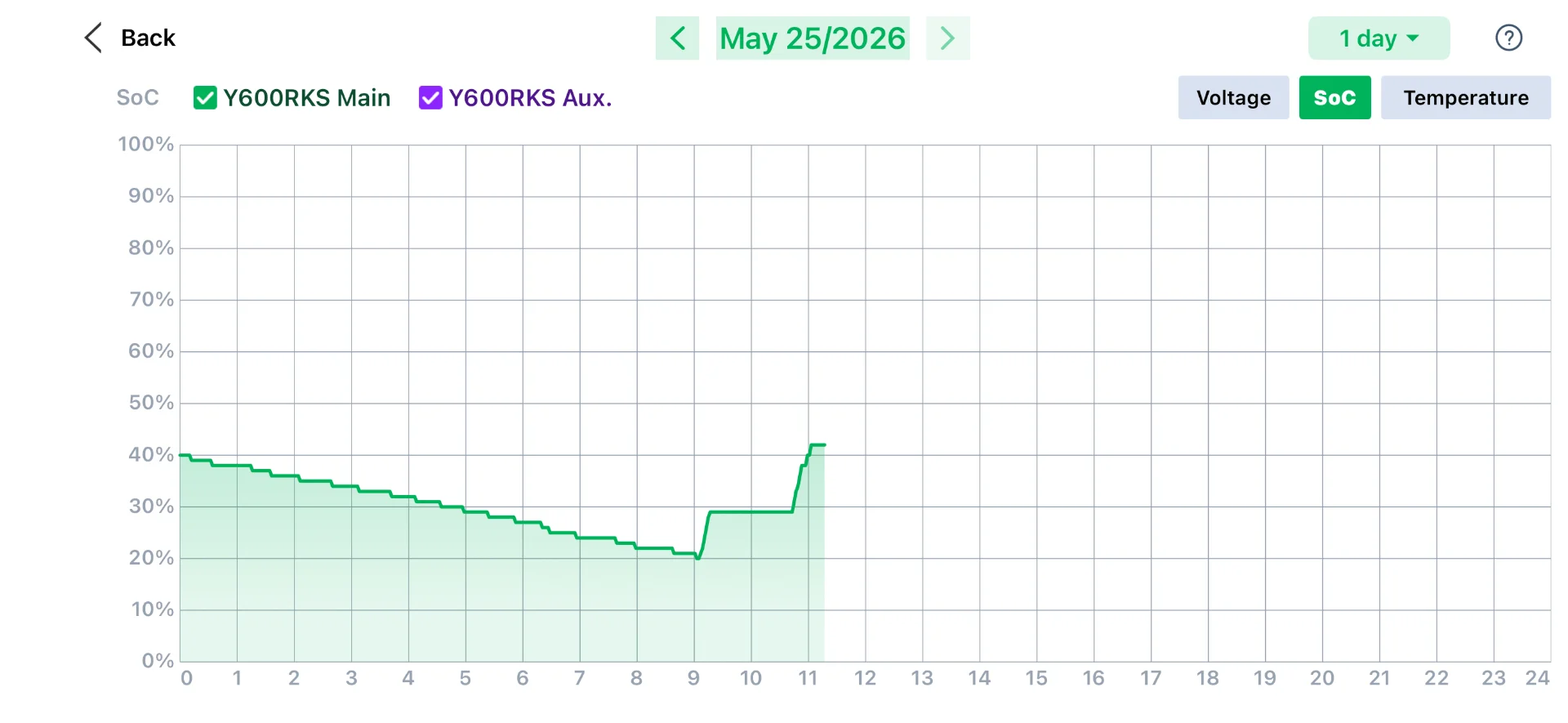

Loaded the dogs into the car this morning, as I got in there was a 'low battery - start engine' warning on the dash, now I'd had the doors open on Saturday morning for about 20 minutes, but that shouldn't have caused any issues as the cars BMS (Battery Management System) is quite good at shutting stuff down if the battery terminal voltage drops.

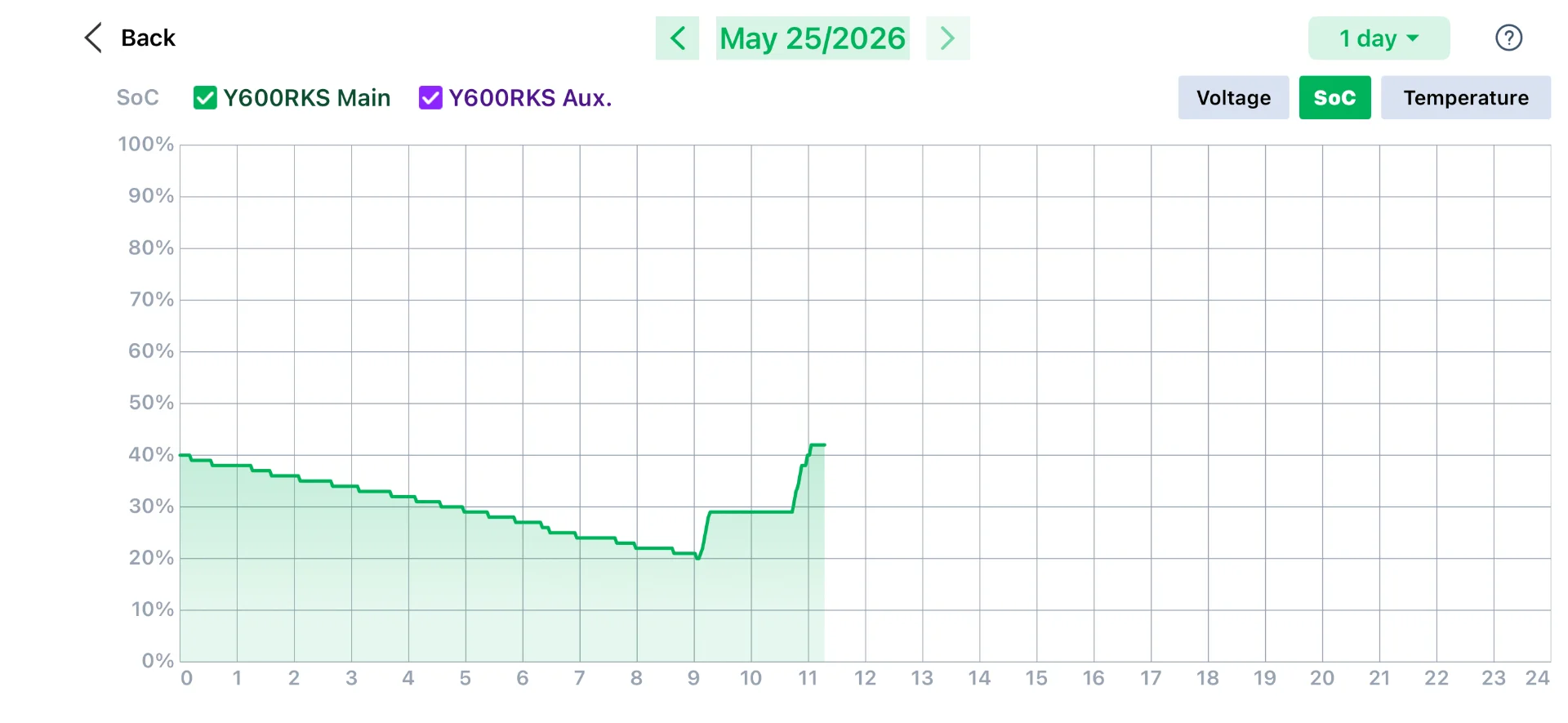

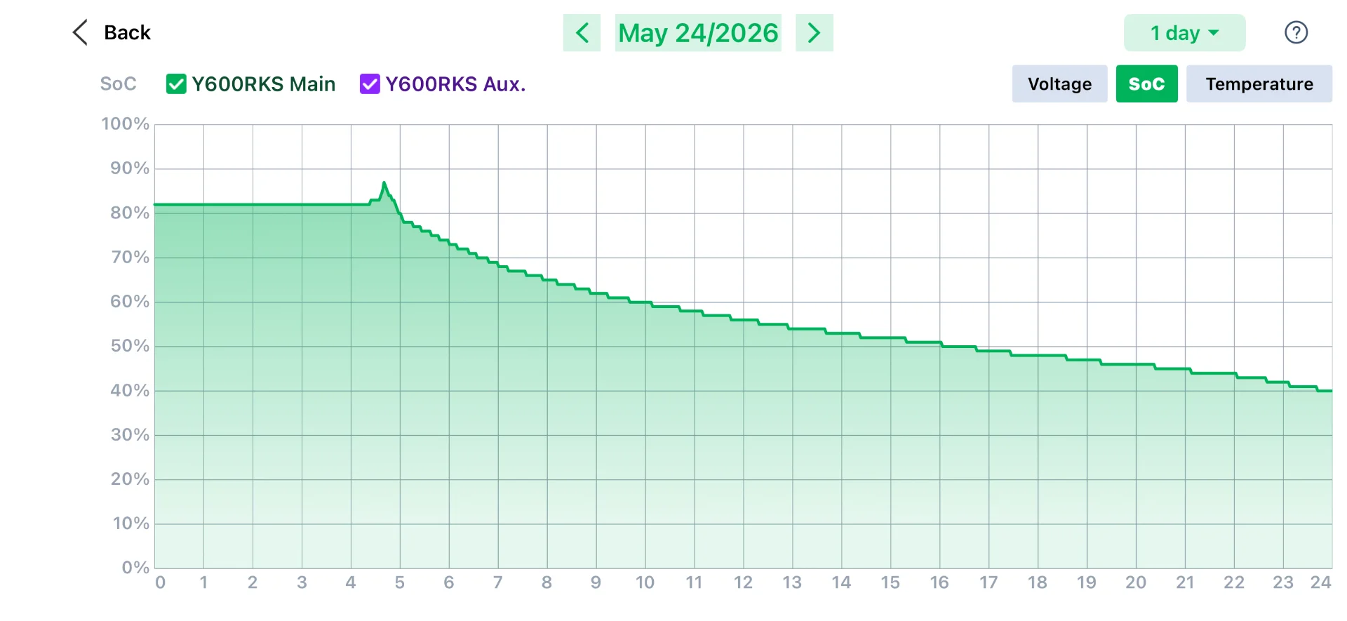

I have a battery monitor connected to the car, which on later checking shows this:-
And this from the previous day when the car wasn't used
Which is odd....

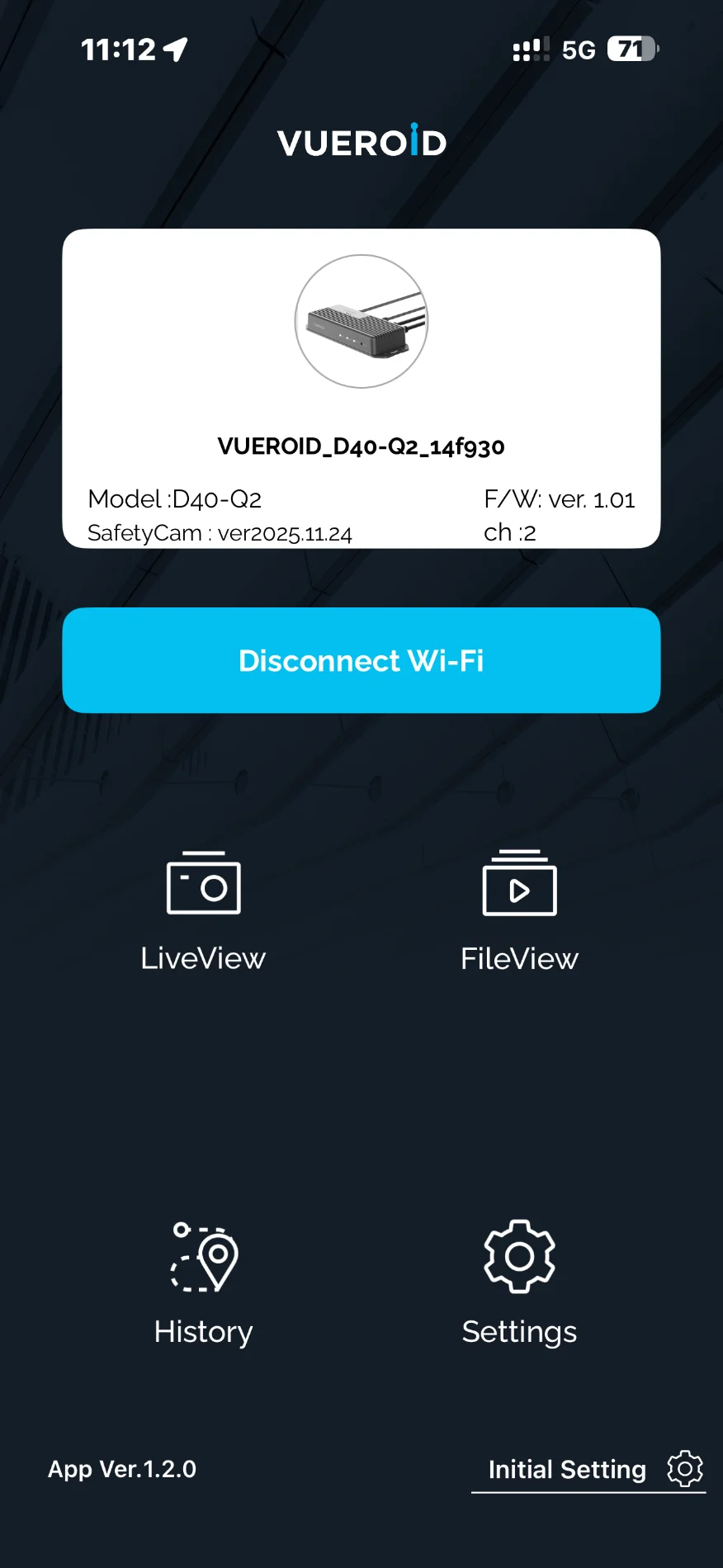

Connected to the car OK but the settings page is blank
The front page of the app is OK and I can connect to live view, Initial settings & recordings OK
The phone software recently had an update but I'd not had cause to visit the settings page for a long time

This is the typical quiescent current draw on a working day, the overnight draw is 'normal' and attributable to the camera - purely because the daytime has no current draw as the parking location is geofenced, which in turn shows it's not the vehicle drawing the SoC down.
Which is odd....
View attachment 91638View attachment 91637
