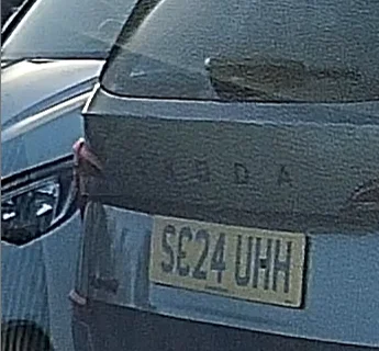

AI Features (post-process options available through HUB app or PC Viewer, not applied in real-time):
  • Licence Plate Restoration

  • AI privacy and licence plate restoration features are promising but need further development
    • Vueroid have only just started training their AI model on UK licence plates (I am submitting videos for analysis)

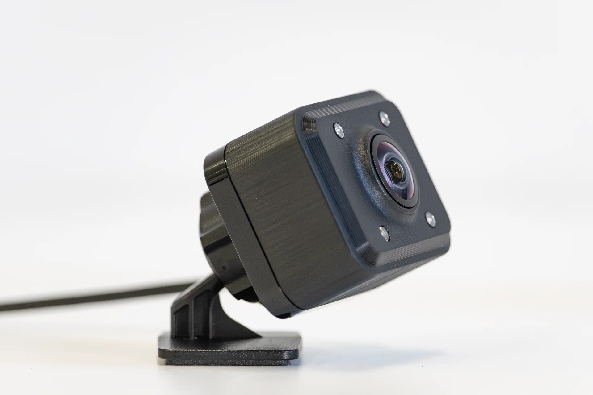

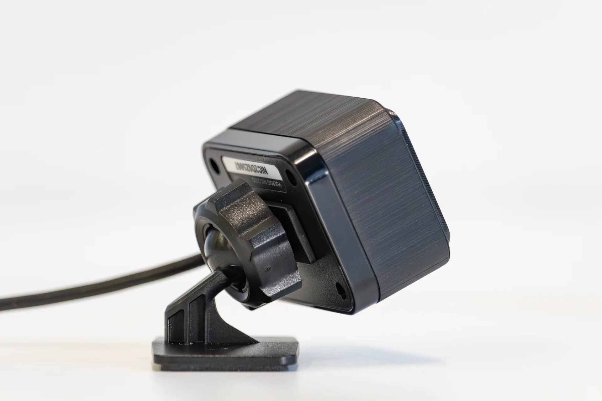

REAR CAMERA
The rear camera is wedge design, with a similar style as the front camera including a chrome ring around the lens, but without the security LED.
There is no CPL filter available for the rear camera, however the rotating lens housing is a flat rectangle so for anyone interested in a DIY solution something like the Viofo CPL-300 might work with a spacer on both sides.
The range of up/down angle adjustment is not as wide as seen on other cameras, especially barrel-style cameras:
- The furthest down position is parallel to the mount, i.e. parallel to the glass surface
- The furthest up position is approximately 20° down from perpendicular to the glass surface, so it may not work on vehicles with a vertical rear window. EDIT - The wide FOV of the rear camera allows it to work well on a vertical rear window.
The rear camera has a captive pigtail cable approx 30cm long with a female socket on the end. The 6m rear camera cable plugs into this in-line socket.
I'm not a big fan of this arrangement for installation on a rear hatchback window. The splice is in an awkward location for feeding the cable through the flexi rubber tube into the void above the roof headliner (one of my other rear camera cables follows this route). Currently I have the cable hanging from adhesive clips into the rear trunk area.

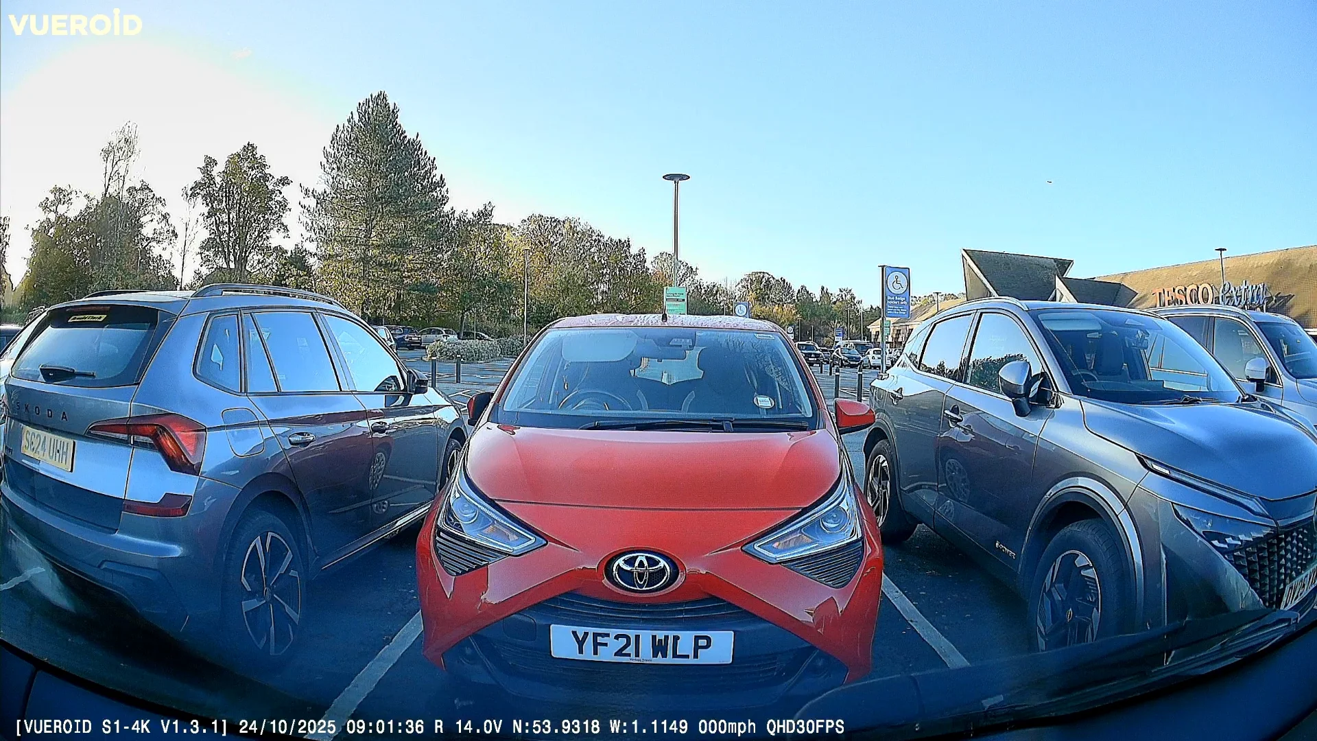

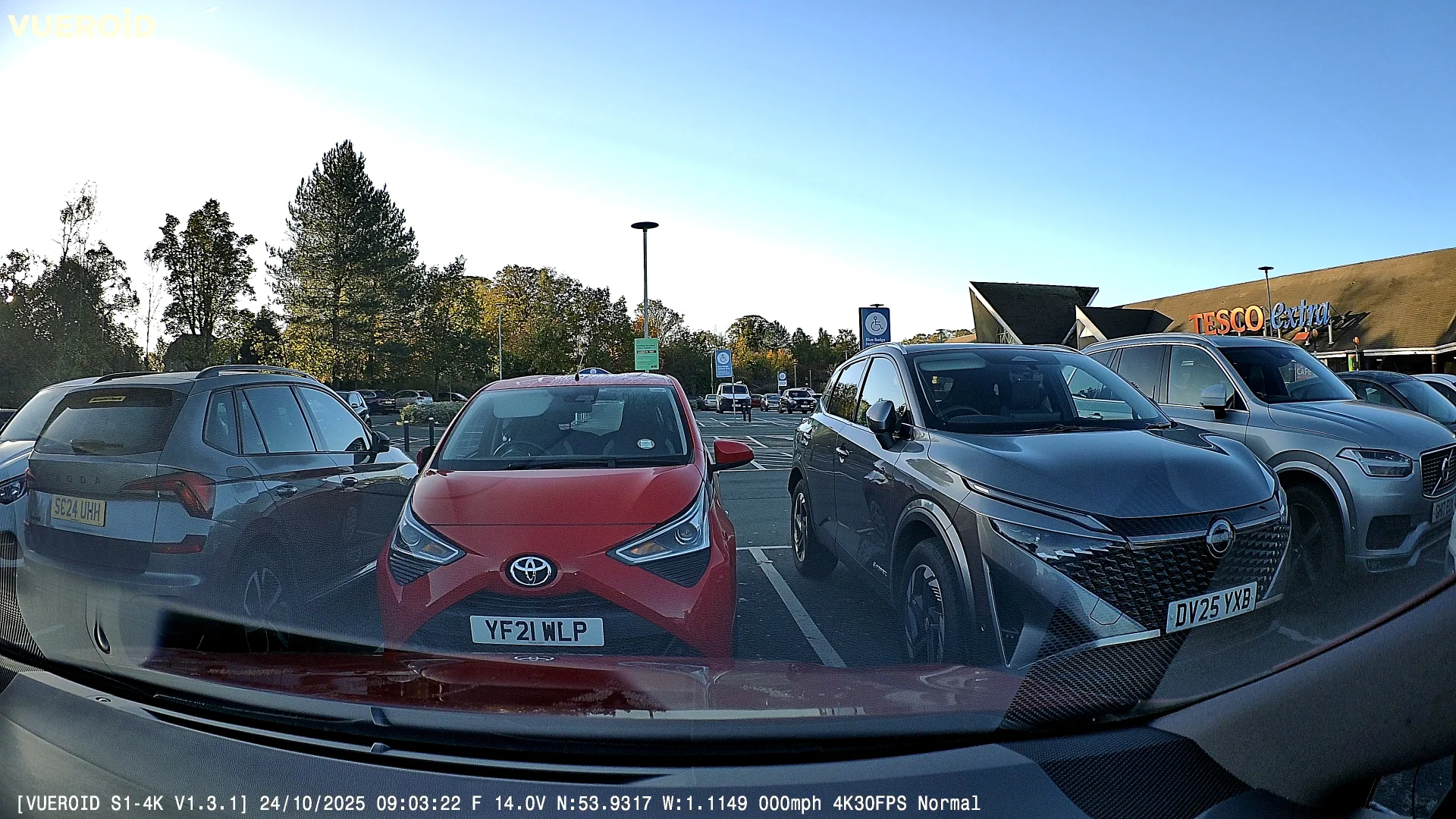

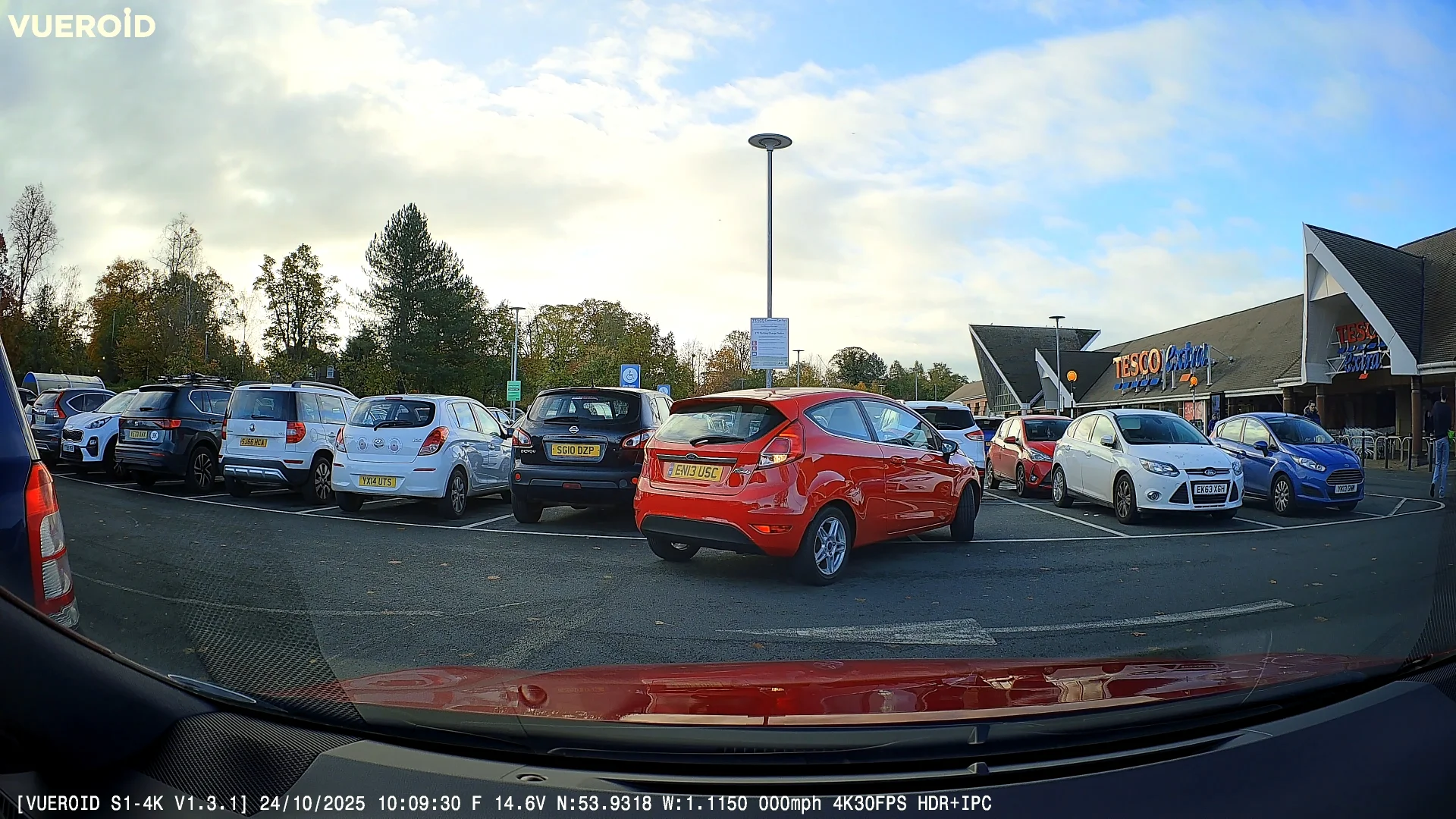

Vueroid have chosen a high-quality lens for the front camera that has a wide field of view and is also very sharp across the entire frame.
With the Video Enhancing option set to "Normal" the dynamic range is very good, colours are under-saturated. There is some noise/grain present, but I would rather have this than lose details to noise reduction.
With the Video Enhancing option set to "HDR+IPC" the dynamic range is excellent, colours are punchier and more representative of the actual scene. HDR processing appears to remove the noise that is present in the Normal video.
Note that the pair of S1 4K in my car are on the left and right side of the rear view mirror, so their alignment is not exactly the same.
(HDR+IPC on the left, Normal on the right, CPL off)

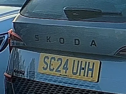

100% crops of left, centre and right of the "Normal" video:
100% crops of left, centre and right of the HDR+IPC video:

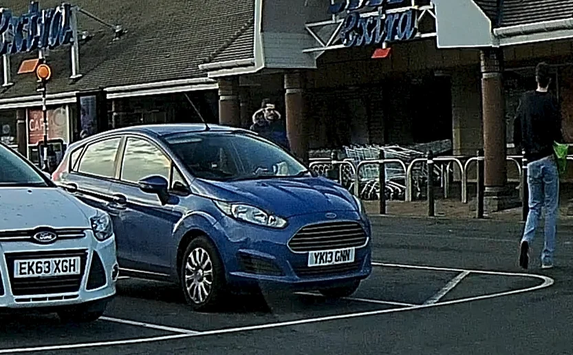

The same car park 1 hour later, with a CPL fitted to both cameras. I parked here to inspect the detail on nearby cars & people at greater range than the examples in the post above.
Left side (HDR+IPC / Normal):
Centre (HDR+IPC / Normal)
Right side (HDR+IPC / Normal)
Very nice comparison shots Tony!
HDR+IPC does look like the better choice regarding color accuracy and noise.
Yes, HDR (or HDR+IPC) perform better than Normal for static videos like these.
That's not the full story though. My daytime preference when driving is Normal due to the way it handles moving subjects, especially in low light.
I prefer enabling HDR in parking mode.
Personally, I find the color accuracy better in Normal mode. This mode shows you exactly what you see, without embellishment.
Using the "HDR+IPC" setting, colors become brighter and more saturated. More artistic.
Compare photos 3 and 4 in my post linked below.
Although maybe there is something wrong with my eyesight...
I agree that colour accuracy is better in Normal mode, however I would like to see the saturation increased a little bit because at the moment it does not match what I see.

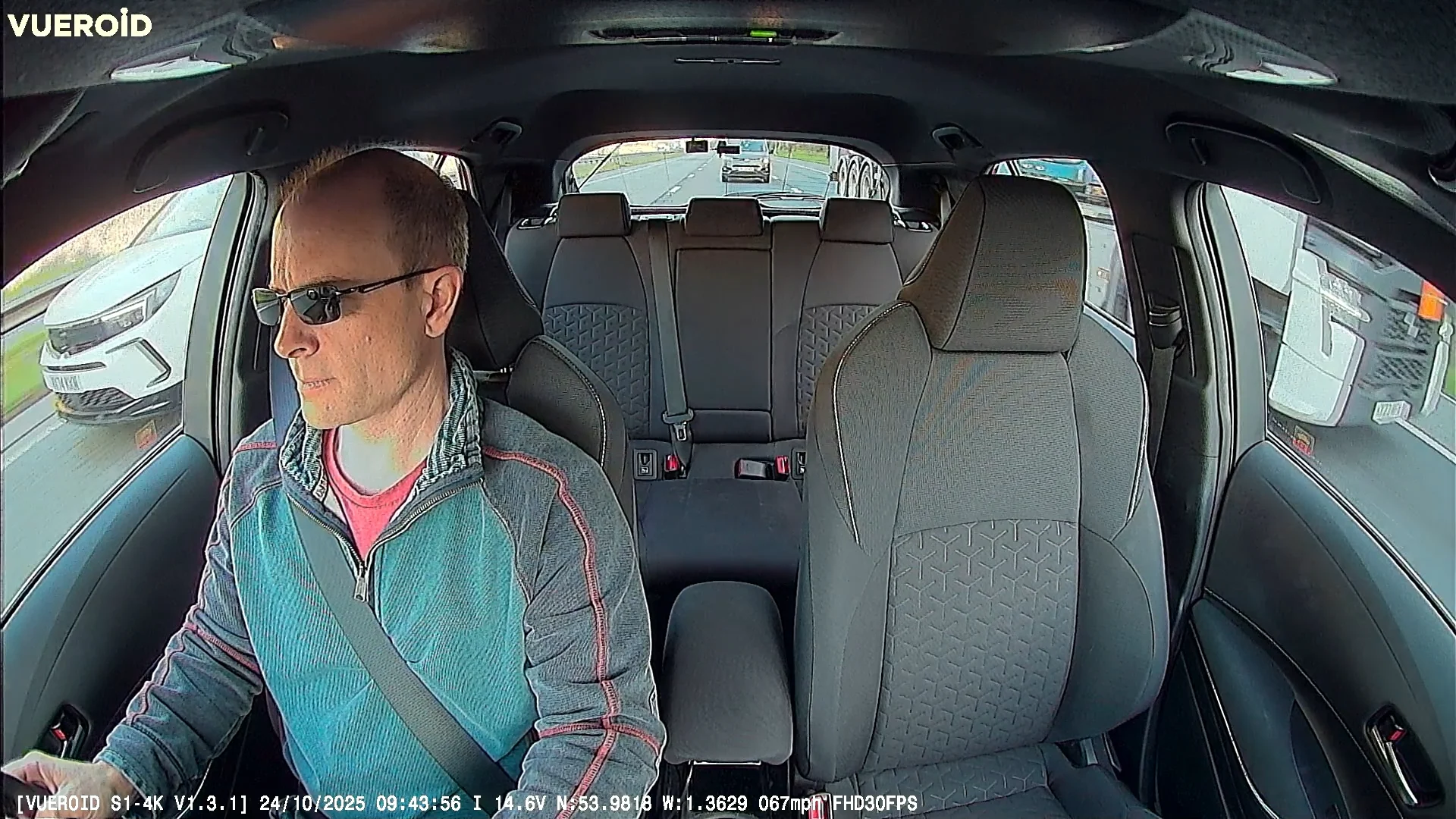

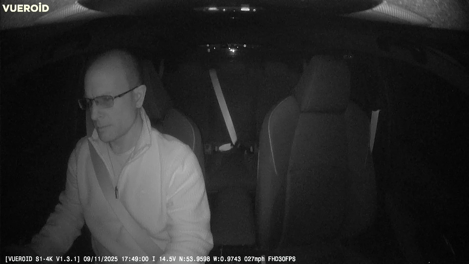

The interior camera has a useful wide FOV of 170° with low distortion.
The always-on HDR works well to show both the car interior and what is happening along both sides.
The wide coverage is useful when driving on multi-lane roads, showing the blind-spot on both sides to complement the rear camera view.

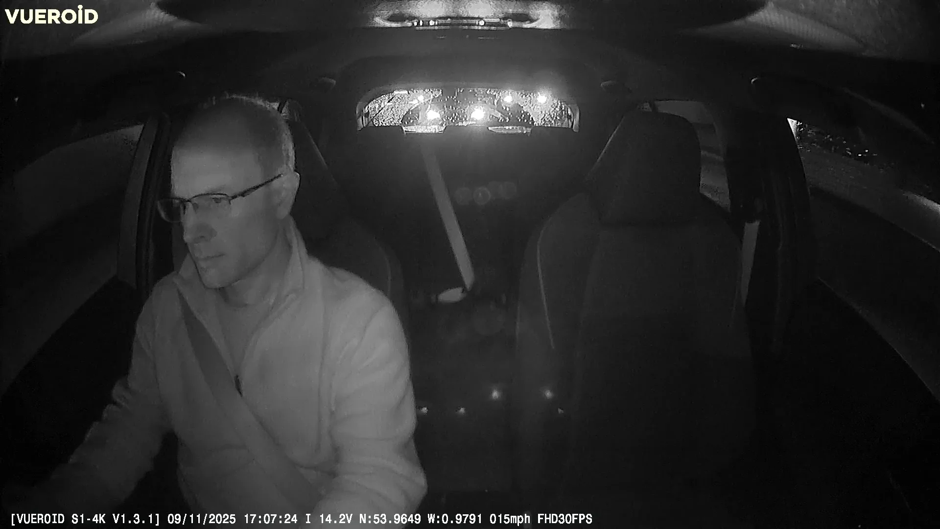

When driving at night the 3No IR LEDs are bright enough to illuminate the driver and passenger, but the rear seats are rather dark even in my compact car.
Night capture in a well-lit car park
Despite the glare from headlights through my untinted rear window, the HDR has maintained a decent exposure within the cabin.
Yes interior footage look adequate to me, being the kind of person that do not feel like he would have a big need for something like that.

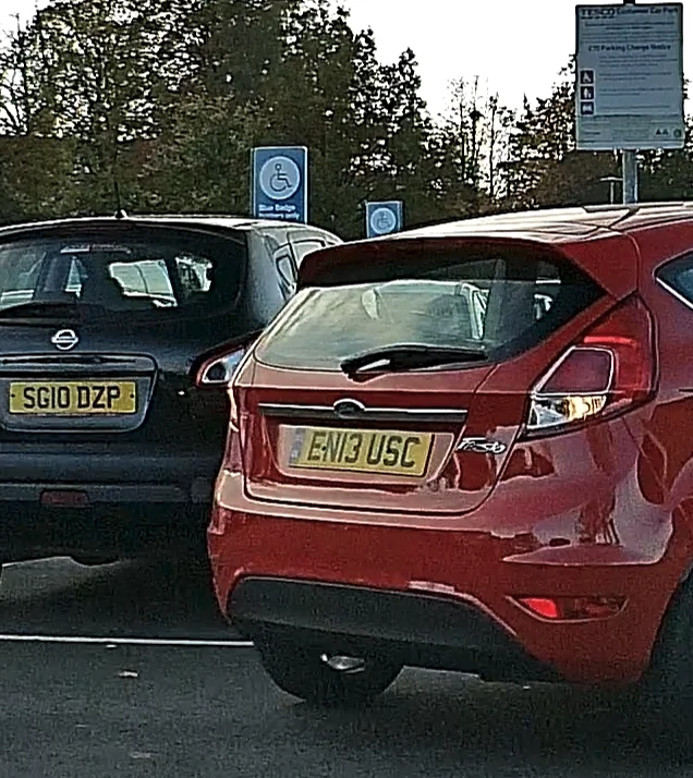

Comparing the rear cameras of the S1 4K and the Viofo A329S shows the wider FOV of the S1 camera.
This comparison shows clear as day the pro and cons of large FOV.
At first the Vueroid image put me off due to the FOV but when consider the most important thing with a dash cam is getting as much information you can then the FOV makes sense.
Having said that the Viofo looks fantastic.
I know Vueroid said somewhere in here that they could flatten the image or something like that but decided not to.
When i looked at image ( sorry bold won't turn off)
1762775752197.webp. It is looking out the back window there are 2x suv type vehicles and their number plates aren't straight and the second car also has a line along the back that "wobbles" along it. Must be where the lens introduces FOV limits​
Cheers. (Ok bolds off now🤯 lol)
For clarity
This image.
