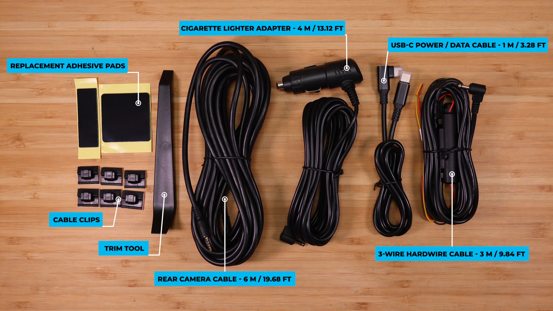

    • Rear Camera Cable
      • The S1-4K Infinite rear camera cable looks similar to the Vueroid D21-4K rear camera cable, but they are not compatible.
      • If you're upgrading from the D21-4K dash camera, you must use the rear camera cable supplied with the S1-4K Infinite [6 M / 19.68 FT]

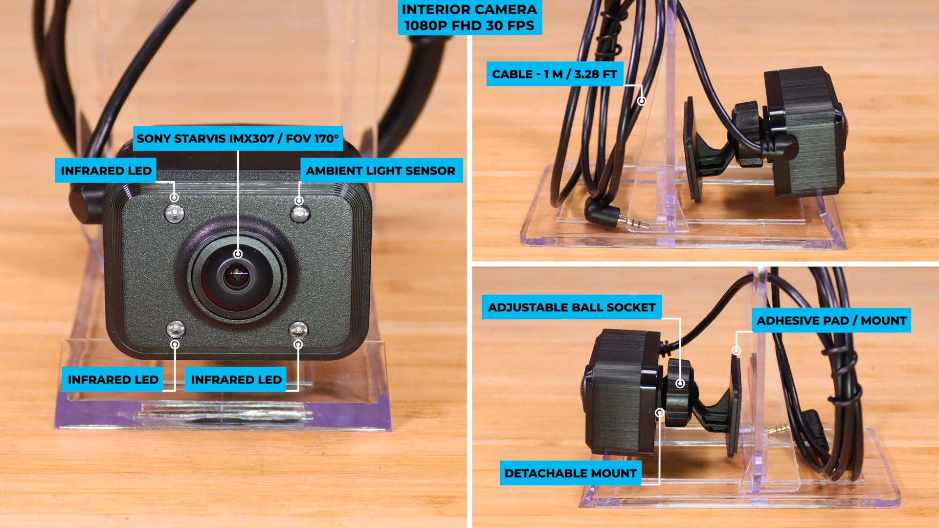

  • Interior Camera [3-Channel configurations]
    • Resolution: 1080p FHD
    • Image Sensor: Sony IMX307
    • Lens FOV: 170 degrees
    • CPL Filter Available: No
    • IR LEDs: Three are used to help illuminate the vehicle's passenger compartment at night
    • Ambient Light Sensor: Yes

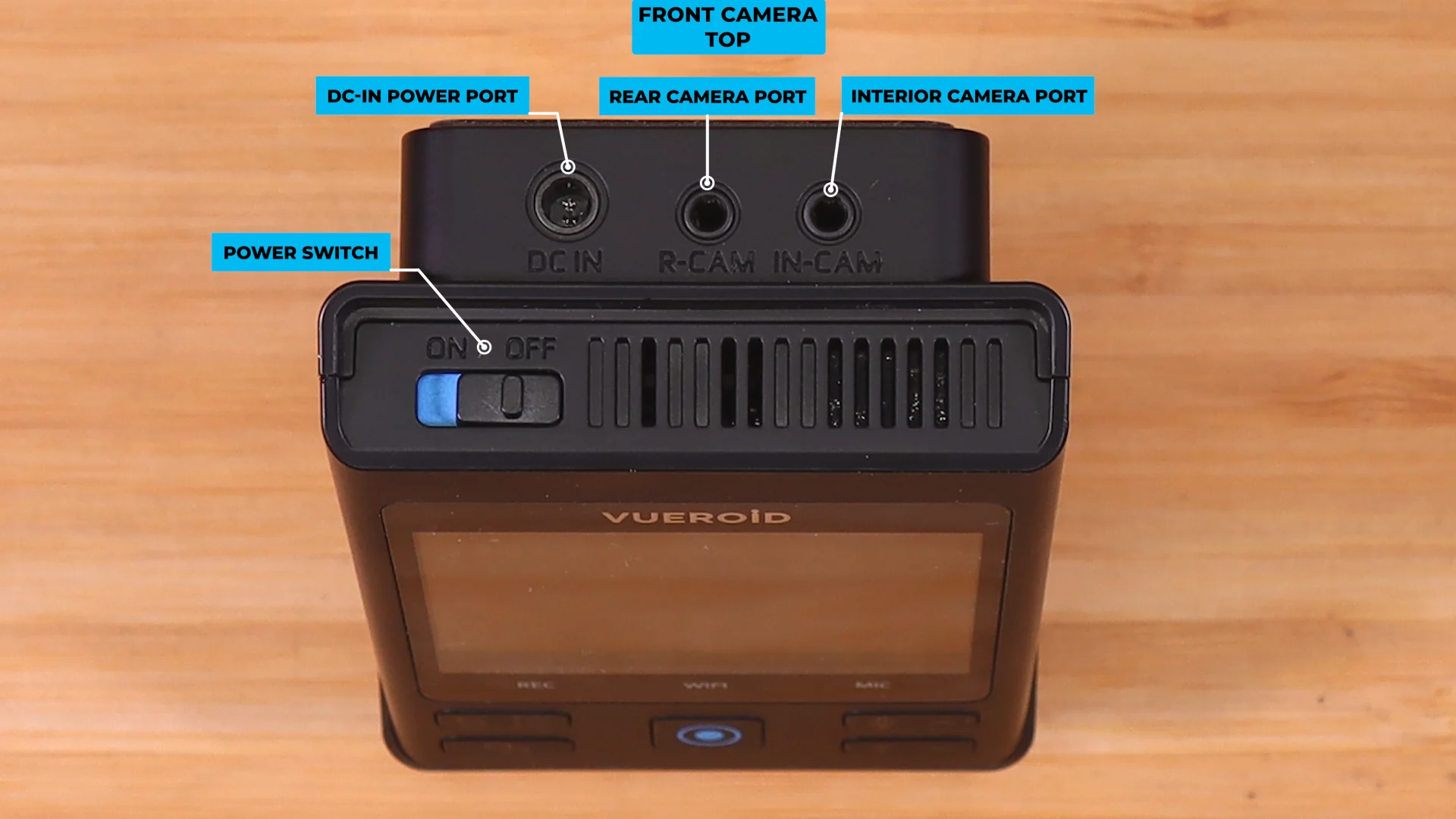

  • Power Options
    • The S1-4K Infinite is designed to not need an internal battery or supercapacitor
      • The TFF system [see above] is how this dash camera handles power loss events [when / if they occur].
    • 12V/24V
      • Included cigarette lighter adapter [CLA]
      • Included 3-wire 12V/24V hardwire cable [required for parking mode operations]
    • 5V
      • The USB-C port on the side of the front camera case can be used to power the front camera
      • This power source will not support parking mode operations

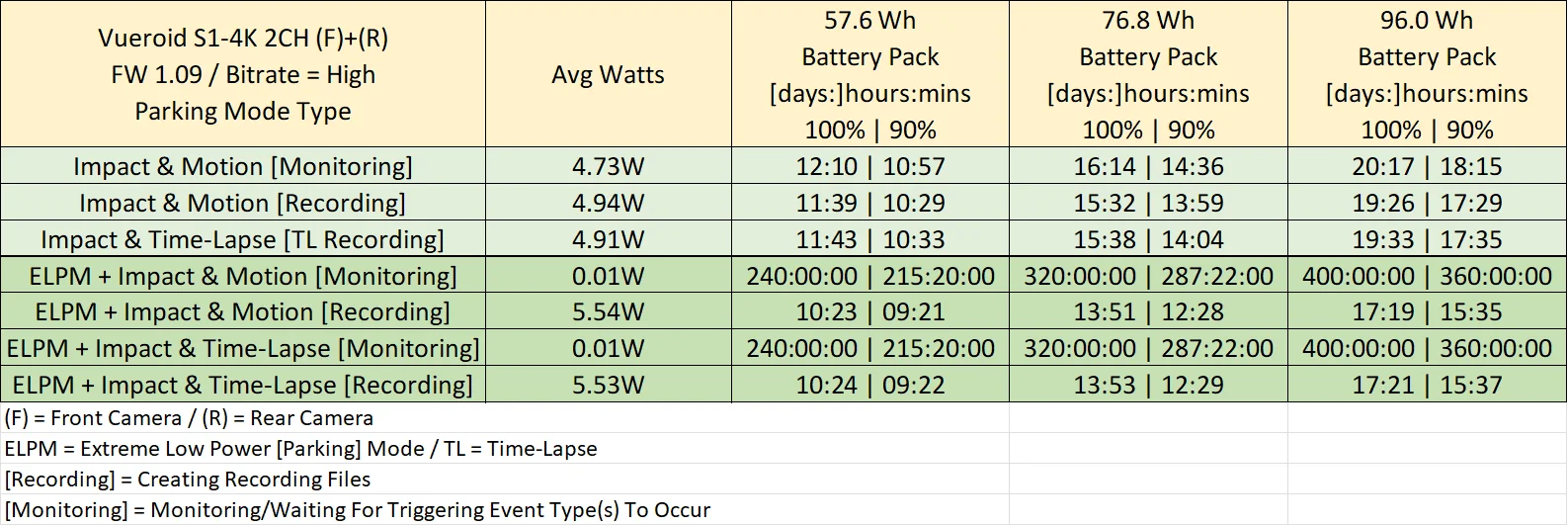

Power Consumption In Parking Mode & Time Estimates
The two most common configurations for the S1-4K are anticipated to be the 2-channel [front+rear] configuration and the 3-channel [front+rear+interior] configuration. I have limited my power consumption testing and time estimates to those two configurations.
The S1-4K has a low voltage cut-off feature along with a time based cut-off feature for parking mode. The lowest low voltage cut-off value available is 11.0V to be used when the S1-4K is powered by a dash camera battery pack. Based on several tests of dash camera battery packs, they usually will provide power to the dash camera into the mid to low 10V range. This means the dash camera battery pack's internal storage charge will not be fully depleted by the S1-4K, thus not truly consuming 100% of the battery pack's full storage capacity.
I have included a 100% time estimate column and a 90% time estimate column in my parking mode time estimates. The 90% time estimate is far more likely to be "closer" to what you may see in real world usage. There are other factors that can impact the dash camera battery pack's storage capacity as well [temperature, internal power use {Bluetooth for app monitoring}].
With regard to the ELPM time estimates, it is hard to be confident in such long time estimates for that parking mode. ELPM draws only 1 mA @ 12.6V [0.01W] which makes the calculation for the total runtime to be quite long. As I mentioned above, the battery pack itself will not always provide the full storage capacity for long time periods. If the battery pack has very little internal power drain/draw, it should definitely last a long time, but not the 360 to 400 days as the math calculations project. There's just no realistic way to give a fully accurate time estimate when the power draw amount is so low and the power source's [battery pack] storage capacity may change due to issues not related to the dash camera power draw.
ELPM allows this dash camera to be used with vehicles without a dash camera battery pack. Just make sure the low voltage cut-off feature is set to a realistic voltage value that will not leave your vehicle inoperable.
The "Waiting" values are the absolute "best case" situation for that parking mode. The dash camera is waiting for the "triggering" event(s) for that parking mode. The "Recording" values are when the dash camera is busy handling a triggering event for that parking mode type. The "Recording" state should not be the most active state for that parking mode, but it could be a highly used state for that parking mode [especially for motion detection]. If the "Impact" triggering event is the most active state for a parking mode, that vehicle might need to be moved to save it from destruction of that many impacts 🙂or the sensitivity setting needs to be adjusted or they're false positives.
S1-4K 2-Channel [Front+Rear] Parking Mode Time Estimates

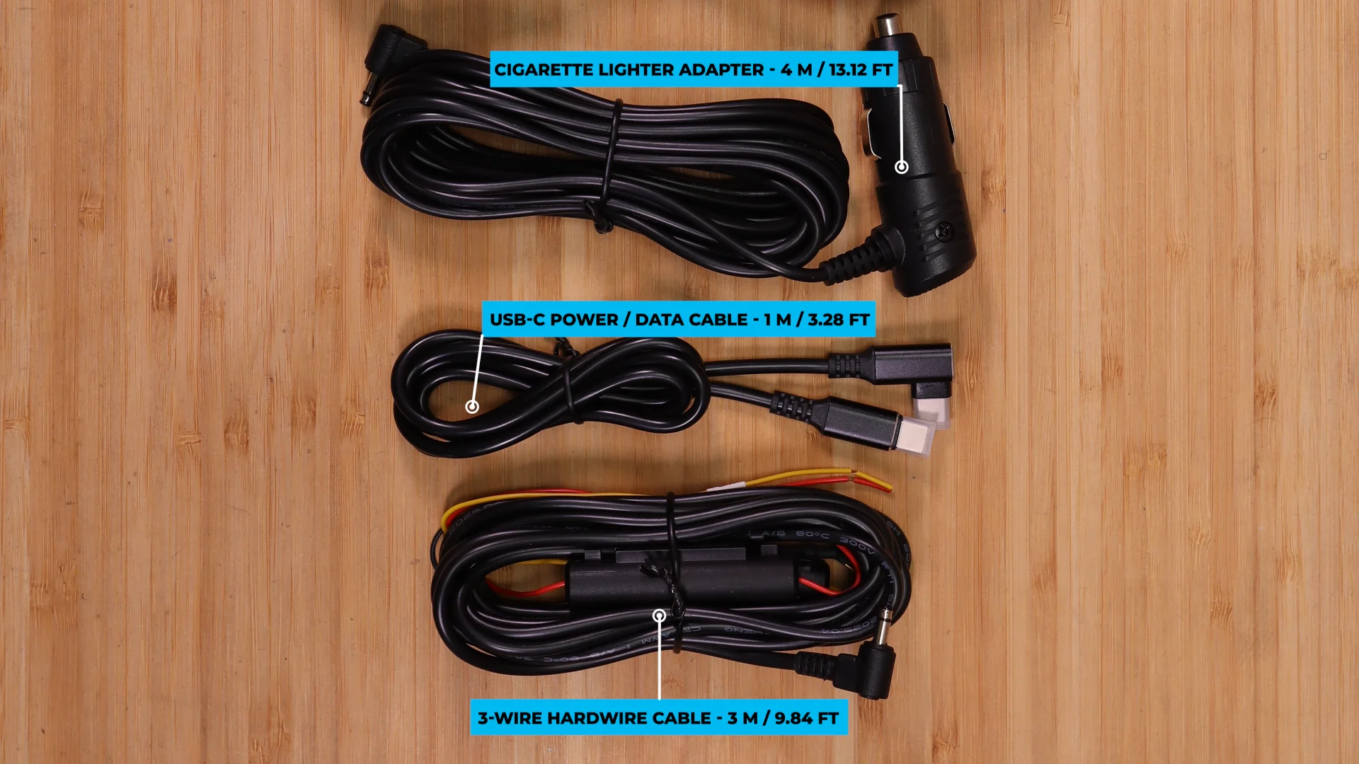

S1-4K Power Cable / Source Options
What cables / power adapters are in the box:
DC-IN Power Port
3-Wire Hardwire Cable - Connects to S1-4K's DC-IN port
This power option provides full functionality for the S1-4K [driving recording, parking recording including low voltage cutoff monitoring].
The 3-Wire hardwire cable can be connected to the vehicle's fuse box or a dash camera battery pack. Make sure to set the S1-4K's low voltage cut-off setting [Parking Recording > Vehicle Battery Protection > Discharge Cut-off Voltage] to a value that is appropriate for your vehicle or battery pack. There is an 11V setting available which can be used when the S1-4K is powered by a dash camera battery pack to get the most out of the dash camera battery pack's stored charge.
Cigarette Lighter Adapter [CLA] - Connects to S1-4K's DC-IN port
This power option provides limited functionality for the S1-4K [driving recording only].
The CLA should be connected to a cigarette lighter [power] port in the vehicle that has the power turn off when the vehicle's ignition system is turned off. This is to prevent the S1-4K from operating continuously in driving recording mode and potentially draining the vehicle's battery.
USB-C Power - Connects to the USB-C port on the right side of the S1-4K
No USB power adapter is provided with the S1-4K, so the user is responsible for providing a USB power source and cable that will connect with the USB-C port on the right side of the S1-4K front camera. When in the user's vehicle and depending on the S1-4K configuration, the maximum power draw can reach up to 12W [3ch, front+rear+interior cameras, IR LEDs on, screen on, LEDs on, speaker active, etc]. The user must provide a USB power adapter or have a USB power port in the vehicle capable of providing 5V @ 2.5A [minimum]. When used in a vehicle, the user is responsible for providing a USB power cable to provide power from the USB power adapter to the USB-C port on the S1-4K.
Since the S1-4K does not support parking mode operations when powered by the USB-C port, the USB power supply must turn off power to the S1-4K when the vehicle's ignition system is turned off. This is to prevent the S1-4K from operating continuously in driving recording mode and potentially draining the vehicle's battery.
A USB-C data / power cable is provided in the box with the S1-4K with a length of 1M [3.28 FT]. This cable's primary use is for connecting the S1-4K to another USB-C capable device [cell phone, computer, or power source]. USB power sources in the vehicle [native to the vehicle or third party power adapters] must be used with cabling that will support the 5V @ 2.5A power rating.

I added parking mode descriptions and power consumption / time estimates to post #2
When operating in 3-channel mode [with rear and interior cameras] the rear and interior cameras will record at 15 FPS while the front camera records at 60 FPS
Sacrificing rear and interior FPS to 15FPS just to have 60FPS on front. It is not Vueroid fault, but people asking for the useless 60FPS as demonstrated by @Vortex Radar
I think all your values of hundreds of days are for the situations where no impact is detected. But if (false) impacts will be detected, the camera will draw power and reduce the number of days.
In theory, your calculations are correct because if somebody hit your car it is expected that until that moment nobody else to hit your car. So you will have only one impact video which will not affect that hundreds of days. Only if no other cars will hit your car again. You can be too unlucky to find 10-20 impact videos during that 184 hours of parking... Or if you mounted... a very powerful magnet on your car.
The biggest problem of impact files during parking mode is which impacts should be stored? Impacts from accidents with other vehicle? I think this is the situation offered by the manufacturers: collision by other vehicle.
You want your camera to detect small impacts in the supermarket parking or if keyed? Most of the people will want to have recorded such situations. But if the manufacturer will offer such sensitivity of the G-Sensor there will be so many false impact videos.
This is why I consider that the power saving mode should be used only as an extension of your normal parking mode. For example let the camera to record for 48 hours in normal parking mode and if you were parked 56 hours, in that time from 48 hours to 56 hours to have enabled the energy saving parking mode and pray nobody will hit your car, or to gentle hit your car and not have the evidence.
In my opinion the ELPM should be never used as standalone. Even you will park your car for a week, give it a chance for example of 48 hours of normal parking mode or until you car battery reaches 12V.
Driving daily should not use ELPM but only if your car battery is very poor.
Yes, I noted the ELPM modes operating in 1 mA [0.01W] mode is with the dash camera "waiting" for an impact event. The real world amount of time a dash camera can be powered by a battery pack is made up by what type of parking mode is enabled [waiting for triggering events] and how many triggering events occur that are handled by that parking mode. That's true for any parking mode for any dash camera, not just the S1-4K and ELPM.
My point about the exceptionally large day projections in ELPM is that no battery pack will maintain a stored charge that only has the dash camera load draining it. There will be some amount of parasitic draw on the battery pack stored charge from the BMS along with any Bluetooth hardware [if present] it has for app connectivity. The amount of battery pack parasitic drain that can occur will vary by battery pack make/model and features. Having a vehicle parked for a 240, 360, or 400 days is not a typical situation and if that is how the vehicle is being "used", it's not likely that the dash camera would last that long in ELPM due to the battery pack issues already mentioned.
