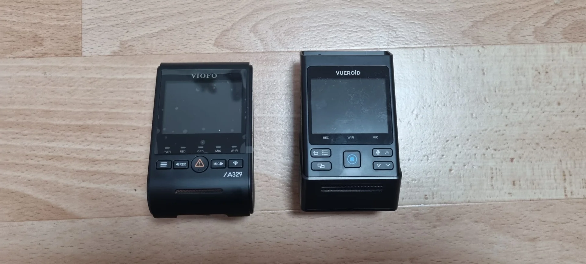

First nighttime outing. Drizzling rain. A few screenshots. Comparison of the S1-4K and A329S.
The S1-4K is mounted to the right of the rearview mirror. The A329S is mounted to the left of the rearview mirror.
No enhancements were used because I haven't figured them out yet.
Since I wasn't planning on making a comparison, the resolution on the S1-4K is 4K 16:9. On the A329S, it's 4K 21:9.
The Bitrate on both models is set to maximum. HDR is set to auto. CPL is set to on.
