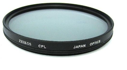

That's a good idea I would just buy a cheap step up plus 49mm CPL on Amazon because if you don't buy cheap you're looking at easily over $50 and with that money you might as well but a better dash cam
I found both parts at a local photo retailer for about 10EUR without VAT.

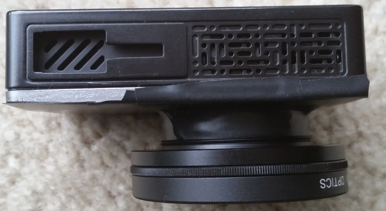

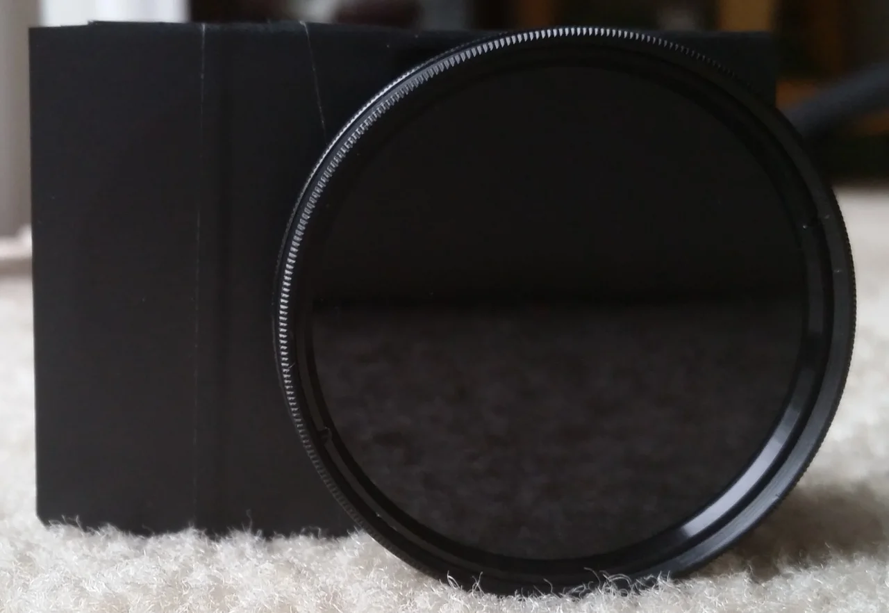

$8 for the stepup ring $12 for 49mm CPL filter. Find on Amazon. I went with generic stepup and generic CPL filter fits like a charm and held by tension. Gonna test drive it when sunny tomorrow and see if it does anything for me in the Vegas sun

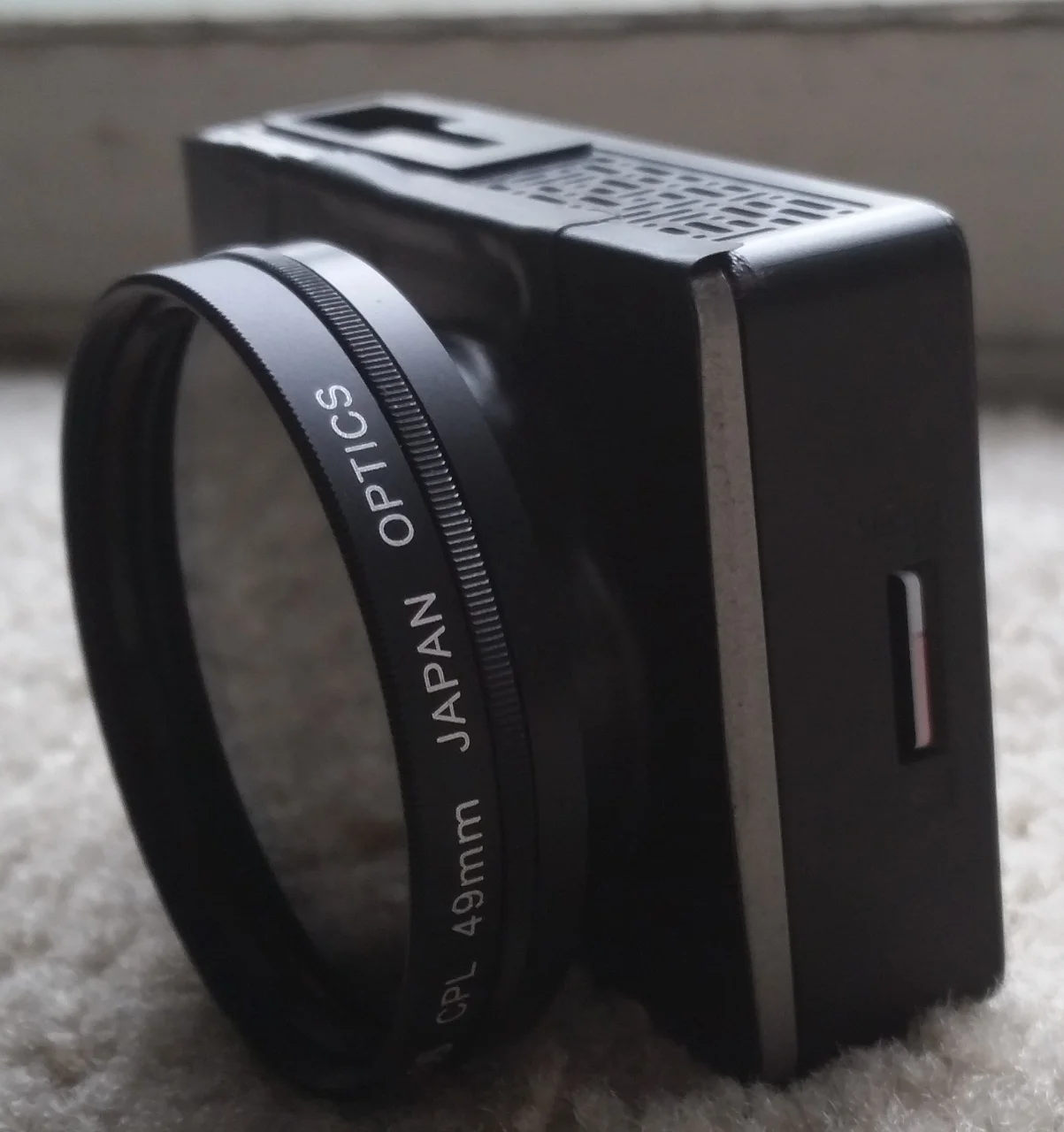

I got the CPL filter from amazon and have it on the front camera and do see less reflection of the dash.

I ordered the exact spec step-up ring and CPL filter but found the fit a bit tight. It was quite difficult to push the ring down 1mm below the lens front. In the end, there were some shadows at the corners.

Lesson learned. The 37-49mm step-up adapter may not work for everyone, it depends on the brand you pick. The term "37mm" means the OD of the male thread on the adapter that is attached to a regular camera lens; the "49mm" means the ID of the female thread that accepts the CPL. In our case we need to fit the ID of the male thread to the Yi's lens housing which has an OD about 34.4mm. Every makes of 37-49mm adapter may have different ID specs on their male thread. The adapter I ordered has an ID of 32mm so I ended up dremel it to 34.5mm to make it fit. So make sure the adapter you order has an ID of 34.5mm on the male thread.
