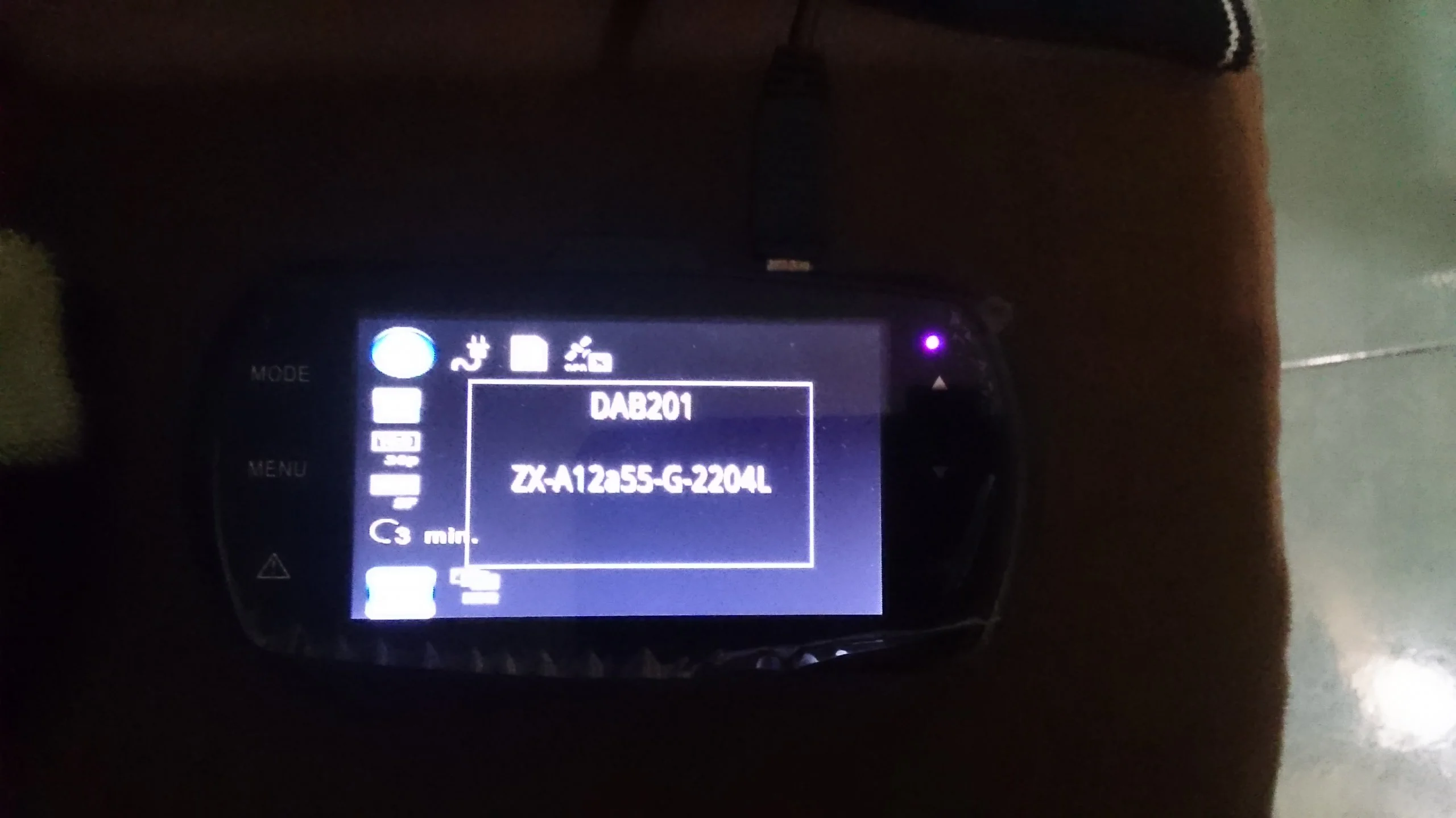

My firmware version ZX-A12a55-G-2204L
DAB201 same problem
1.When start engine my car , display show "Goodbye" and then shutdown every time
2.No detect or long time for detect the GPS signal, km/h not show
Thanks for all krub

Hi njoy_su
Capture Your Action was kind enough to post this latest firmware for the DAB 201 and DAB 202 in another thread. I am using the release below for the DAB 202 now. Works great.
Here are two new Firmware versions for the DAB201 and DAB202. You have the option of MPH or KM/H in the menu. There is one labeled DAB201 and one labeled DAB202. I believe they are the same except how they appear in the firmware section of the camera menu. One will say DAB201 and the other will say DAB202. They should be the same otherwise. I have not road tested these yet.
https://www.dropbox.com/s/7otu8f42tqiqsl7/20160405a_DAB201_A12a55_gps_zhongxing_v2385.rar?dl=0
https://www.dropbox.com/s/0ojxop8dt4fqmxl/20160405a_DAB202_A12a55_gps_zhongxing_v2386.rar?dl=0

I'm sorry,I just use my car today.
//Yes,issue is Fixed.
//No, issue not Fixed.Sometime can't detect GPS
New problem,sometime stop record
I will test it more time,
Thank you for support.
