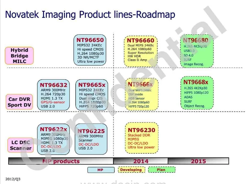

I would guess the Mobius 2 will be based on a Novatek processor. The next generation, the Novatek NT96880 / NT9688x is supposed to have H.265 support.
Thanks for the info @DashCamMan
One thing about Novatek, there are not good to share new information to the public. I can see the roadmap is date back in 2012. I wonder if there is any plan after the end of the year.
Nothing comes up if you google on NT96680 0r NT9668x

Since the Mobius 2 is claiming 1080p a@ 60fps, it might be the NT96663. I believe this is Novatek's flagship chip now and perhaps it will support H.265 (no mention of that though). I haven't seen any cameras based on that chip yet but some are coming out with the NT96660 chip now.
