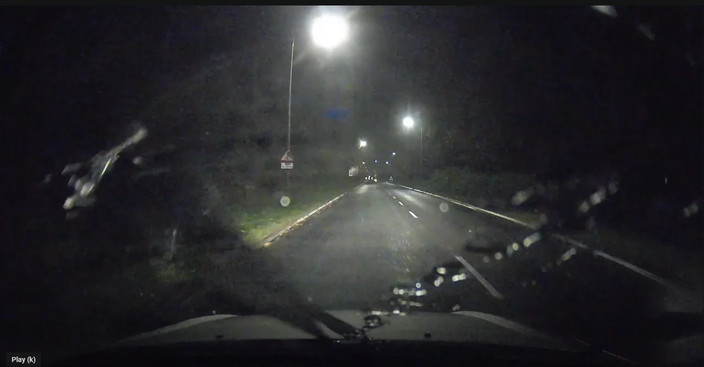

I have some reasonable new (less that 6 months) Bosch wiper blades on the windscreen - but they leave a line of bobbled water on the drivers side about an inch or so from the left end - which of course is right in the view of the cam.
It's annoying - but it must be either the glass, or the wiper.
You can see in the video where these water droplets get left in an arc from left centre going up to the right.
Question - do you techy people think the glass is to blame (unlikely I think (on my Ford Focus)) or should I try an alternative type of wiper blade?

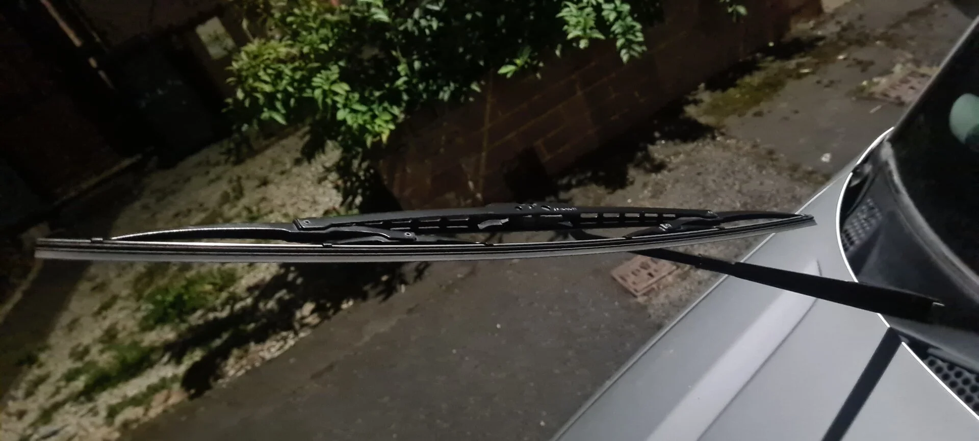

Currently using an ordinary Bosch:
The water shouldn't bead up like that, if it does then it is caused by something on the surface of the glass. Unless you have applied something designed to make it do that, such as Rain-X.

And water always seemed to "bobble" there.
I have applied a very light amount of rain repellent otherwise it would likely look that photo!
The right window wiper blade is not long enough. Are they the correct size, and not swapped over? (Swapping them over is quite a common mistake!)
Normally you can fit longer blades, an extra inch or two might sort that problem. If you decide to go for longer blades then I suggest using the flat ones, since longer standard ones can result in not enough pressure, while the flat ones are much better at spreading the pressure out, and can even be adjusted to increase the pressure in places it is needed most.
Actually, looking again, maybe it is just that the right one doesn't have enough pressure on the end, so is not wiping the water there? In which case, maybe try the flat ones since they give better pressure and you can add extra pressure at the ends if needed, by bending the spring in a little extra.

Looking at the image of the BOSCH blades...I'd suggest changing them, as already suggested, to the "normal"
flat type.
Way too much outward curve in them & they will not apply enough pressure at the ends.

Nice image quality, but the right wiper still looks a little short, doesn't appear to reach the dashcam area?
If the problem isn't solved, then get a longer set and use one for the right wiper, and keep the spares for when the first pair need replacing. They are normally measured in inches, remember that if you are adding an inch to the top end then you need one 2 inches longer. Don't add more than needed, or the amount of PSI (pressure per inch) will drop and it will start to not wipe properly, but the flat ones are much better than the normal ones for that and can also be adjusted to match the curve of the glass by bending the spring a little.
It's 22 on my side but won't take a 24, we tried at the shop.
The cams are all inside the sweep so should be ok hopefully.
