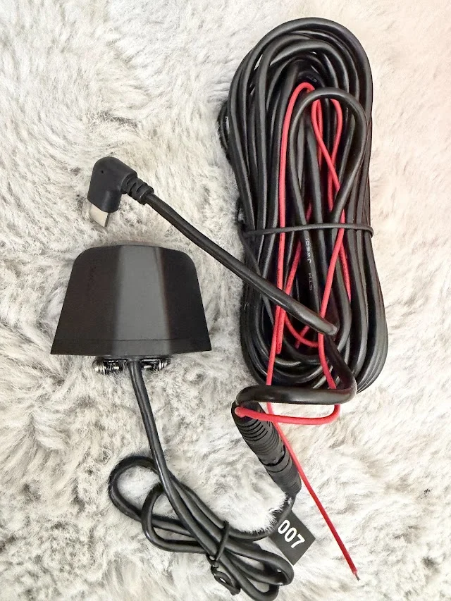

Adding the rear camera and GPS was simple enough. Longest part of the install was just making the wires look clean and hidden. I do wish the GPS was built in to avoid one less cable and attachment to the main unit.
