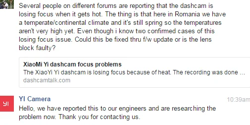

Let's see what answer i'll get from them.
