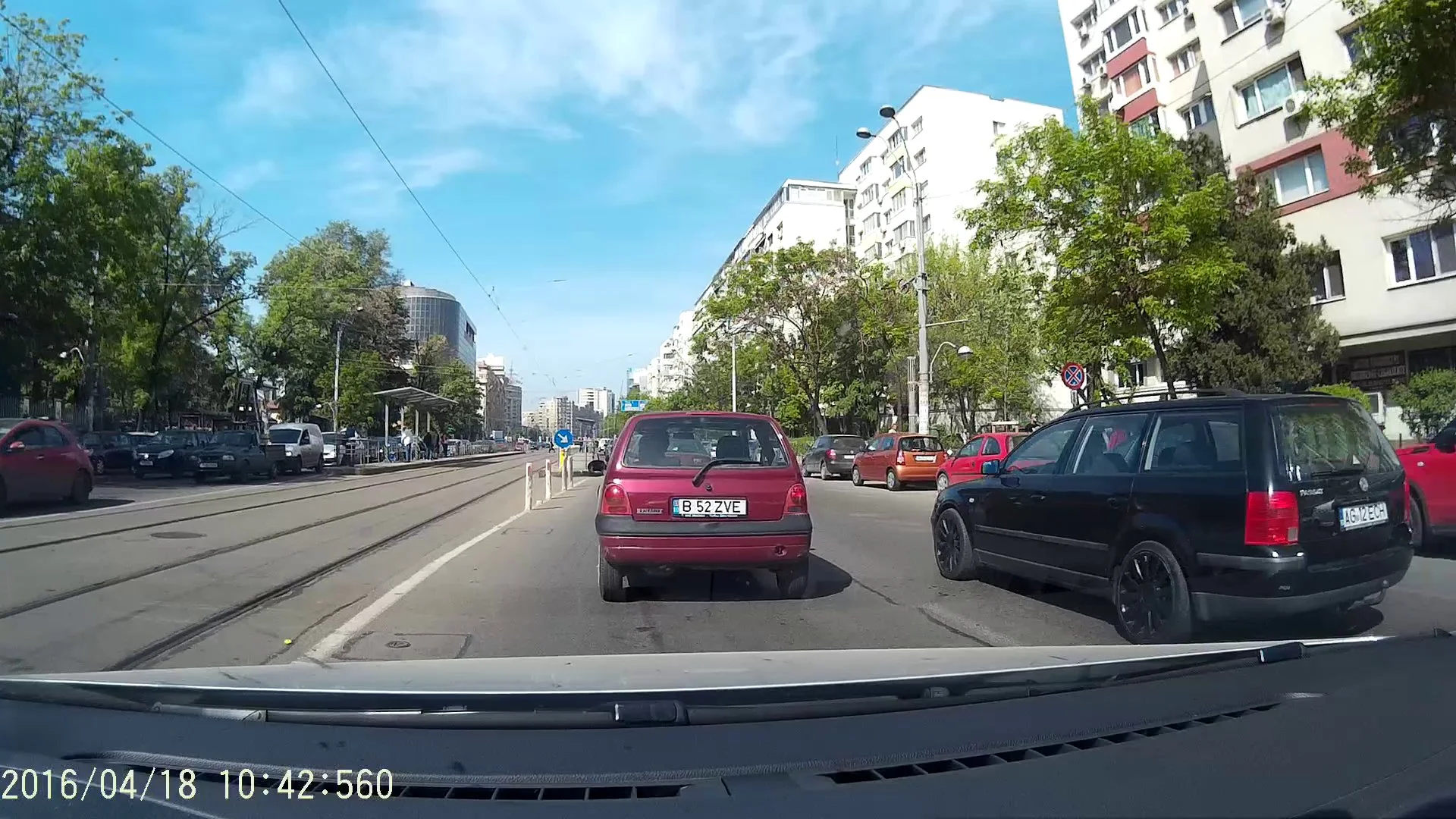

I can confirm the out of focus issue.
It is not related to heat inside the car.
I drove 30 mins with AC on directed to the windshield, in a cold day, and after 30 minutes the picture is garbage, you cannot understand the license plates.
I used a SJ4000 together with the Yi and the quality and focus is far better in the SJ.
The focus of Xiaomi is bad from the start compared with the SJ, but after 20 minutes driving it gets worse.
Here are some samples, SJ4000 versus Xiaomi Yi dashcam.
I dismantled the Xiaomi, you have to take the front face out, use a sharp screwdriver, I tried with a credit card and it is not working.
I tried to manually adjust the focus but does not help. Even when the camera was dismantled on the desk, after 20 minutes of working it was out of focus and cannot be improved. So it is a senzor issue, not optical. when it gets hot, it is blury.
I'm very dissapointed about this camera, I waited two months to get it, preordered on GearBest, but I will trash it and buy another SJCAM, I think M10 will be the replacement for this Xiaomi.
