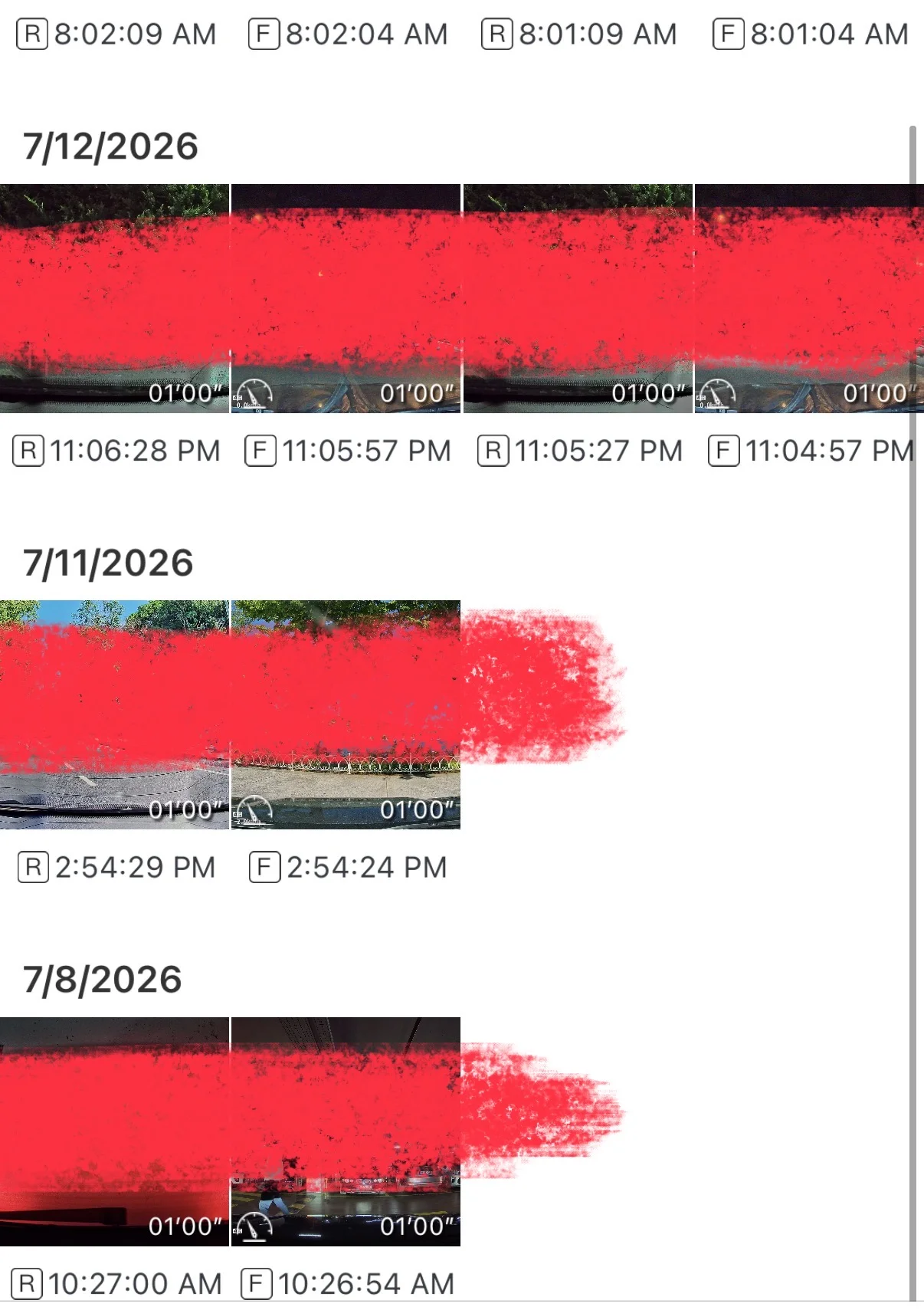

Hi everyone,
I recently purchased a DDPAI Z90 Master with the RC5 rear camera from Amazon US, and I’m experiencing two issues. Both the dashcam and the RC5 are running the latest firmware.
Issue 1 – Front and rear camera synchronization
The front camera starts recording immediately after the dashcam powers on, but the RC5 rear camera consistently starts recording about 5–6 seconds later.
Because of this:
  • Every front and rear video pair is permanently 5–6 seconds out of sync.
  • This is not just a timestamp issue. The actual video content is delayed by about 5–6 seconds as well.
  • The delay starts when the camera powers on and remains the same throughout all recordings.
I have already tried:
  • Updating both devices to the latest firmware.
  • Factory reset.
  • Reformatting the microSD card.
  • Rebooting the camera multiple times.
The problem remains exactly the same.

Hello,
Thank you for your reply.
I have already completed the steps you suggested:
  • Connected the dashcam to the DDPAI app.
  • Updated both the Z90 Master and RC5 to the latest firmware.
  • Unplugged and firmly reconnected the RC5 cable.
  • Performed a factory reset.
  • Verified that my SanDisk High Endurance 256GB U3/V30 microSD card is detected correctly.
Unfortunately, the issue still persists.
However, I discovered an important clue that may help identify the problem.
The synchronization issue only occurs during the very first recording after the dashcam powers on.
When the vehicle starts:
  • The front camera starts recording immediately.
  • The RC5 rear camera starts recording approximately 5–6 seconds later.
  • Because of this, the front and rear recordings remain permanently 5–6 seconds out of sync.
However, if I stop the recording and let it start again (for example, by entering and exiting the Album using the buttons on the dashcam, or through the DDPAI app), both the front and rear cameras start recording at exactly the same time, and the recordings are perfectly synchronized.
This makes me believe that the RC5 itself is working correctly. The problem seems to occur only during the initial startup recording sequence, where the rear camera is initialized or starts recording several seconds later than the front camera.
Could you please confirm whether this is a known firmware issue related to the startup process, or could it indicate a hardware problem with the main unit or the RC5?
