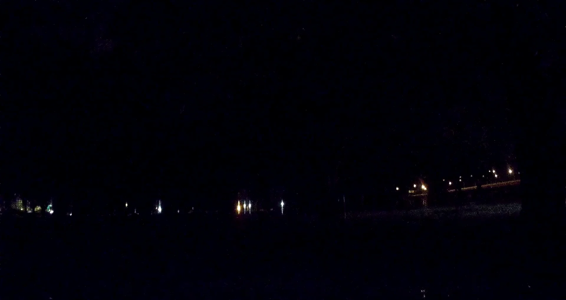

So yes there's a trade off. Being able to see something at night being over bright or nothing at all. I'd rather see over bright because at least I can capture a car if it hits me, even if the license plates are not always readable. The T3 just sees pitch black. Even with WDR on.

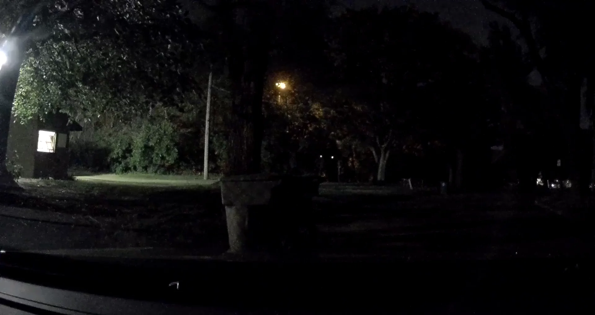

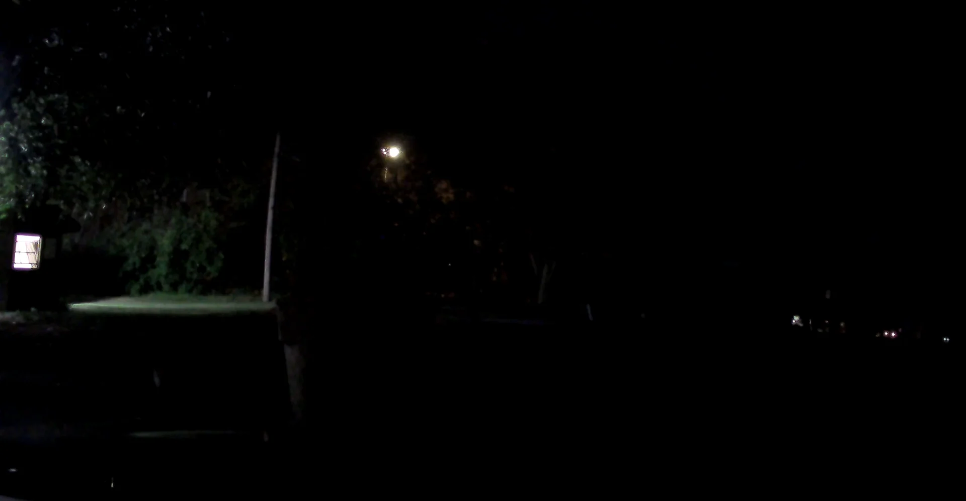

Car Parked in a Dark area at Night. Both cameras in parking mode.
Viofo Image is first. T3 is Second. I even had WDR enabled on the T3.

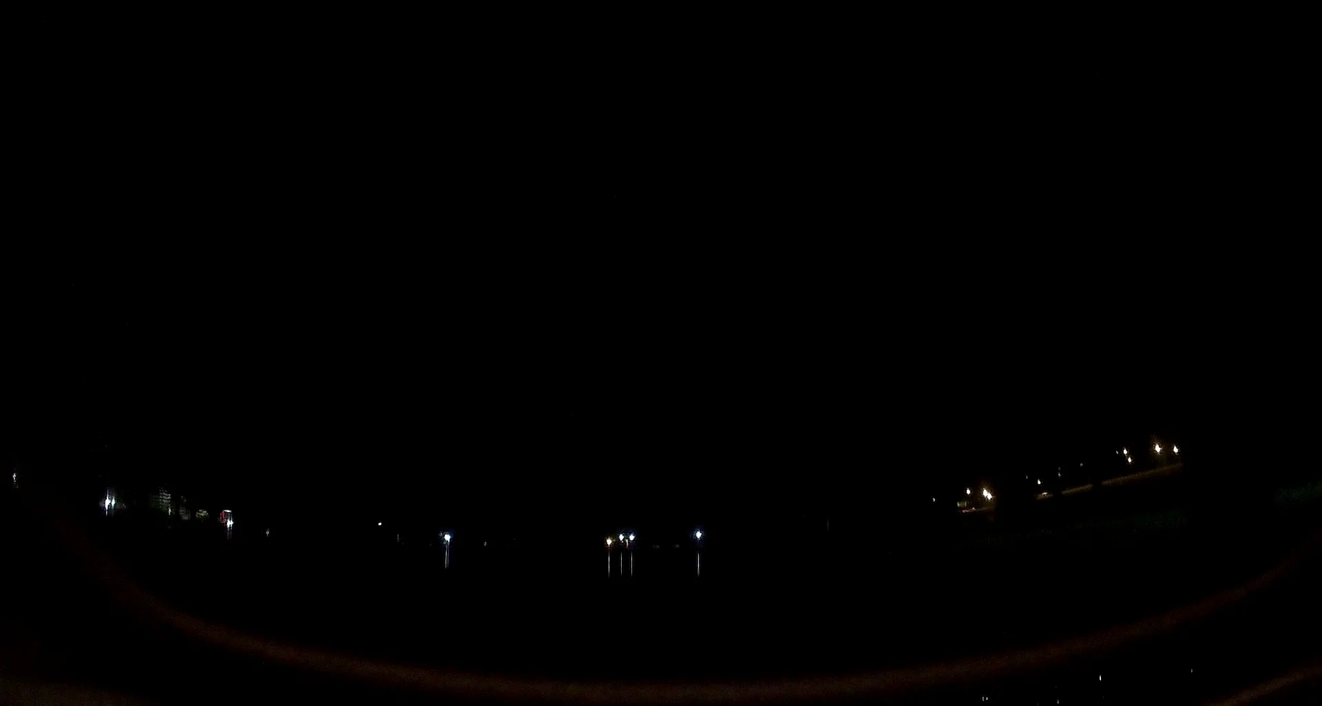

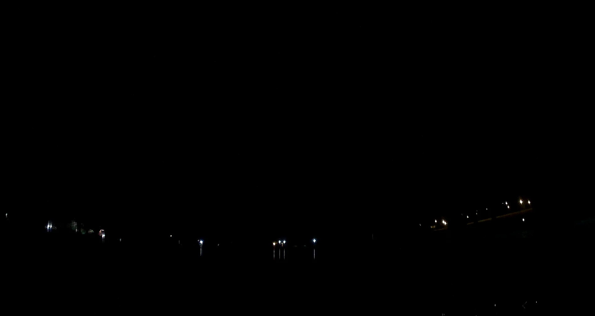

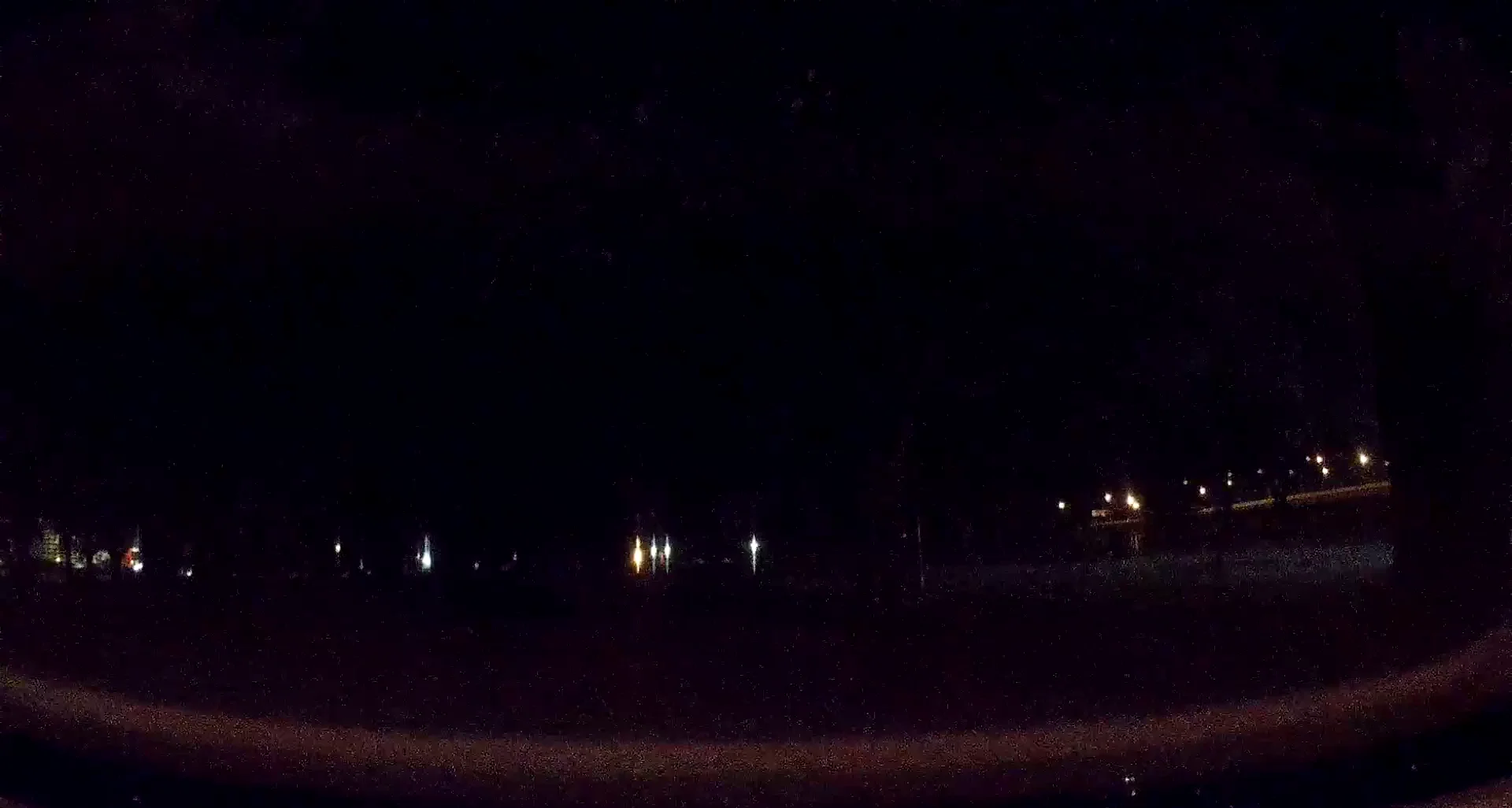

More Images: Viofo images are first two from Rear Camera. My back glass is 20% tint. Meaning 80% light is blocked. Viofo does far better job. You can see the detail of the freeway / highway on the right hand side. The T3 images are much darker
VIOFO IMAGES
T3 IMAGES OF SAME AREA
Yes, it has its limits! But if a car comes along and causes a collision, it will probably have its lights on and then the T3 will have the best image, even in those images, the T3 has the best detail in the bright house window.

What is your problem? I have posted a valid concern and you're being a wanker. Image quality at night is clearly poorer in the T3 and needs adjustment. I'm not worried about anyone doing anything to my car. However, the whole point of Beta Testing is to make comparisons. You can clearly see the Viofo's image is far superior to the T3. Even if the image from the Viofo is more grainy.
The point of a Dash Camera is to capture events. If someone were to vandalize a car at night, the Viofo will capture the action and the T3 will see Dark Shadows......

I made no changes to the EV settings in order to allow for an equal comparison between the two cameras. I did try to give the T3 an edge by enabling WDR which didn't really help. The Viofo didn't have WDR enabled, but if it did, the image would have picked up far more than the T3.
I'm trying to make Apple to Apple comparisons here. Which my test clearly shows the T3 generates a much darker image meaning either the sensors the T3 uses don't capture low light situations well or the image settings and brightness need tweaked.
FYI: I expected some degradation of the image during night captures going from 1080p --> 2K due to smaller pixel sizes capturing less light, but I was shocked at the results.
I can test upping the EV later tonight when I go somewhere to see if the image at least picks up more.

Grainy Proof is far better than no proof. If someone keyed your car at night, showing the police a grainy image of the person is far better than having pitch black and no proof. So my concern here is that the T3 is generating a much darker image even though I have the T3 set to Maximum Bitrate.

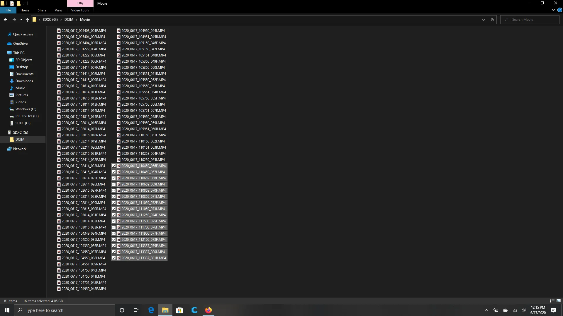

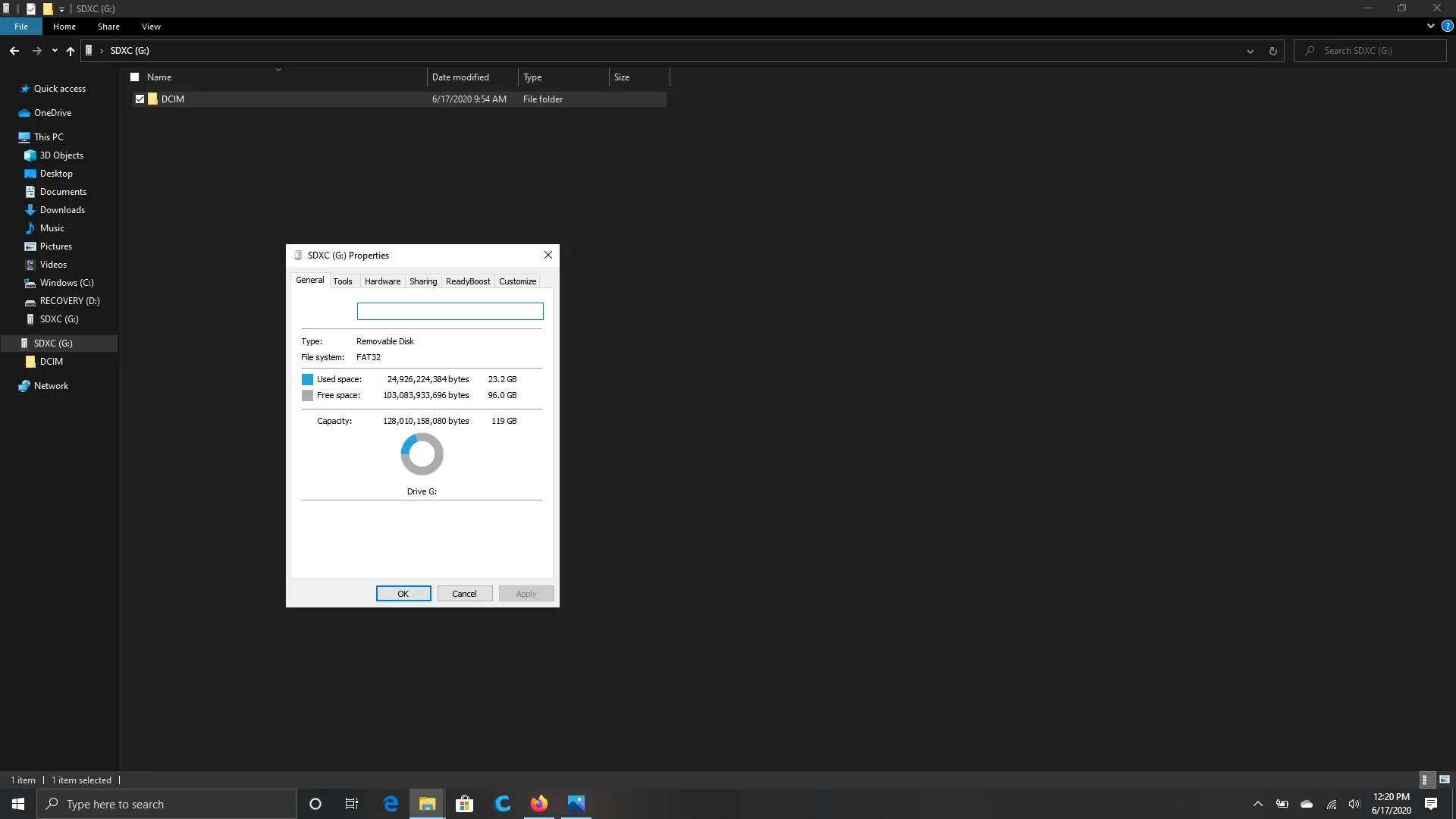

I drove to the grocery store this morning and now reviewing all that footage. I found no corrupted files but Screenshot (4).pngScreenshot (5).pngthe rear camera stopped recording and later on the interior stopped recording as well, leaving the front camera recording only. So no, samsung evo cards are not exempt from the issue. Card was formatted in the camera to FAT32
Surprise surprise...
I drove to the grocery store this morning and now reviewing all that footage. I found no corrupted files but the rear camera stopped recording and later on the interior stopped recording as well, leaving the front camera recording only. So no, samsung evo cards are not exempt from the issue. Card was formatted in the camera to FAT32
I'm going to start driving around more over coming days and watch my setup. Wondering if this could be a firmware or a power issue. I'm hardwired and using a Sandisk High Endurance 256GB. I'll drive over next few days and see if I notice any gaps or inconsistencies.
