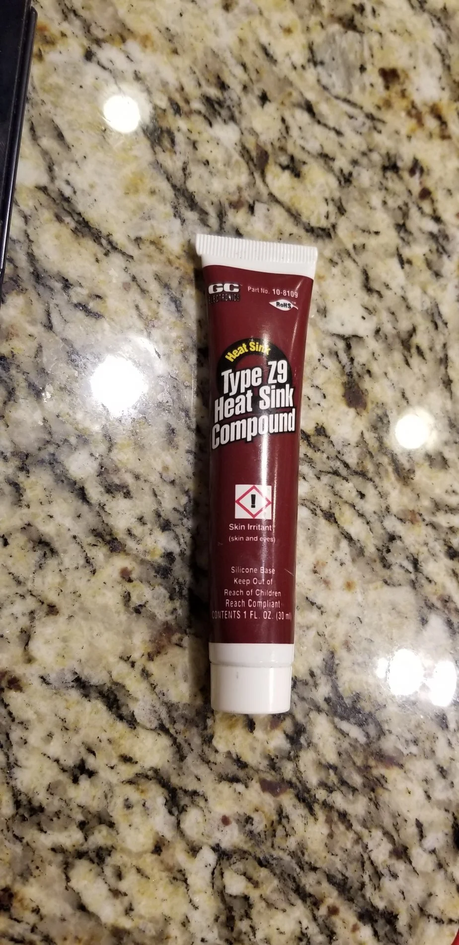

Is using a clean finger to apply the thermal paste ok? I don't have an applicator. I also have a tube I bought a couple of years ago. Don't know how good or bad in quality is but since I already have it20200707_212533.jpg
Use finger in plastic approach, maybe plastic glove from gas station ( some fear gasoline on fingers )
Use old plastic card as spatula to spread it out.
Stick your finger in a plastic baggie if it worries you. I just use my work-toughened finger and wash up afterward. I ain't dead yet!

I used my bare finger and washed it afterwards :D
