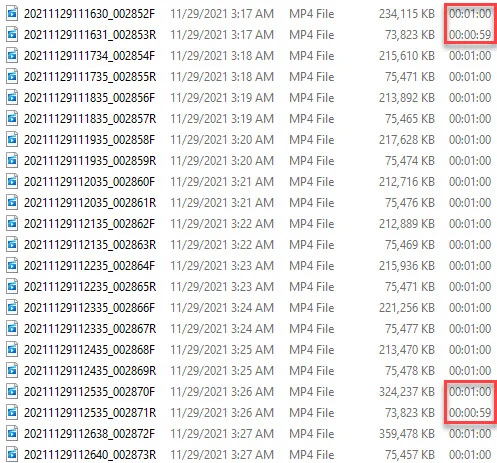

I've been comparing the Zenfox U1 rear video footage with another vendor's rear video camera footage because the other vendor's camera is generating very dark video footage. These ongoing comparisons of video footage had me looking a lot at the video files generated by the Zenfox U1 cameras.
The Zenfox U1 has a 1-minute file rotation time period. I found more than a few examples where I would find the rear dashcam's video footage would be listed at 59 seconds in length. The filenames of the video files also had a longer than one minute gap (front and rear video files). It appears that the video file storage process is getting delayed in storing the video content by 3 to 5 seconds when this occurs. When that delay occurs, there are 3 to 5 seconds of video footage being lost.
In the following examples, you can see that when it's working correctly, the filenames have a 60 second gap (maybe even 61 seconds at rare times). When the problem occurs the filename time gap is 63 to 65 seconds.
I've reported this issue to Zenfox several weeks ago and they are investigating the issue and looking for a fix.

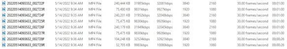

Yesterday, I went on a long drive with my car to a car club gathering where the car would be parked for several hours. I wanted to see if another problem I've observed with longer parking mode sessions would occur or not. The problem being that parking mode starts off just fine (both channels have video recorded) then about 90 minutes to 2 hours into parking mode the rear video channel stops getting video recorded.
Here are the last few normal mode files from the Zenfox U1 as I arrived at the car club event and parked. In fact, these are the last normal mode video files for the entire trip.

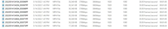

Here are the first few sets of parking mode files.
This file listing is when the rear channel stopped getting video files recorded for it.
The outside temp was 64 F/17 C when I parked the vehicle (after about 2 hours of the U1 recording in normal mode) and by the time I left the event the outside temp was 81 F/27 C.
The front video channel gets video recorded for however long the parking mode remains active. When I start the car and the U1 attempts to transition back to normal mode, the upper left red LED is blinking and it stops recording video for the entire remainder of the car trip.
This is a file listing showing the files at the tail end of the parking mode session. The 34 second video is the last one in parking mode and it should have transitioned to normal mode recording.
