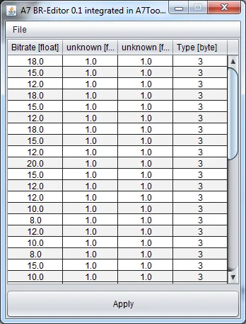

Good job Tobi@s. Can you explain the content of the dialog? Does the first row must be modified to set a new bitrate? How to interpret the other rows?
The first column of all rows has to be edit to make sure you change the correct value.

@Tobi@s, this is how it looks for G90 L7LA30, r125MP. Values for the second and the third column are different. Maybe this will give you a hint.
Hey Tobi@s. Any chance for explaining this Bitrate Array? How to use it? Ex. set to 20Mbits? etc.
Yeah, very easy.
Load an A7 Firmware and Export the sections (Sections > Export)
Then navigate to Tools > Bitrate Editor
PRess "File > Load PRI and select the exported PRI.a7s file
You'll see something like the screenshot above Shows.
Now you Need to edit every value from the first column to fit your Needs (for example Change all values to 20.0 <---yes, use a dot).
Afterwards you press "Apply", Close the window and use Build > Firmware binary to generate an a7firmware.bin
Rename it to Firmware.bin and Flash it from your sdcard.
