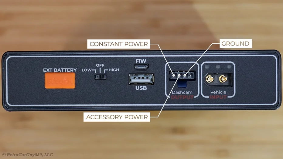

I would test the terminal pins in the "Dashcam" port of the B-124X for power. When the B-124X is on (mode switch in "Cigarette" or "Hardwire" positions), the left most terminal pin in the "Dashcam" connector should have power (11.x up to 14.x volts depending on the B-124X charge level). The second from the left terminal pin should have power only when the input charging power is present (vehicle ignition switch in the ACC/RUN mode). The third from the left terminal pin is the dash camera ground. If there is no power on the left most terminal pin when the B-124X is "on" and the input charging power is off, then there is something wrong with the B-124X.
The dash camera connection port (Dashcam) terminal pins are the same for a variety of EGEN produced dash camera battery packs like the BlackVue B-124X and the BlackboxMyCar PowerCell 8 (next picture).
