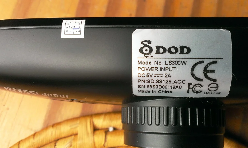

I want to update my cam DOD LS300W to the current firmware version.
many try, it did not work, It is not believed.
please help me
my Firmware is 20130326
i will update to this 20130328
I have the instructions and the firmware from the website Foxoffer.
sorry for my english
regards dirk

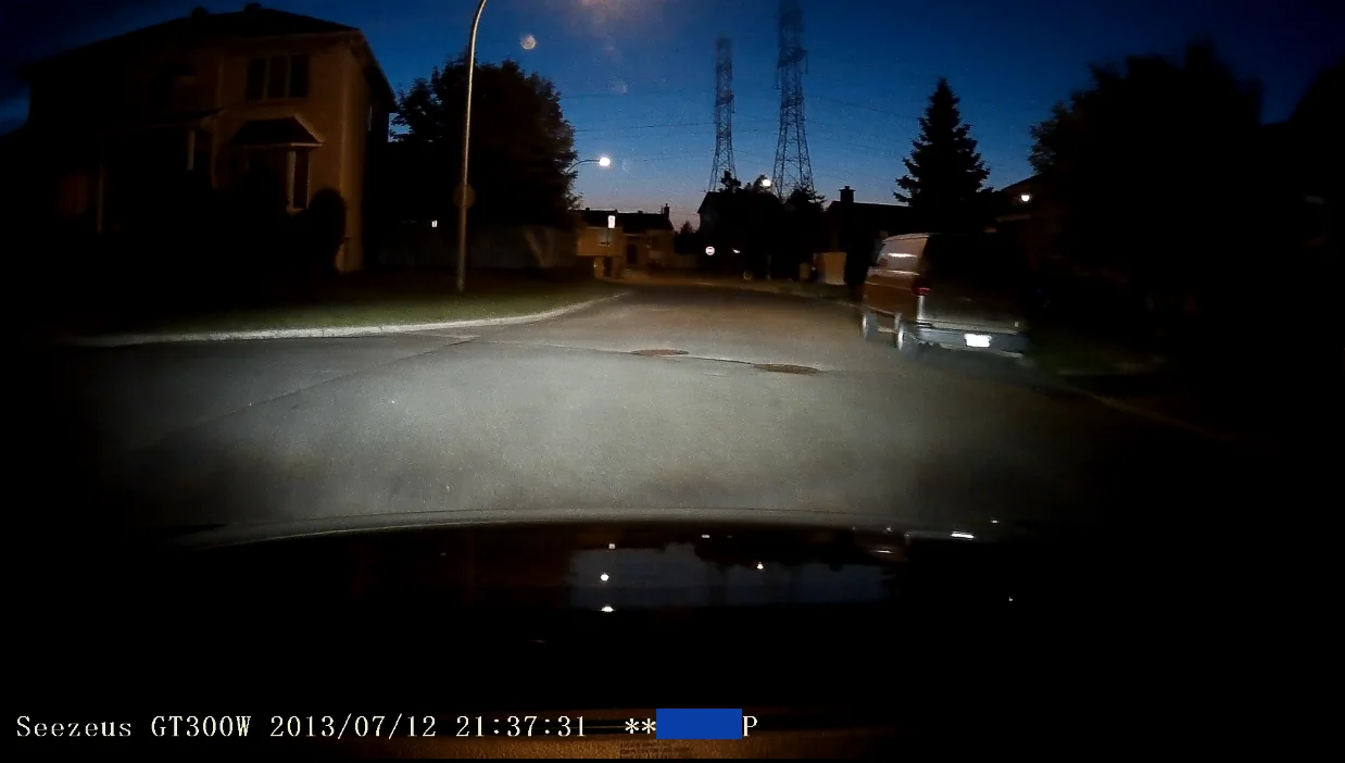

I just updated my GT300W to 201306180-SC-2. I now have LS300W Plus features: AWB, plate stamp and image rotation available.
Don't know if you want to try it on your LS300W?. Technically it should work but of course there are zero guarantees it will.
File is here if you're so inclined: https://www.dropbox.com/s/qxt1w9q8syz2fkb/FWA8S711.bin
