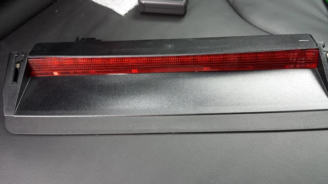

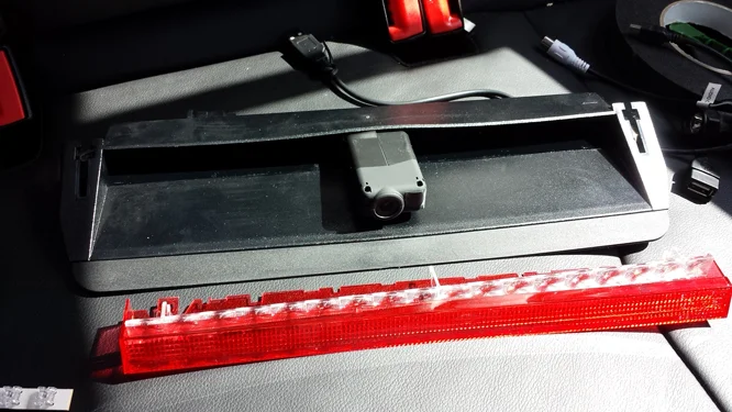

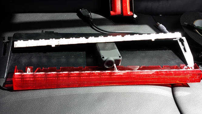

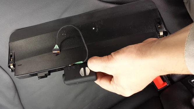

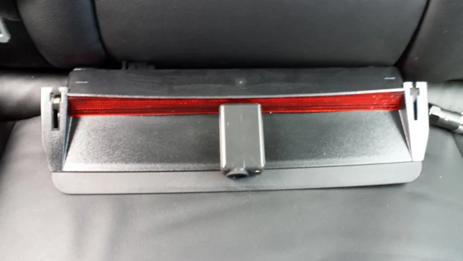

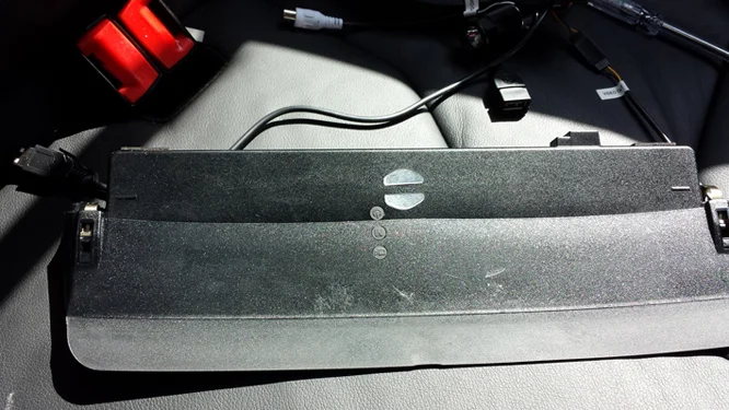

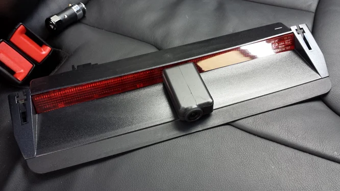

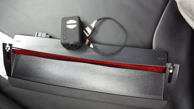

FIRST IDEA, - using special Mobius lens extension cable to built in lens into the centre of rear brake light. Main Mobius body can be left inside car for menu buttons and memory card access.

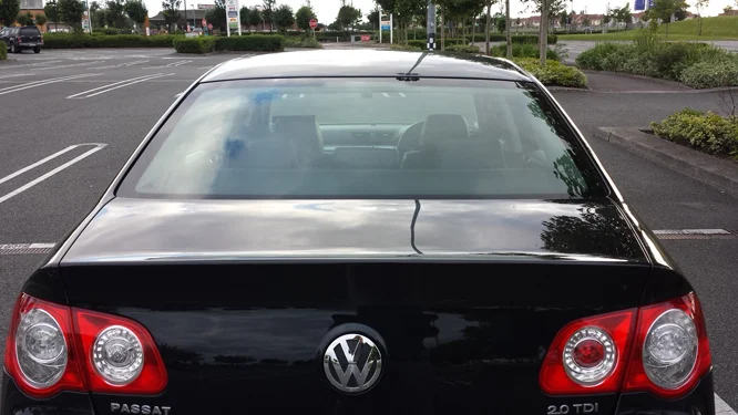

Why into brake light ? - this is most discrete location for camera lens. Also, for cars which have tinted rear windows, they can leave out of tint rear brake light, this way giving clear rear windows view for much better video quality recording. ( brake light can be also tinted for better overall match ).
Below I did some "photoshop", just to show how the effect would look like. I did not had much time to do full project, so just wanted to share my ideas with others, who might find this idea useful and have time to implement this idea.
Also as above mentioned ( for cars with rear windows tinted), red brake light can be slightly tinted to match overall rear windows tint-look.

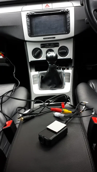

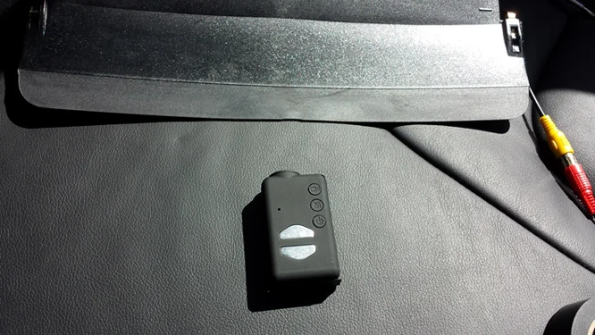

Here I am using extension AV cable connected to my car multimedia to aim Mobius camera angle.
Reactions: Mtz
SECOND IDEA:

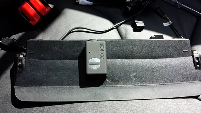

for people who do not want mess around with lens extension cables, - to built in Mobius whole unit into the rear centre brake light.
There will be few opsticals. One of them is LED lights strip. So depends on size and configurations everyone has to see how it can be done.
Mobius will be fully behind rear brake light red transparent cover, - only lens will be sticking out ( drill hole through red brake light for Mobius lens )

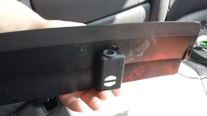

Below is "photoshop", cut wholes in the rear brake light holder for Mobius heat sink and access to menu buttons.

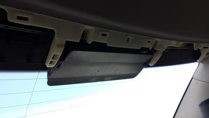

THIRD IDEA is to built-in / install whole Mobius unit behind rear centre brake light.
Challenge will be to run power cable through red brake plastic glass and also access to memory card.

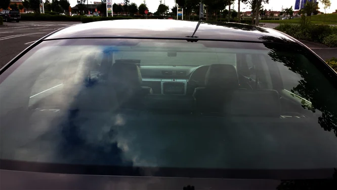

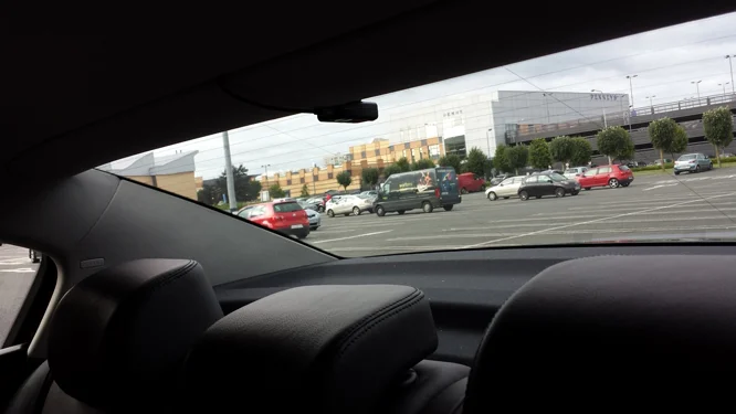

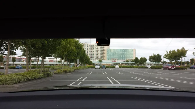

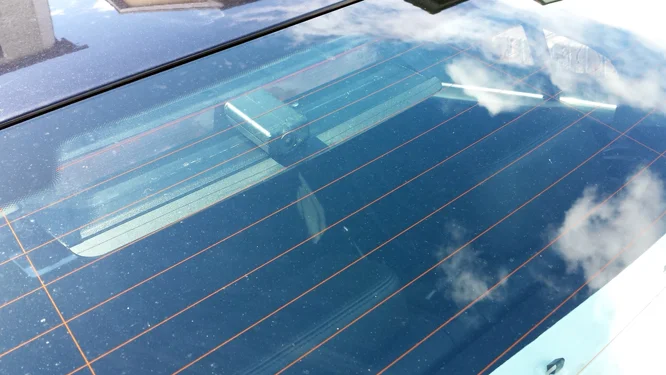

FORTH idea is most easiest. Use 3M ( double-side tape ) to mount Mobius at the rear centre of windows. Run power cable under ceiling liner to closest power source ( hard-wire to interior rear side reading lights )
The only draw-back with this installation is if your car has tinted rear windows. This will reduce a video quality of dash camera. Therefore you might consider DIY built-in camera into rear centre brake light ( above ideas )
Below you can see RED LED light on the Mobius that can be seen from rear-view mirror to check status of the camera.

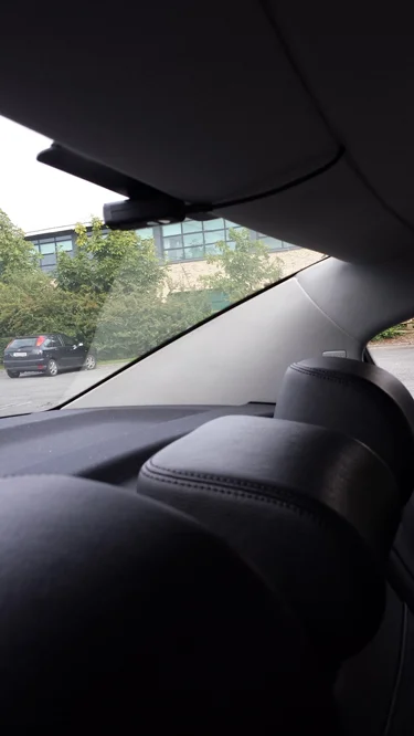

You inspired me to investigate using my rear brake light as a possible location. I have a convertible so it's slightly more challenging. (smart car showing in my profile photo) I rarely drive with the back fully collapsed, there is less wind with just the roof open.
I think I'm better off fixing the camera to my rear hard glass window pain. There is already a support wire for power I can follow up to the glass exactly where my camera should probably go. (see lower left first part of video) It was worth entertaining the idea though for, I opened the brake light up and don't have as much room as you do anway.

I've decided the only practical place is inside, on the lower right side of the rear window. (lower left if looking at my video)

Here is video from Mobius mounted at the back, top centre of rear windows ( check my photos posted before ) just under the brake light, there for you do not see rear window heating elements like you might see on most other 2ch dash cameras.
Select 1080p video quality.
