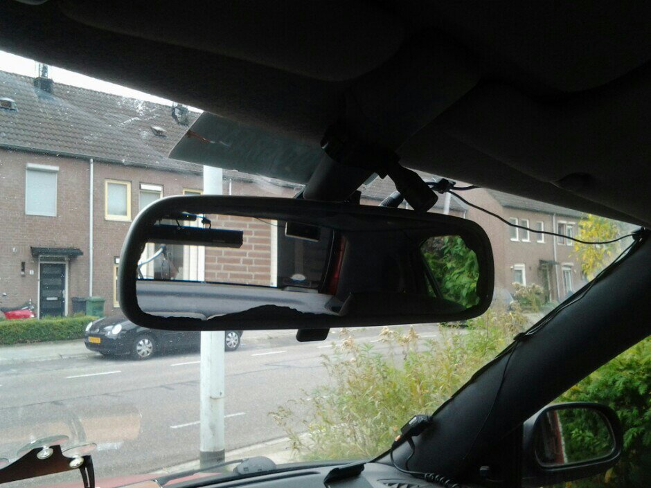

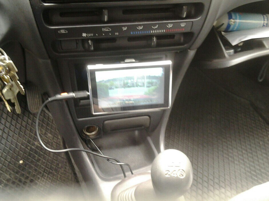

I have mounted the camera (GS1000) behind the rearview mirror. The only problem is that the camera is black and the mirror is light gray: it is very easy to see the camera. Bad image quality, sorry...
When I'm sitting on the driver's seat I can't see the camera. It is also quite difficult to use the camera if you have to change settings etc. Luckily, the red led indicator light reflects from the windshield that I can see the camera is recording.
Try to move the camera in the most upper position.Will be nice if the right part of the camera to enter under the arm of the mirror, on the upside part of it. In your last picture, to move it up and then to the left.
On your last picture I see something black on the roof. Can't you attach the camera from there so your dashcam will be over the mirror?
Look at the picture number 4 from my third post. On the left of the camera you will see a black round object. It was gray but painted with a black matte spray, after unmounting it from the windshield. On the right of the camera you can see the mirror which was also gray but covered with some black tape (to not paint it) and which can be removed easy. You can use a hair dryer to extend the tape over the mirror curves.

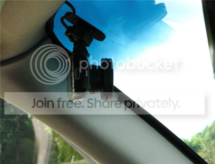

For my Minivan, I mounted my FineVu on the dash. I have side curtain airbags, so I could not run the wires through either of the front pillars.
My older Camry has no side curtain airbags, so I could run the wires through the right pillar and mount my second FineVu just right of my rear mirror.
I have noticed the reduction of glare from my dash mounted camera compared to my window mounted camera. I have also noticed I get a better image at night with better resolution of signs and license plates.

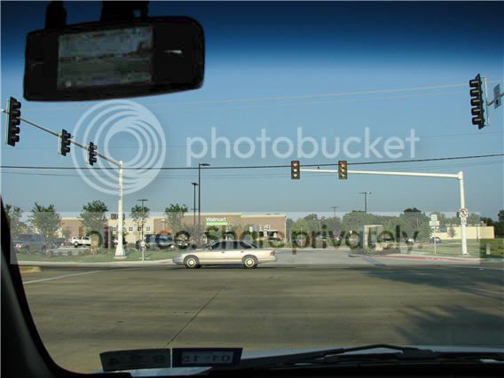

i1000 / F70 / X6 720P Dual Lens DVR Dash Camera
This is how I mounted mine
Front:
Driver/passenger view:
Wires for power and rear camera are hidden in roof lining and A-pillar

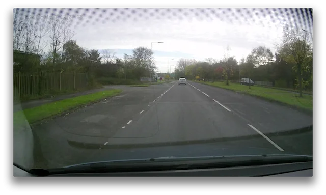

This where and how I mounted my ITB 100HD in a RH drive Subaru Forester.
Note: All of the following pictures were taken with my Samsung Galaxy GT-i9000 Mobile Phone.
Head on views (2):
DIY Mounting:

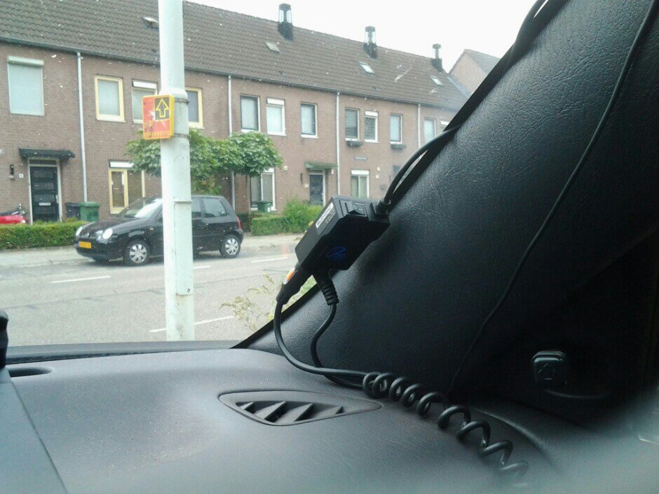

This is looking upwards from beneath the Dash Cam.
Sunglasses cubby removed and cable routed behind roof lining in the direction of the arrow.
I used a straightened wire coat hangar to pull the cable through this section of the roof lining.
Once I had made the decision on where I wanted to run the cable it took me about 30 mins and the job was done.
Next step is to get an auto electrician to wire up the UPC for me as I'm not happy with the connection shown in step
#4 of the manufacturers guide.
I ran the cable in behind the piece of grey trim on the right of the red line, there is no need to remove the trim either.
I just pushed the cable into this crevice using a blunt item.

Nice work and nice photos you've put together to explain the process, I need something like that in my user manuals
Your shot with the blutack is a good reminder why best practice is to run cables across the passenger side
I take your point with the Blu-Tac and the cable falling down onto your feet, I have some 3M cable clips that came with the camera and I will be replacing the Blu-Tac with them tomorrow, it was only a temporary setup to see if I had enough cable.
If you want to use my pics for your user manual go ahead, if you would like the originals PM me your email address and I'll send them to you.
