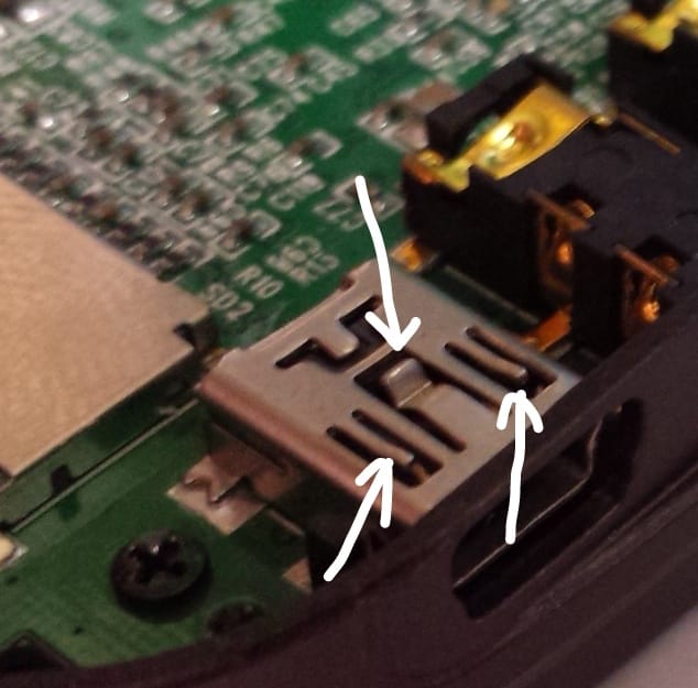

Loose USB Plug
Numerous owners of the G1W have indicated that the mini-usb plug is loose.  To fix this problem, owners have used mini needle nose pliers to very slightly pry the male mini-usb tip outer casing.  Others have adjusted the holding pins slightly to ensure a tight connection with the USB cable.  Complaints regarding the overall quality of the USB cable have been made by numerous owners as well.

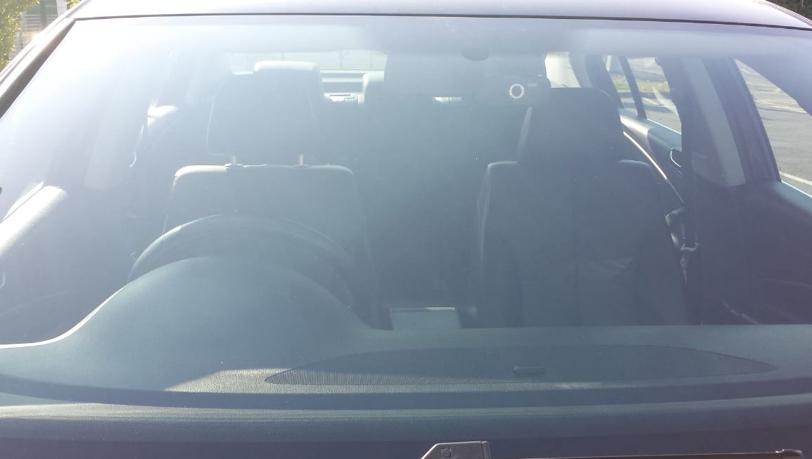

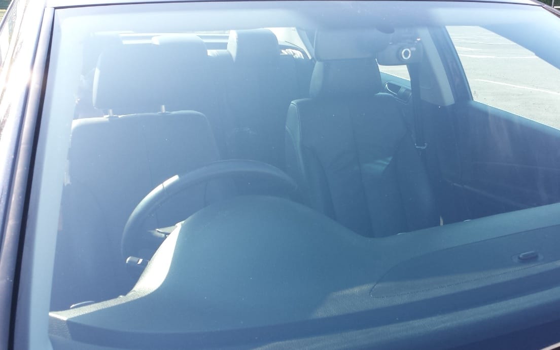

Mounting the Camera
G1W Mounted 2
G1W Mounted

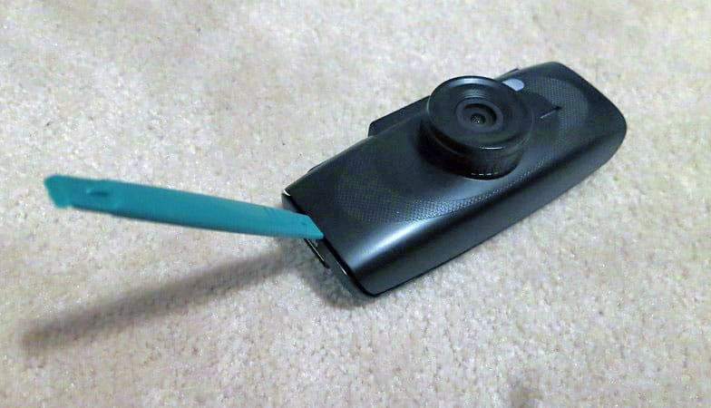

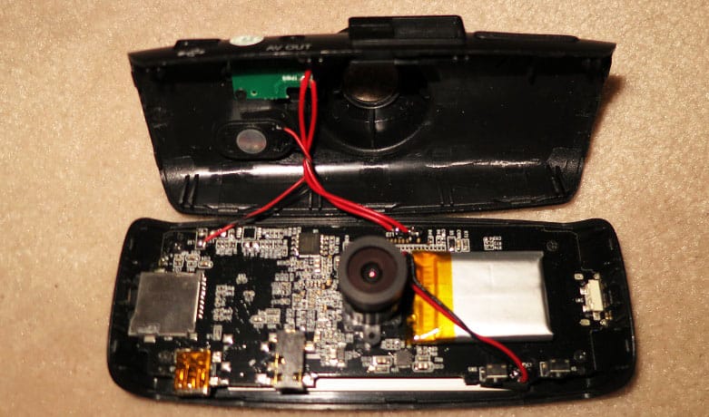

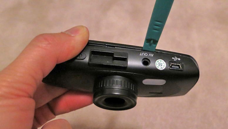

Disassembling the Camera
G1W Open1
G1W Open2
G1W Open3
G1W Open4
G1W Open5
G1W Open6
G1W Disassembled 2
