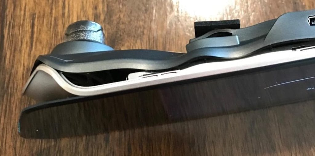

Heat Damage
Numerous owners indicate that the CE35 gets damaged with the heat. The warping of the camera would indicate low quality plastic materials were used. Note that the Toguard CE41 and Toguard CE18 suffer from the same problem, a common theme for these cameras.
