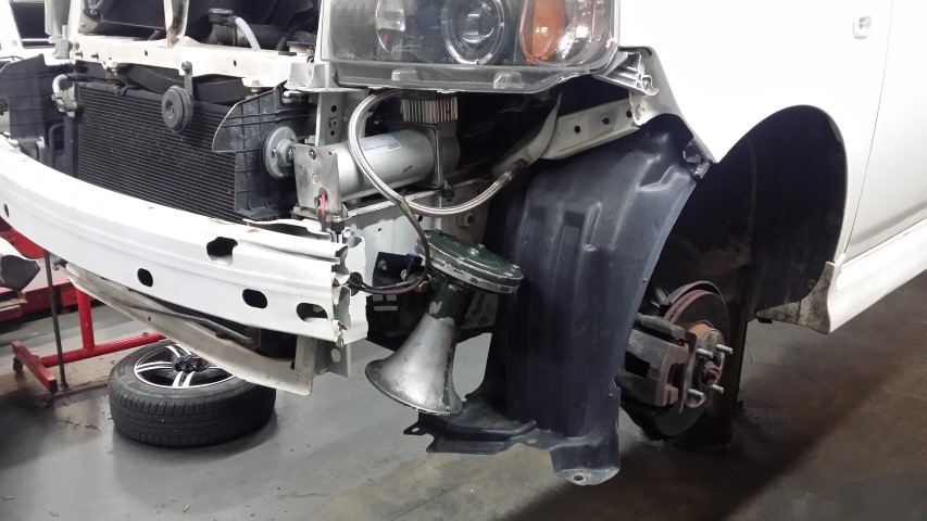

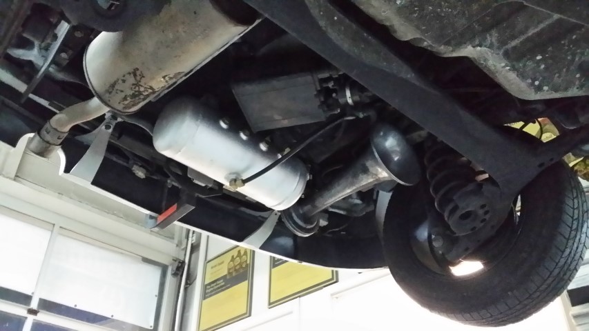

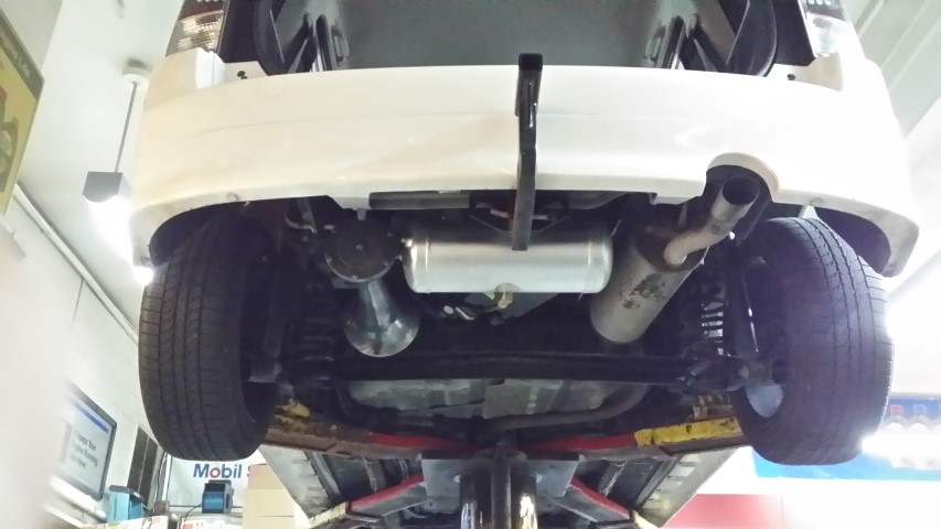

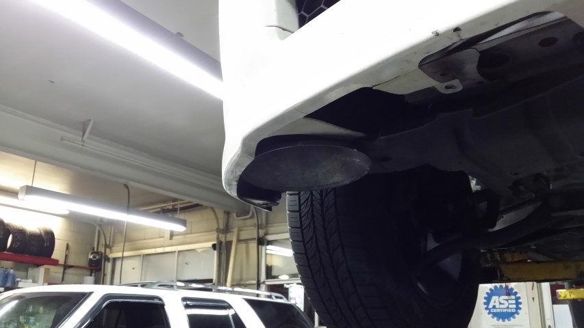

Depends on the vehicle, but you'd be surprised how well a large horn can be hidden.
Here's the setup on my daily beater (2016 Sienna)
Nathan Airchime K3HA Horns (individual manifolds)
200psi Air Compressor
2 Gallon Slimline Air Tank
1 Gallon Slimline Air Tank
Horns are hidden within the bumper cover, compressor mounted behind the grill for ample cooling and the tanks are tucked well above the exhaust line.

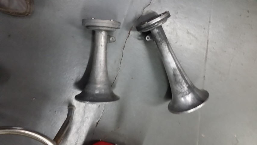

I am thinking train horn, with heavy duty diaphragm, and then hit it with all of the 300 BAR in my dive tank i normally use to fill the air rifle. :eek:
They'll get blown out
Here's an old set with just 80psi
Yeah i figured, at least if it was anything normal, Of course something more rigid and you would probably end up with a very high pitch whine.

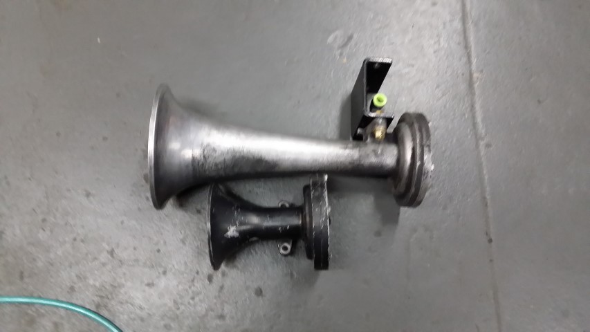

Did some testing with some cheap (yet very loud) WalMart horns and removed the trumpets
Got a nice ear piercing squeal lol

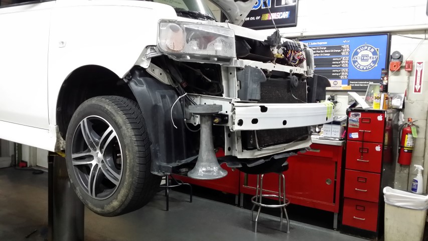

On my XB
